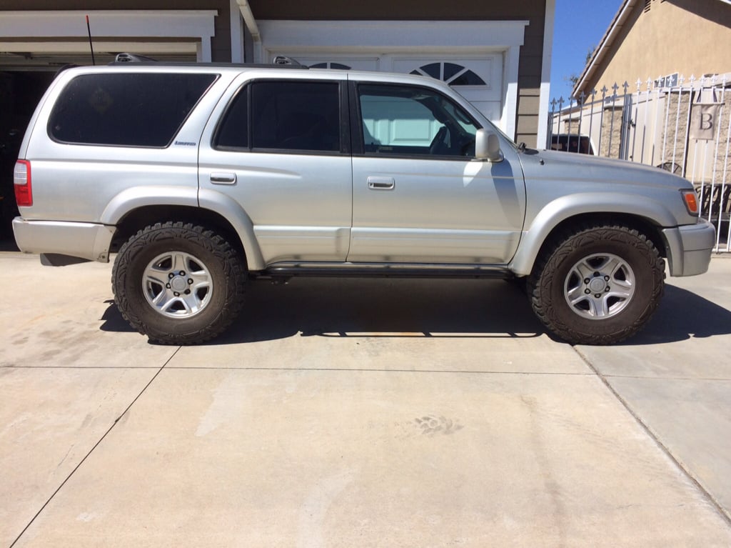

What??? 35's on stock suspension?
Mark_BC
Senior Member
Is this guy Josh'n us????
https://vancouver.craigslist.ca/van/cto/d/1998-toyota-4runner/6254749188.html
If you actually make 35’s fit properly, you won’t need a lift. Clearancing is key.
Does the back tire have an easier time clearing because it doesn't steer? If you have to do the most mods to the front wheel well and fender then I could get another front fender and modify that. The rear I would be hesitant to bash up because it's part of the whole truck body.
Plus a body lift?
Plus a body lift?
Yes....there's no scrub radius to deal with. It's not so much the fender but the floor pan/kick plate area that needs work up front.
I've seen this truck around town a few times. With the stock bumpers removed, a firewall tub and extended bump stops in the rear, I can see it working pretty well. My main concern would be having enough up travel in the rear though.
That front wheel looks pushed forward to me?
(also; gearing?)
Probably just maxed caster. The back of the flares being trimmed might be adding to the illusion too.
Stock gears with 35's are just fine, honestly.
Lift height really doesn't do much for making room for big tires- unless you're doing a 3" body lift and 6" drop bracket lift [emoji23]
That's for sharing. I love stock height on 35's [emoji41]
I would LOVE to do 37s at stock height. :(
That still looks a little taller than stock height. Maybe some fresh ‘99 tall coils? Looks quite a bit taller than my stock suspension when I had 33’s.
