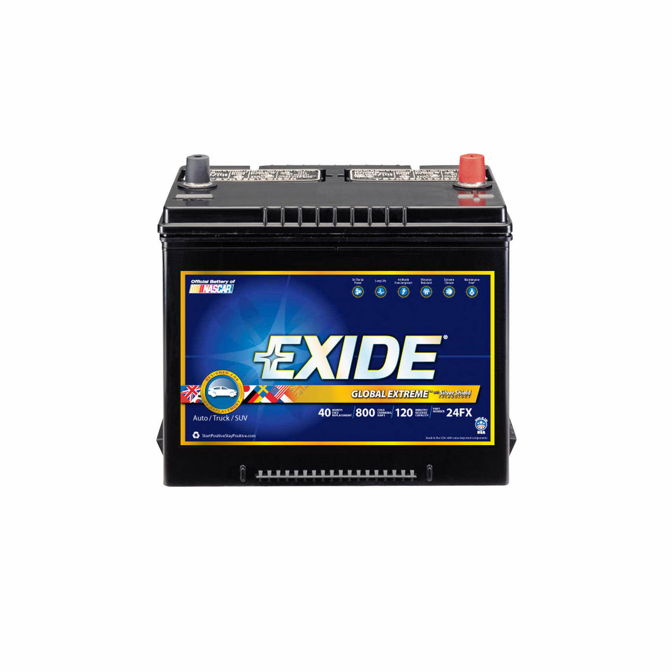

My Exide Classic crapped out a few weeks ago. Now I'm running this bad ass 24FX - 800 cca 120min RC
