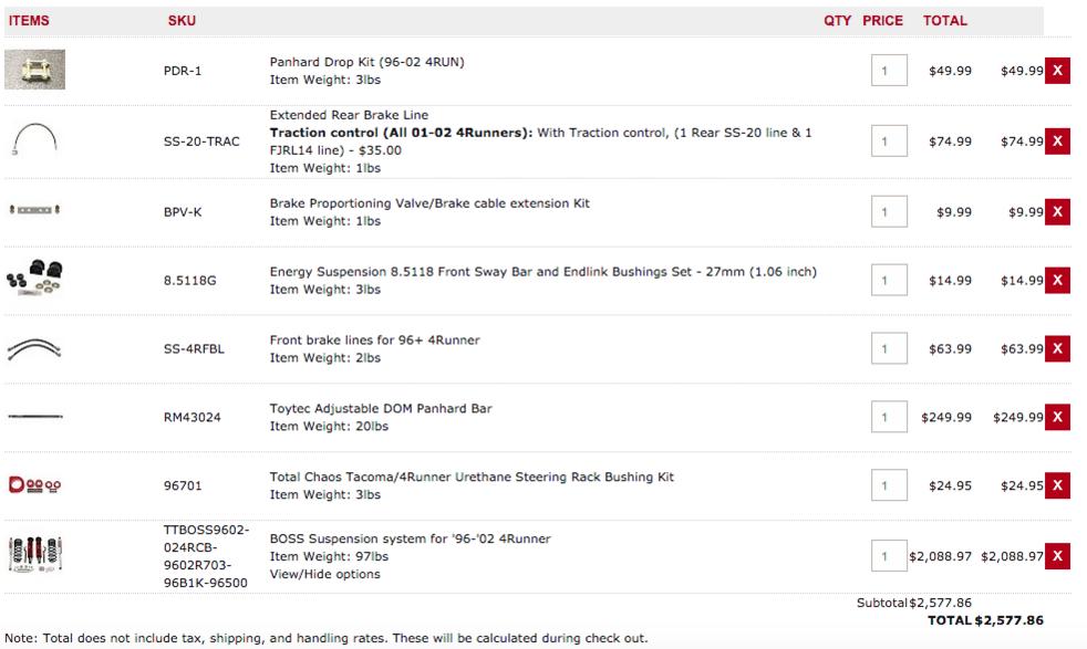

About to drop a coin to overhaul my suspension. I've been researching for about 6 months - and it seems this is the setup I want/need.
What other items / expenses am I missing in this list?

control arm bushings. I didn't even know what these things are! could have saved a bunch of dough doing it myself while I had it all apart! alignment shop caught it.
you have one extra item
You don't need both the panhard drop bracket and the adjustable panhard bar. The bracket is for folks that don't want to spend $200 more for the fully adjustable bar. Using both at once is not better. Save yourself $50 and skip the bracket.
As OkiSurf1996 mentioned though, you might want to add a drop kit for the front differential (at Toytec it's part TAC-DR).
Make sure you need 27mm front sway bar bushings. I ordered some and they are too large, needed 26mm for my front. Not sure why so many different sizes of front sway bar bushings. Usually calls for 27mm on most sites but dont fit for me.
