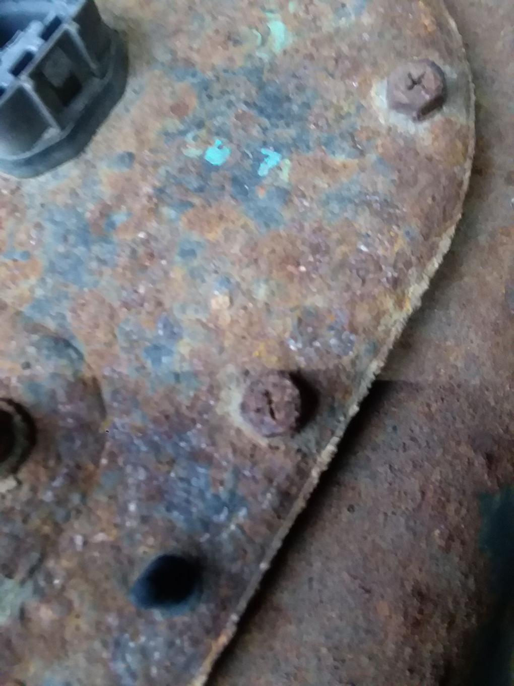

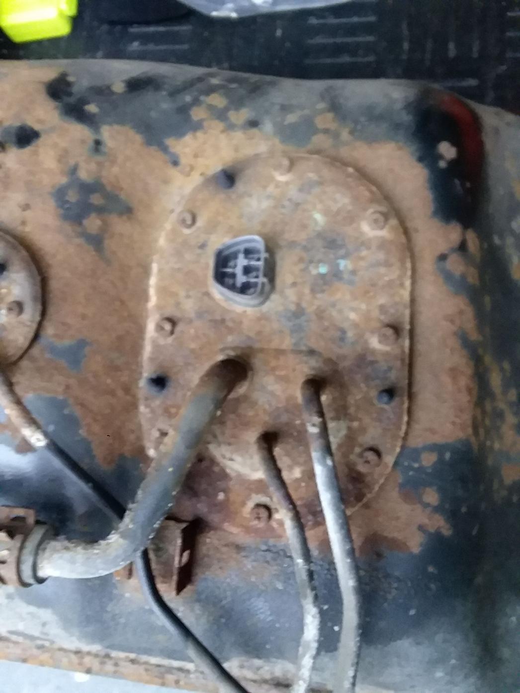

So I'm attempting to replace the fuel pump and cringed when I saw this.
I am soaking them in Kroil but I have a bad feeling they will snap.
What do you guys think?
Am i screwed?

Hit 'em with a torch.
:flame:
maybe not a torch. but soak in penetrating oil and hit with an electric heat gun, some of those reach near 1200*
you might be better off than you think
Also don't those go thru a rubber gasket, the threads may not be screwed, just the heads.
But I'm from California, all mine was covered in was dust..
either way good luck.

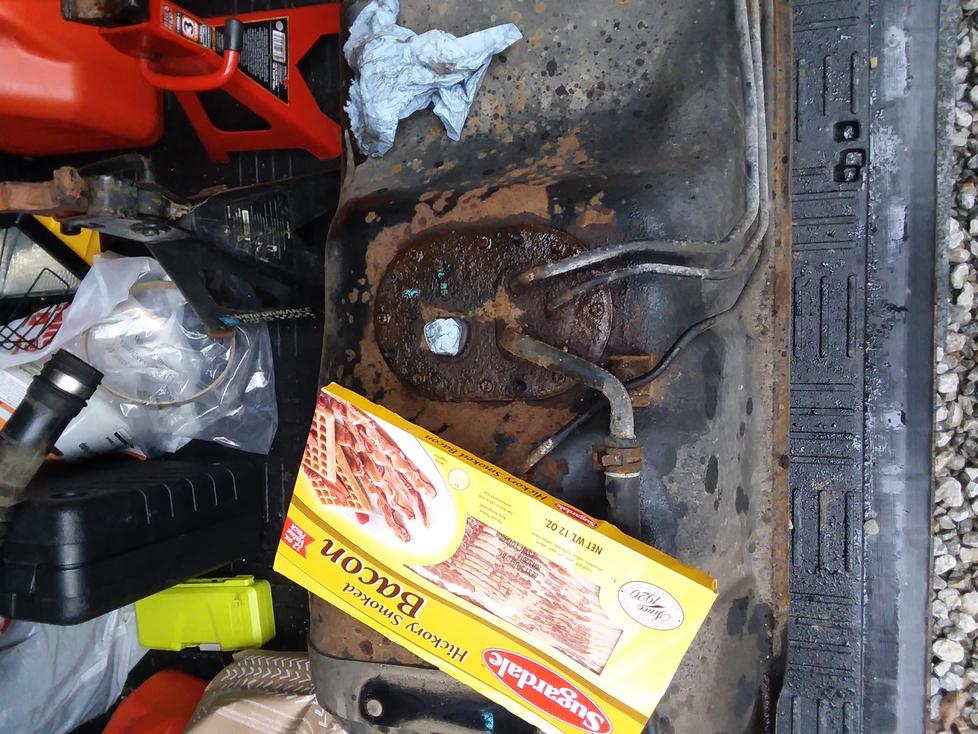

BACON GREASE FTW!!!!!
Clearly bacon is the only verifiable solution here
not sure if just bacon will be enough on this one, an entire side of pork might be the only hope.

Soak with kroil or pb-blaster. A lot. You probably have one chance to back out each screw before the head strips. Make the first try count- be patient with the kroil. It helps to gently tap the screws and plate with a small hammer to encourage kroil to penetrate into the threads.
Well patience is the number one trick in getting out rusty bolts so i am spraying, banging, wire-brushing for a day before attempting.

I would not put that 1/2" impact on those.
I think guys are talking about a hand held one you hit with a hammer.
please don't use an air impact on those. you will break them.
https://www.amazon.com/TEKTON-2910-2-Inch-Manual-7-Piece/dp/B000NPUJYE
Have you ever used a variable speed air impact? You can slow them down quite easily to where you could do one strike with a light tug. I'd argue that it would be better to operate with a smaller rotational force strike than a larger, potentially unwieldy one (user error)
Put the appropriate sized box end wrench on them. Keep pressure on the wrench and tap (meaning don't sledge hammer) the end of the wrench with a hammer. The shock load will sometimes break them free. Whatever you do don't try to use a impact because that might break the bolt heads off.
those are essentially screws, not really bolts. they probably have a torque value well below the lowest setting of any impact gun. maybe even in inch lbs.
and yes I've used an impact gun many times.
The post above has a great idea. put a box wrench on them, put slight pressure to remove it, while tapping straight down on the head.
