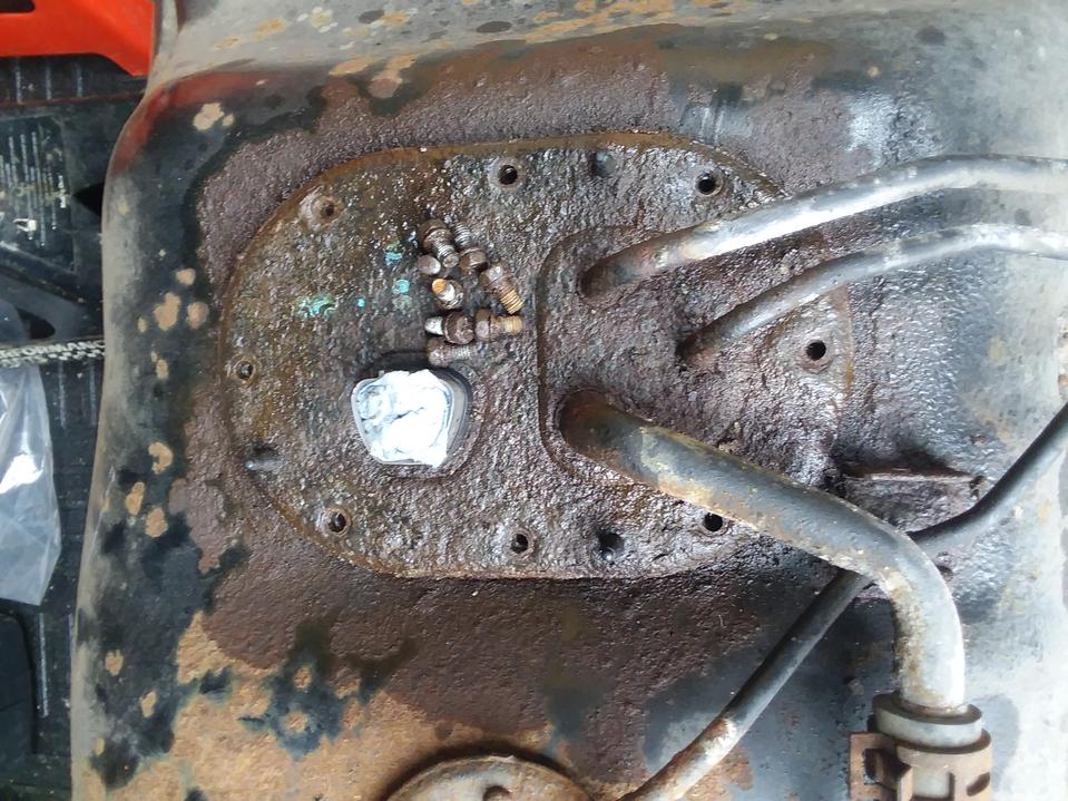

Anyone know the size of these bolts? They seem solid but heads are a little smooth.

I am kinda disappointed in my torque wrench. I did not realize the lowest setting is 120 inch lbs so I had to use my guess-a-matic torque wrench and snugged em to what I think was somewhere between 30-50 ft lbs.
Everything went back together like butter and truck starts right up. I got some spare time so I am undercoating the truck with Fluid Film.
So for anyone who is struggling with rusty bolts I highly recommend Kroil and Bacon.

Good to hear it went back smooth, did you find replacement hardware or clean and reuse the old stuff?
they are weird little bolts
it's been a while but I think they a M4 x 1.0 and only like 10mm long. I grabbed some from home depot and they worked fine.
the ones I used did not have the jis head just normal bolts.
