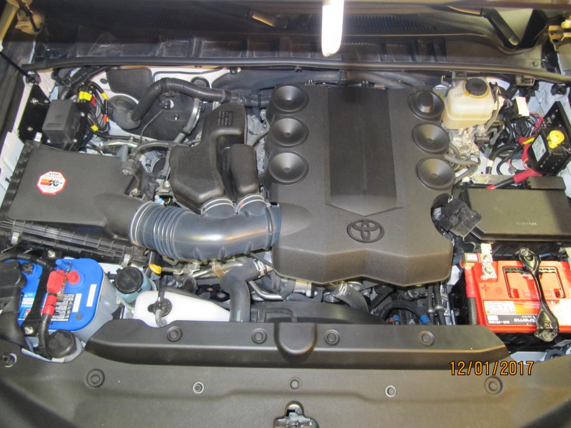

Otima & Odyssey One of each
The Otima fits the shrockworks tray
The Odyssey fits the OEM Tray with the bottom adapter ( order the adapter with the Battery its like 5 bucks). Takes 5 mins. to install.
One and Done.
