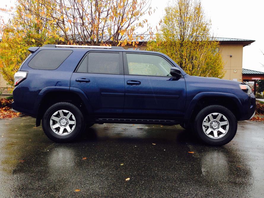

If I ever had a do over. Gunmetal wheels on nautical blue metallic is the way I would want it. That blue is my favorite color, but couldn't justify a financial hit in trading for a paint color lol. Nice truck man. I know :offtopic:
Thank you! I specifically went with out the premium package because they didn't have one in that color on the lot. Sacrifices, sacrifices, lol.

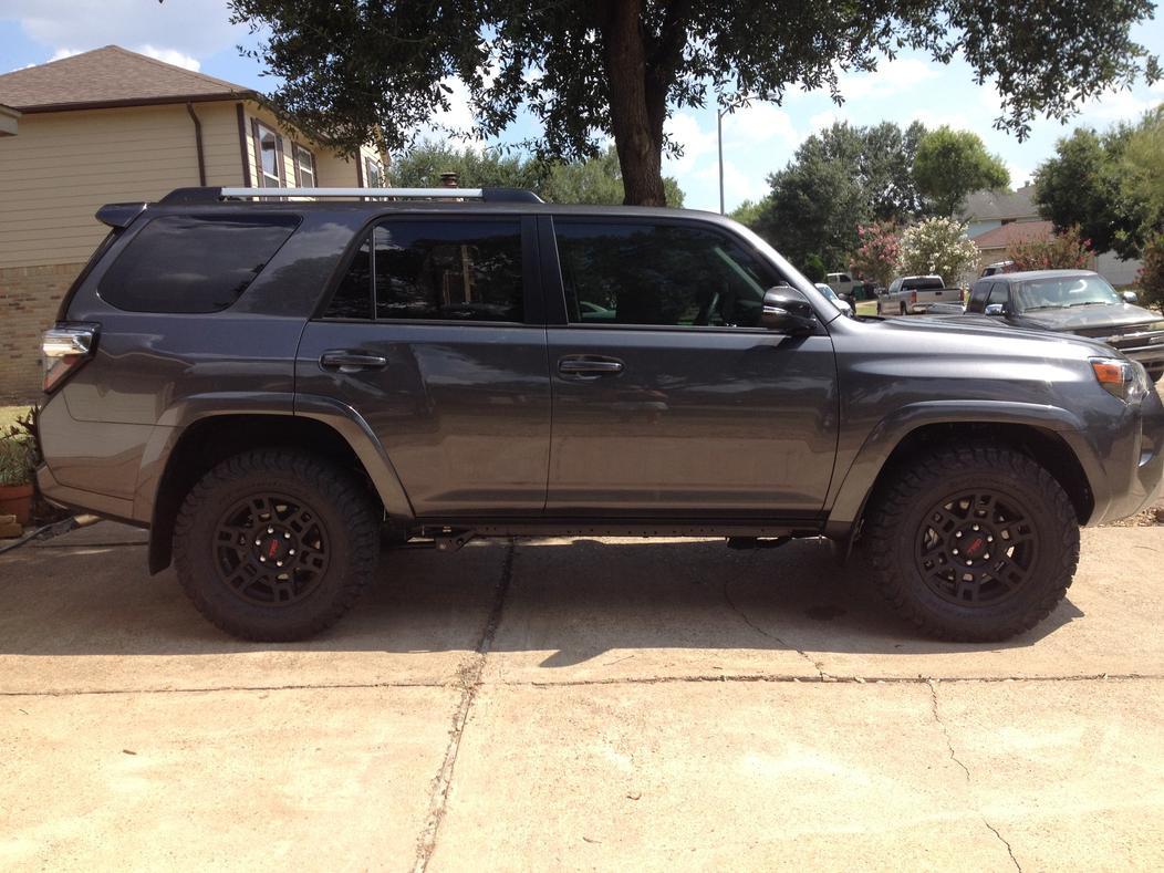

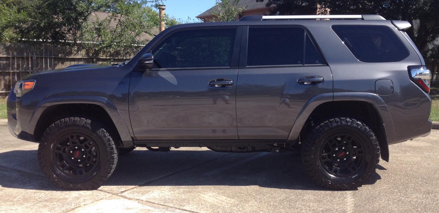

How do you like your setup warpath? Looks awesome is that just a 2.5 inch front setup. What size tires? Post another pic please !!
I like it very much! Sent you a PM too. The tires are 275/70/r17s, Goodyear MT/Rs. Just slightly bigger than stock. Surprisingly they rub little. I don't know how some guys on here run the 285s on a stock set up!

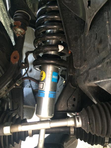

So side note. When I asked 4 Wheel Parts to install them, I actually only asked them to set them at the 1.75" height to level out the rake. When I measured I got 2.5" I figured they just set it at that height so that it would be "level" like I requested. But I looked and it looks like they are not even at the maximum height and possibly could go higher! I wouldn't think there would be any "settling" period because it is just the shocks and not springs. Am I wrong? Or do I get more lift because the trail edition sits higher to begin with from the factory? I'll try to get a picture of what I am talking about.
Got a picture. So it looks like there is a ring above and below the cup the spring sits on, indicating it could go higher? How did I end up with 2.5" if it is the center ring? Isn't that supposed to be 1.75"?
