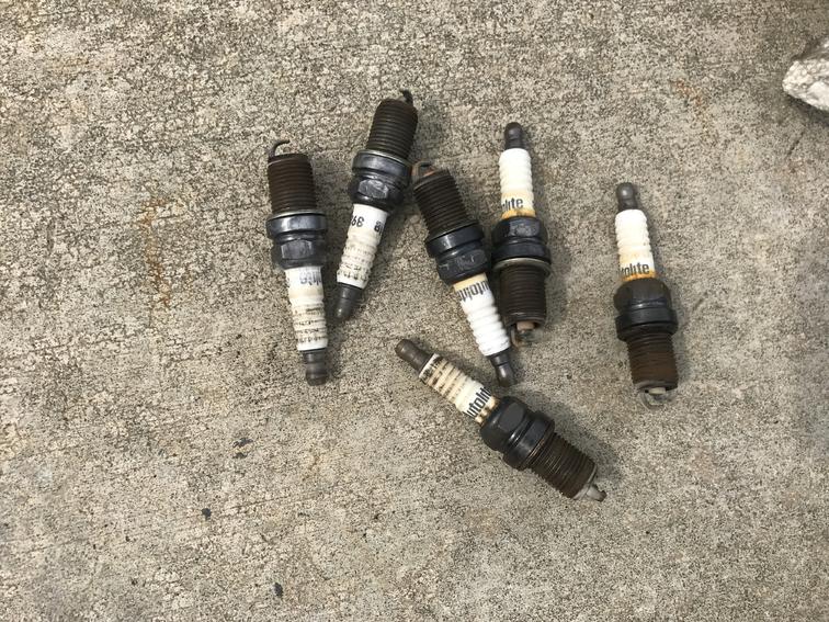

Changed the plugs, wires, and igniters! They really needed it. Replaced the Autolite ones in there with the proper NGK plugs. I can feel the difference already, the old plugs were toast!

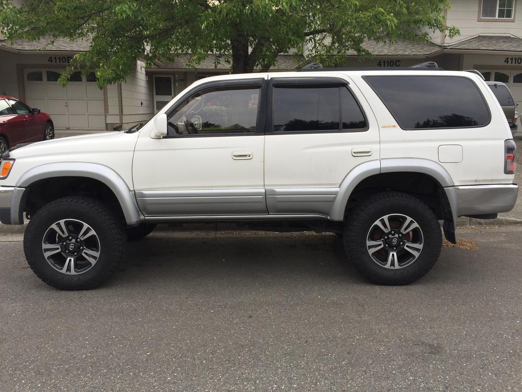

Finally got around to installing my 1.5" body lift. 6hr job start to finish with help from a fellow 4runner (he's a 4th gen owner) fanatic.
Next up, deal with the new gap between body and front bumper.
