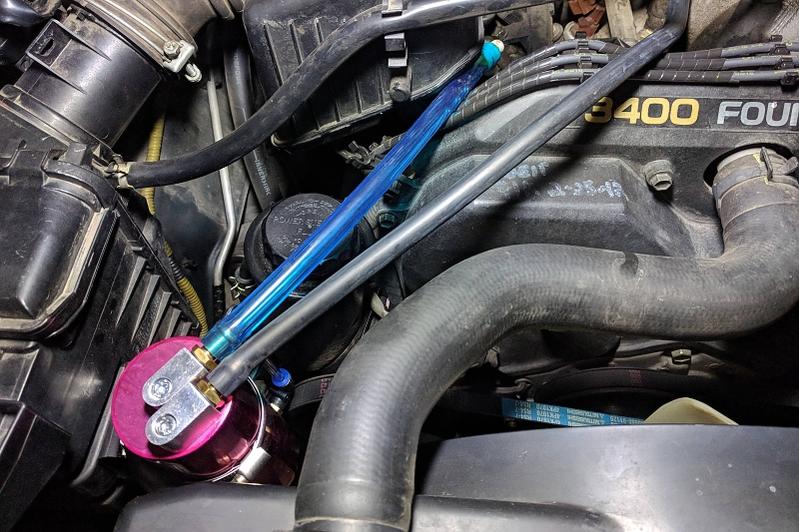

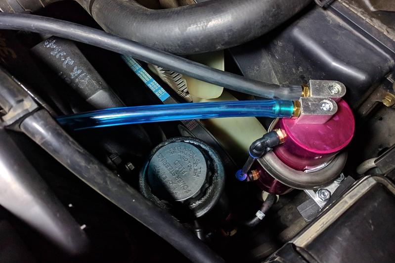

I hunted around for a spot to mount it, and settled on the side of the air filter box. Drilled two holes and positioned the catch can to be a little lower than the PCV valve, so any oil would run downhill to be captured. To keep the oil can from rattling in its bracket, I threaded a section of old bicycle innertube around the bracket and tighted it up.
Drove it 5 miles today, and the 4Runner didn't catch fire -- so I think I'm good to go.

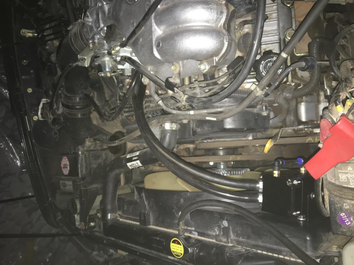

Just some experience from my oil catch can.
1. It works! I drain mine every oil change. Not usually much in there. Maybe an ounce or two. But to think that would be entering the TB without it.
2. The tube on the side that is suppose to show you the "level" may leak, a lot. I found mine to be leaking, dripping a little oil, but mostly spraying it all over the area I have mine mounted. I'd suggest plugging them, but maybe yours in built better than mine.

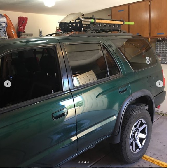

Re installed my stock roof rack cross bars then mounted my basket to that. Working on a set up to mount a canoe to. Going to send the basket off to powder coat soon.
