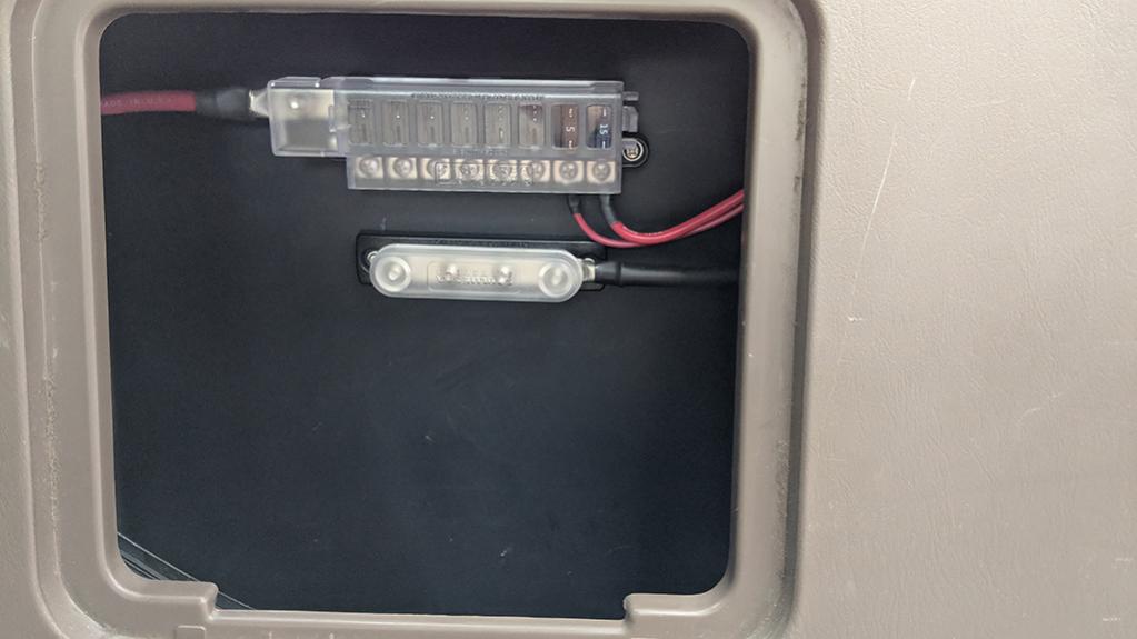

Finished up laying sound deadening in the cargo area and the wiring for the rear for now.

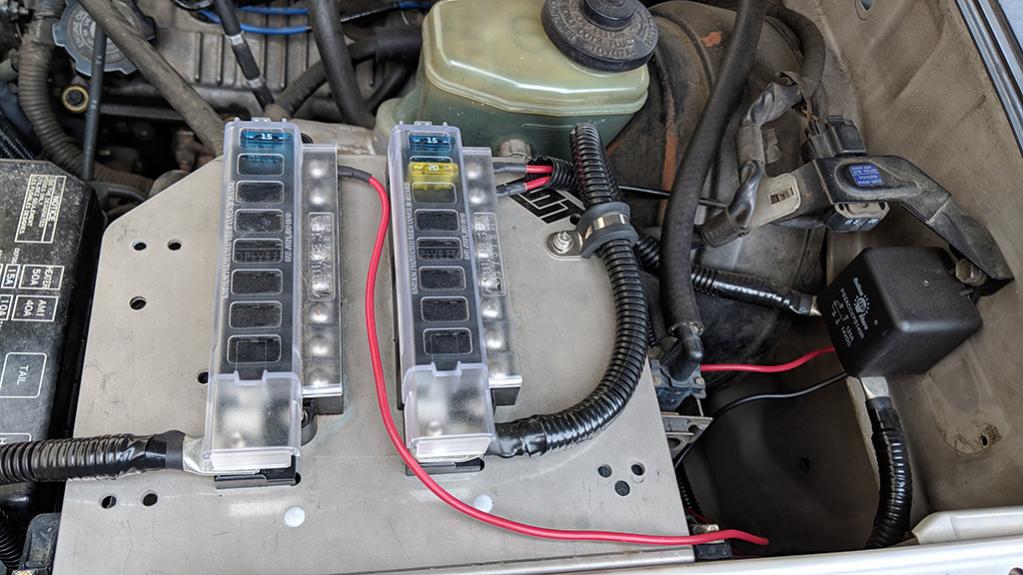

Engine Bay Lighting
I adhered the 3' LED strip to the underside of the hood. Now to decide if I use the illuminating switch which I already have, or buy a pin switch so the lights automatically turn on/off
Pin switch is much less wiring, but I have to buy it.
Illuminating switch is 3 prong, but I have it.
I also really need a fuse box in a bad way. my positive terminal is getting crowded. and my one grounding bolt is getting full: Big 3, projectors, and horns.
This is perfect timing, I am right in the midst of pondering underhood lighting. What LED did you use?
My thinking is that I want a manual on/off switch for two reasons - a) I would not have to worry if the lights stayed on after closing the hood (the refrigerator light syndrome), and b) I will only want the light to come on when I need it, not every time I open the hood.
For the manual switch, you only need to use two wires to make it work - hot and ground. The third is only needed if you want the switch to be illuminated.

See im leaning against the manual switch for one big reason: If I forget to turn the LED off, then its on until I remember to turn it off. I know its not much power drain, but still. the benefit of the illuminating manual switch is a big red LED telling you the light is still on.
I just read your thread! and I like the idea of keeping the OEM wiring separate from the aftermarket stuff. The Blue Sea fuse box is nice, I really don't know what else I will be adding, that's the big problem. I do see a winch in my future, but that will have its own dedicated wiring system.
