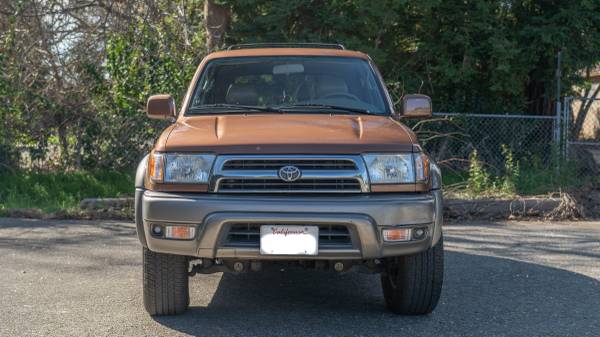

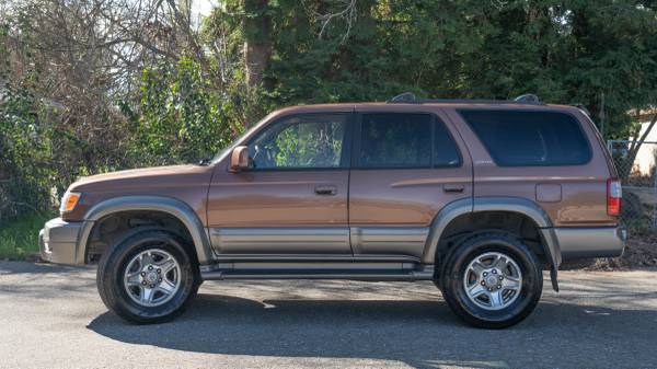

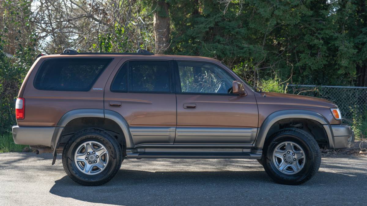

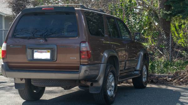

Aquired our third 3rd gen. Found an Autumn Blaze limited with elocker locally!

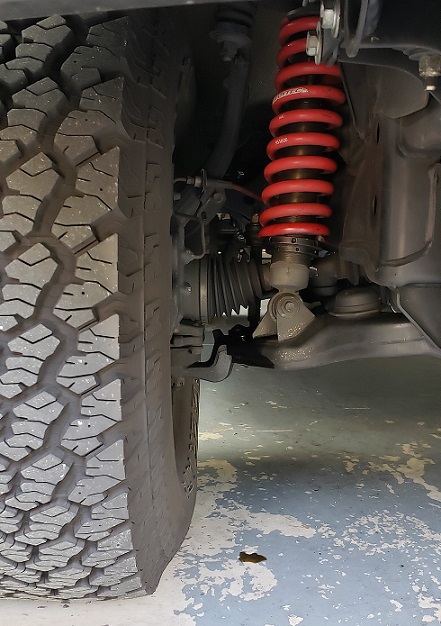

Noticed my passenger side Toytec Boss coilover leaking over the weekend. I didn't see an active leak on my driver side but it looked like it had probably leaked at some point since my last oil change. I have about 80k on them. I was initially considering the Tundra Bilstein 6112 or Tundra TRD/Bilstein 5100 but recently saw that Toytec started offering their 5100/eibach Ultimate coilovers with the threaded shock body again. I may go that route since the threaded shock body will make them much easier to adjust.
