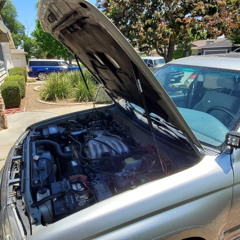

If you get some Spiker hood struts you won’t need that prop rod dingaling anymore at all!

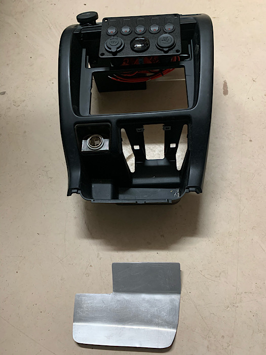

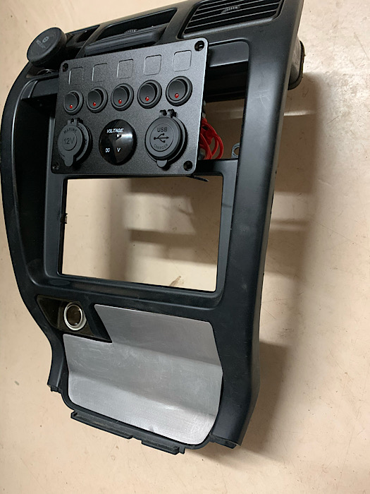

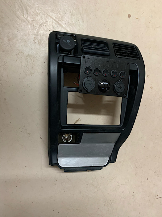

Started making new switch panel. Next drill holes and transfer the switches, voltmeter and usb outlets from the amazon generic switch panel. No more ashtray!
