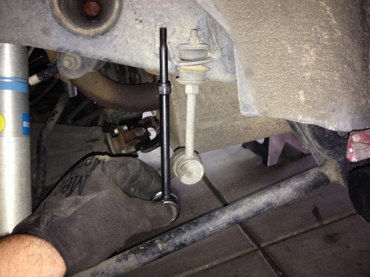

I added longer rear sway bar end links from a 94-95 4Runner to help with some unwanted rear sway. I have toytec superflex rear springs, extended travel Bilstein shocks and Sonoran steel adjustable pan hard bar. These end links bolt right up and have solved my problem.
I should probably try this. I ripped off one of my swaybar brackets on the last trail ride. Too much flex, I guess.

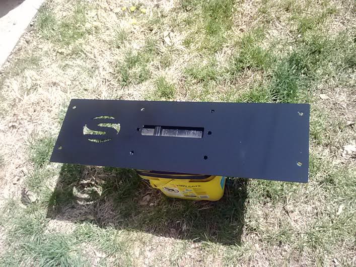

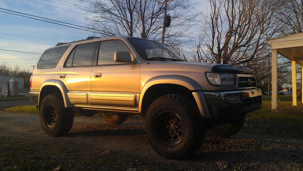

Got tired of the 'smittybuilt' look of my Savage-offroad bumper skidplate being silver.
Black. Because it just works

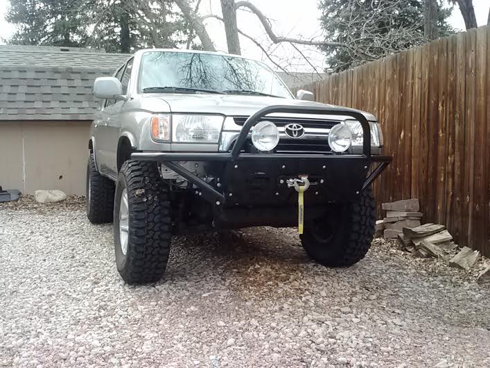

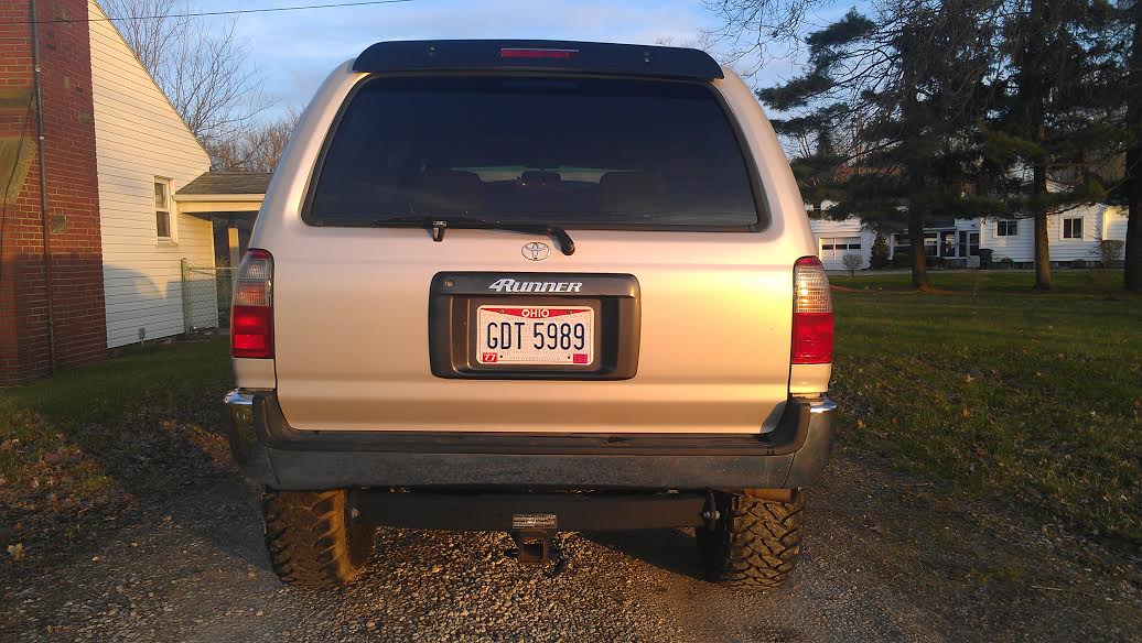

Painted the skidplate to match the bumper and get rid of the 'smittybuilt-brushguard' look I had before.
Much better.
It still says Limited on the sides :) lol I like the clean look on the back.
Anyone think I need to get some spacers??

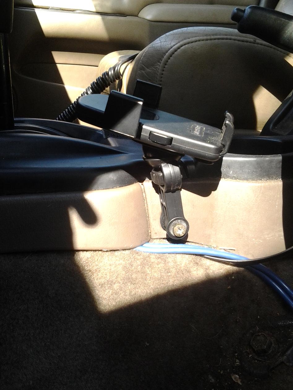

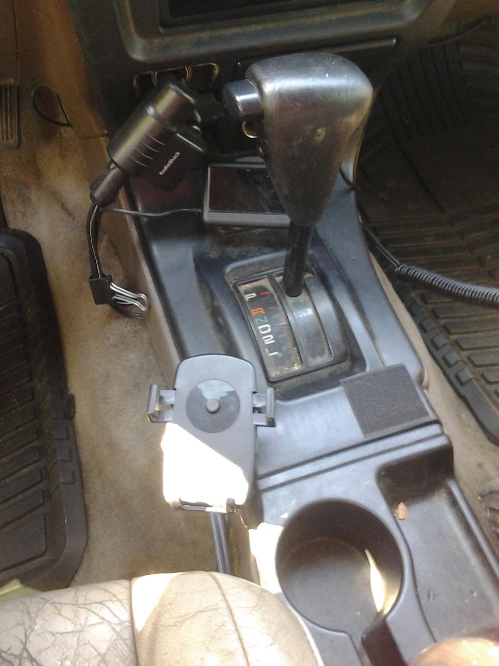

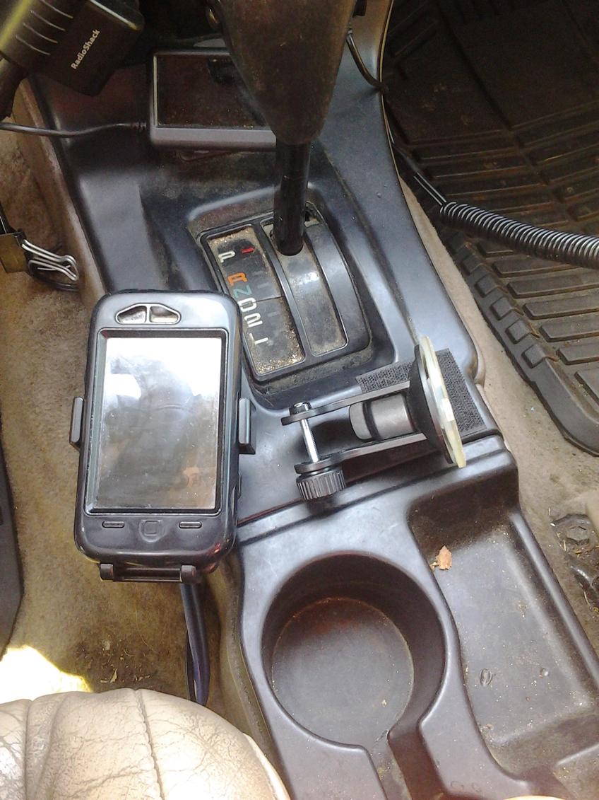

Got bored and decided to put my cell phone mount somewhere other than the windshield. I basically took it apart at the hinge in the middle. Then I used a 1 1/2" screw to mount it where there already was a screw by the console. Anyway, pictures tell most ...
