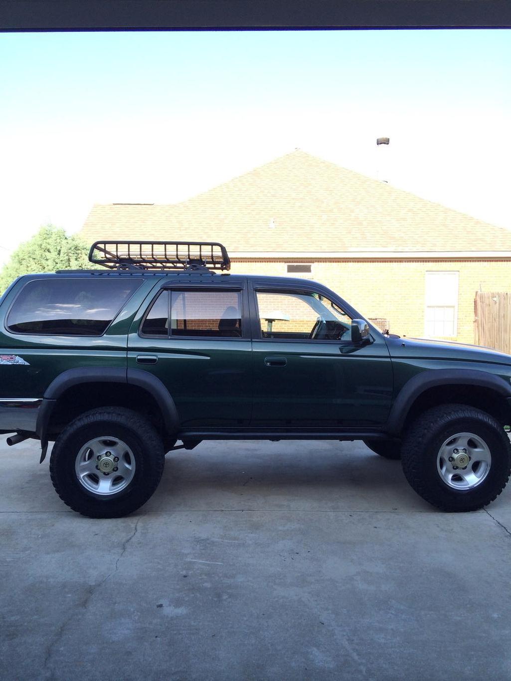

Plasti-dipped my fender flares today. Really happy with the results!

I would suggest putting any additional weight, especially a battery on the passenger side of the vehicle. The 3rd gens and 1st gen Tacos all ready have enough weight on the driver side.
It will be fine where it is. I had already turned up the driver side coil over a bit to compensate for lean. Not the best solution but it works. Plus with the tire carier bumper I'm picking up the spare is on the passenger side so that will help.
