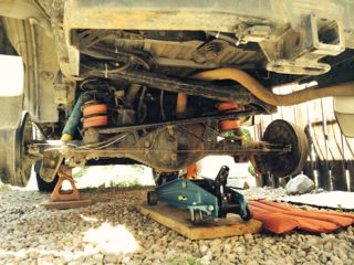

Finally finished up putting the suspension on. And got it aligned. Kings in the front with Camburg UCAs and OME 890s with Bilstein 5125s in the rear.

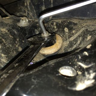

figured out why driver's side was ish1" lower than passenger's... rear sway bar was bent, forcing left side down. removed it and the front one, measured ride height, 35 1/4" at all 4 wheel arches.
checked torque of pan hard bolts, rear shock upper and lower bolts, front strut bolts, trans mount bolts.
