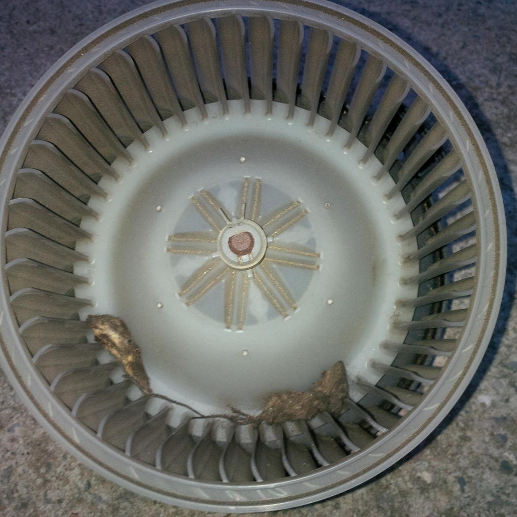

Very simple. I took off the passenger side sill panel trim (4 screws, then it pops up and out). Then just pull the passenger footwell kick panel backward (it just clips in).
This will uncover the 3rd of the 3 screws that hold the fan in, it's pointing upward on the right side of the footwell area. Three screws, bladed screwdriver, or T10 Torx, or (didn't try - 10mm) nut. Take those off and the fan comes down, release the wiring clip and it comes out.
I reached around in the vents with the fan out but didn't feel any other bits of fluffy stuff.
Thanks for the information... It actually took me longer to watch the video than to do the actual work. I didn't get the mother lode like you did but this is what I found... they received a proper burial...
No way! Is that what I think it is...eww! Lol
Now am curious to see what I find lol
DAMN! Did you ever smell anything funny? Mine has never been cleaned. I'm hoping I only find leaves.

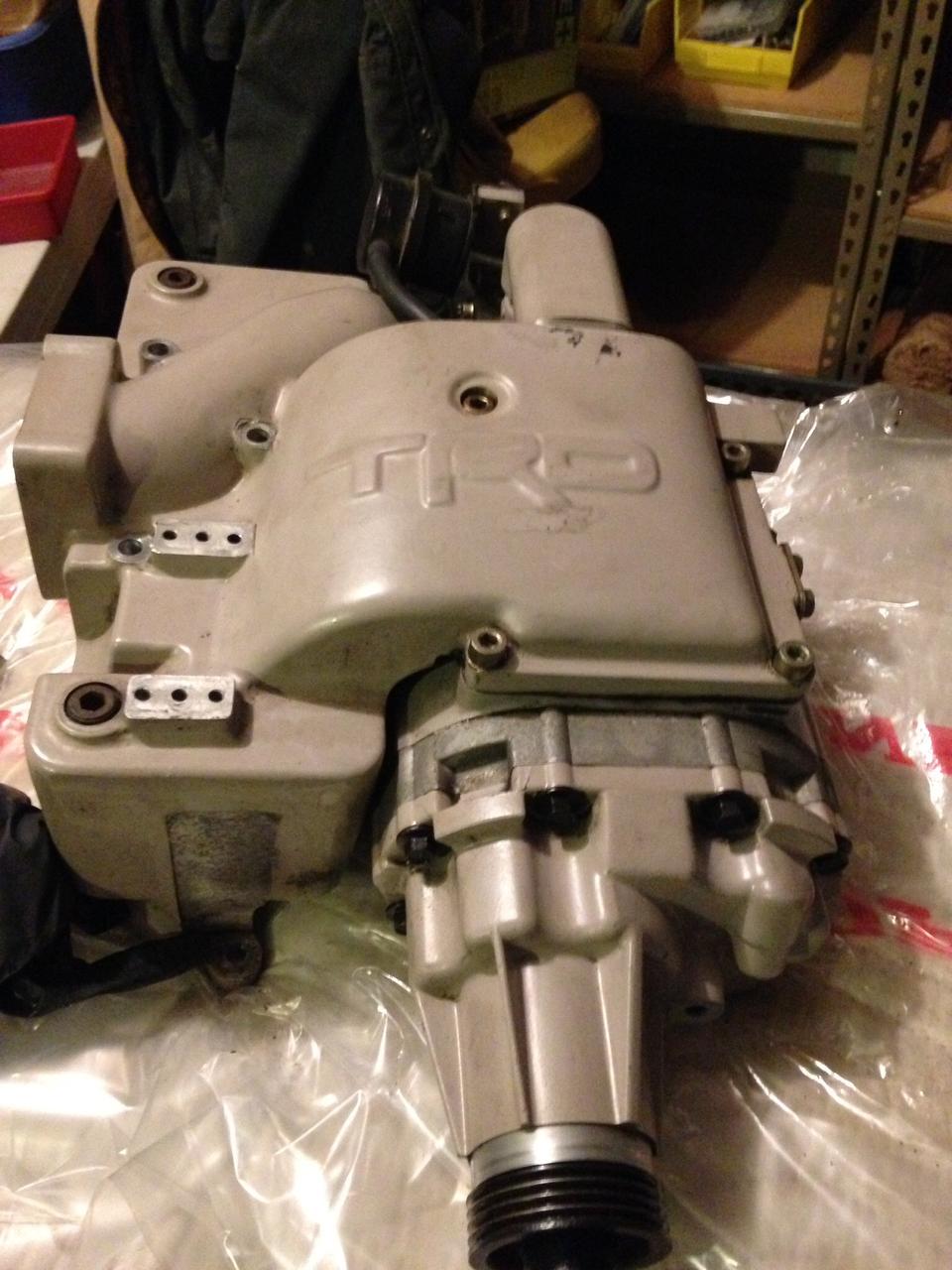

Thanks, I found it local on CL. I never thought much about putting a SC on but hey, if it's good to go once I rebuild it then.....might as well have fun!
