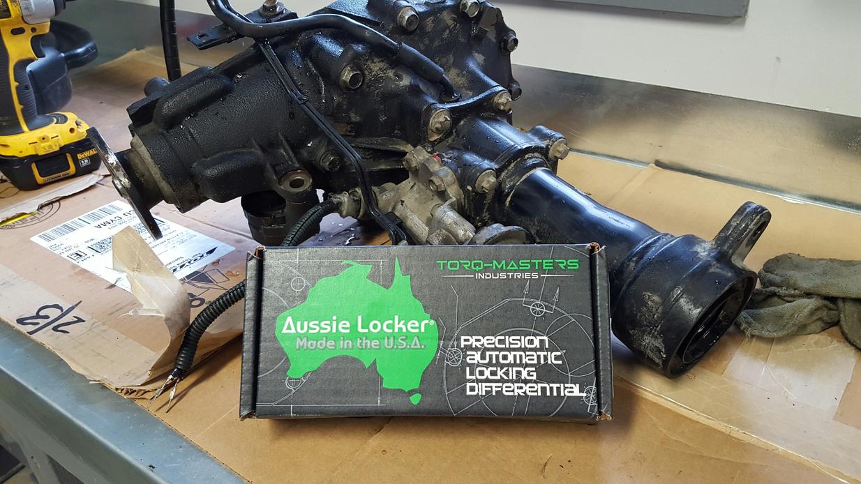

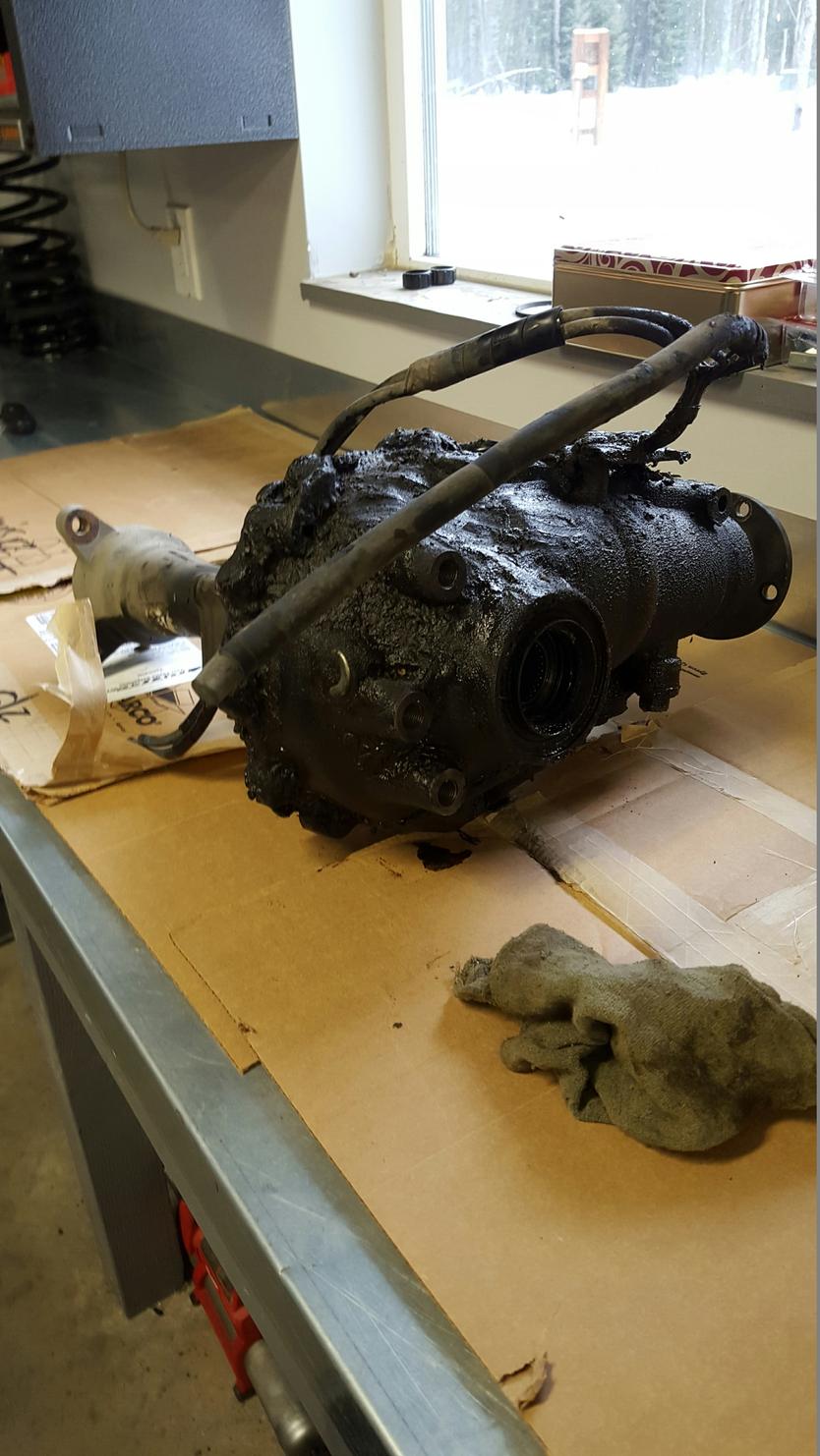

Front Diff out of my parts rig. Cleaned up and ready to get Aussie'd.
