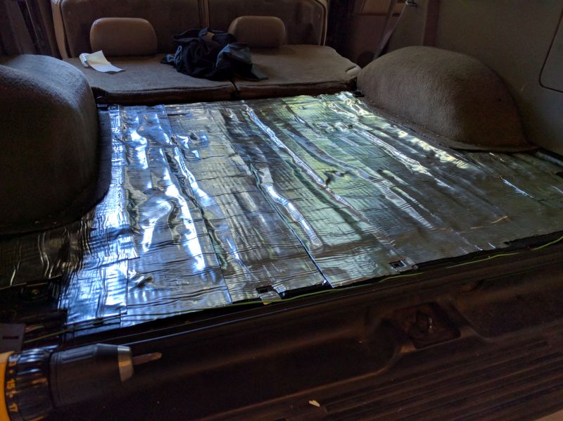

Installed some OME 861's. I got tired of not being able put anything In the truck with out just dropping a couple inches.
Got some sound deadening down in the back. Went with the Peal n Seal method. Went on super easy.
Also finally put some carpet on my sleeping platform, but I didn't get any pictures since my fingers were covered in carpet adhesive spray.
