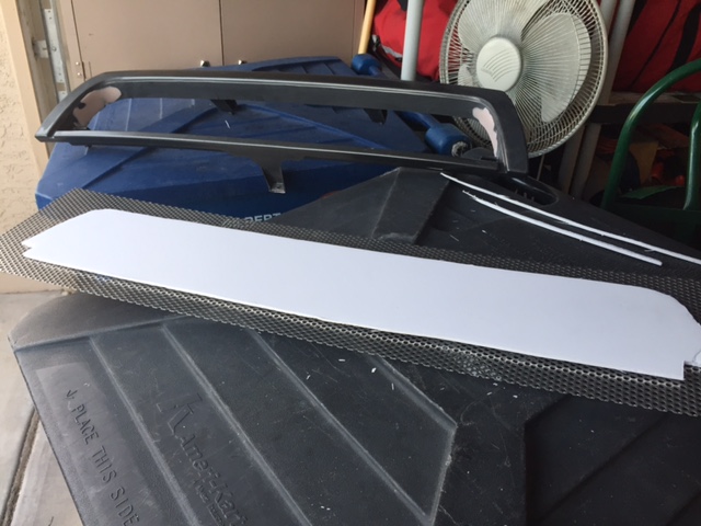

whats the part number for that and are there any holes behind the headliner to align it and put in it? I wanna do that mod as well.
I don't know the part number but just go to a junk yard ( or ebay ) and pull any 3rd gen grab-handle in the color you need. They all fit the same.
As for the holes — the holes are already there behind the headliner. Look over at your passenger side roof mounted grab-handle and then feel the same spot but on the driver's side. You should feel the holes behind the headliner.
Use a razor, screwdriver or whatever pokey thing you have handy and poke two holes in the liner where you feel the mounting holes behind the headliner. Then just screw in your junk yard grab-handle and you are done.

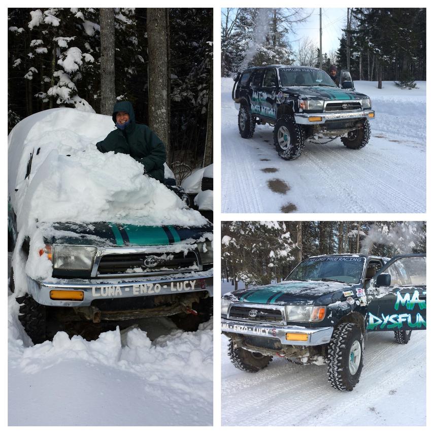

Out of hibernation!!
We've accumulated over 3 feet of snow over the last 5 days. Finally cleaned off our T4R mud truck and played in the snow. Awesome day!

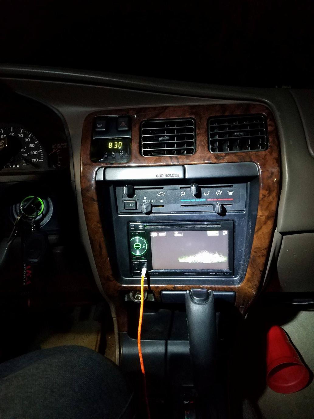

i decided to take the old alpine that came with my 4runner and install my spare Pioneer double din
I am also not sure of the part number but I did put my stock rear handle up front and used a handle from a 2nd gen. Color doesn't match too well but it's in the back so I am not too concerned.
I found if you sit in the back seat behind the driver and look at where the front handle will go, you will see two indentations where the holes are. I was really surprised to see it so clear. Can't see it from the drivers seat. Used a exacto to make a tiny slice and on it went.
