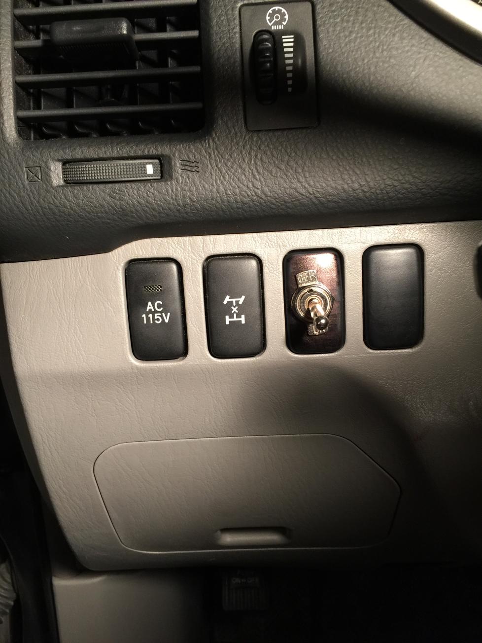

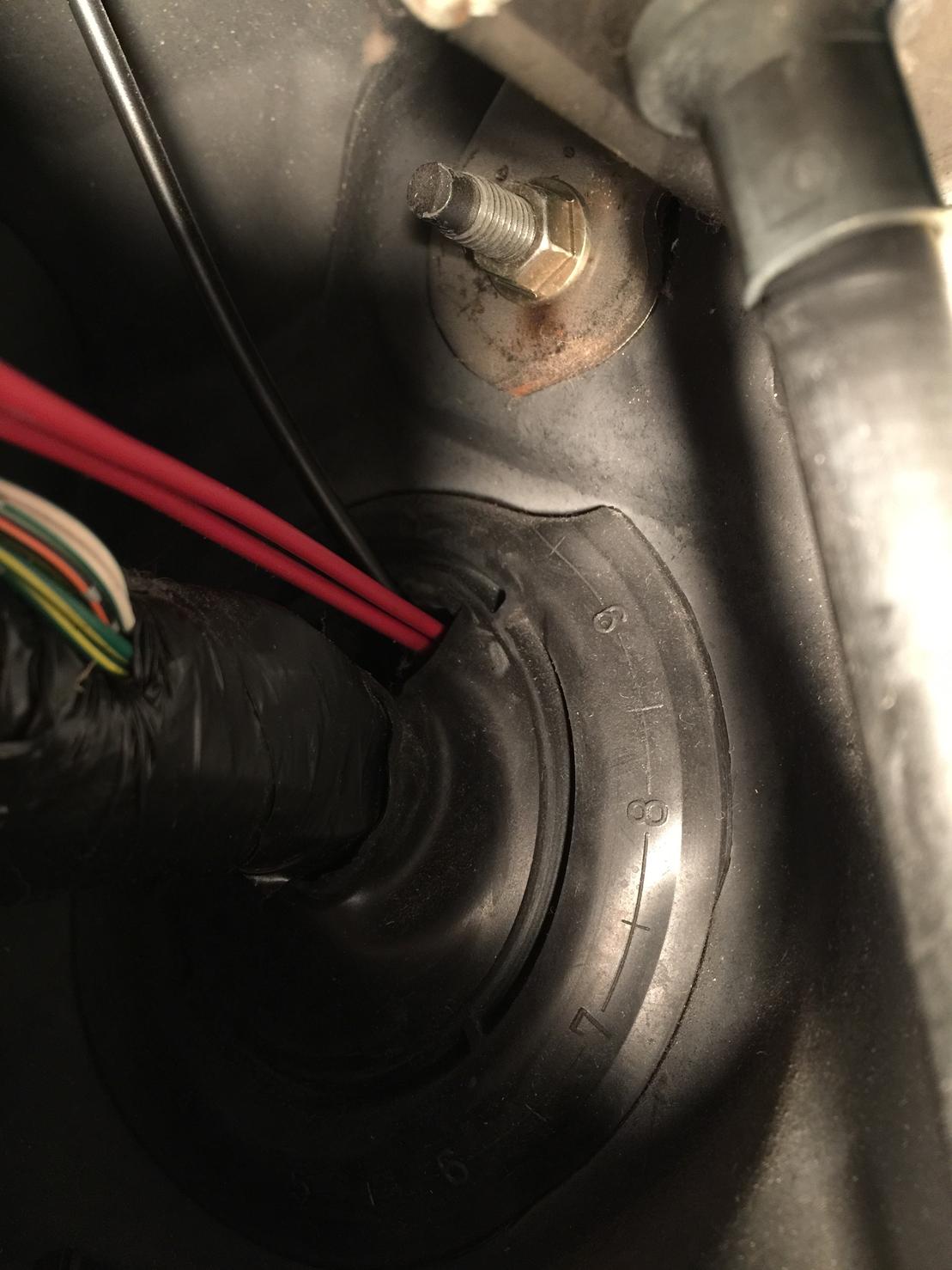

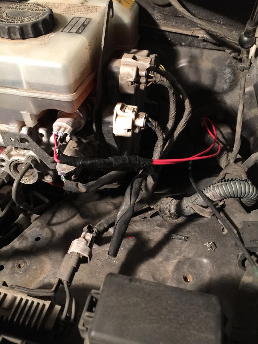

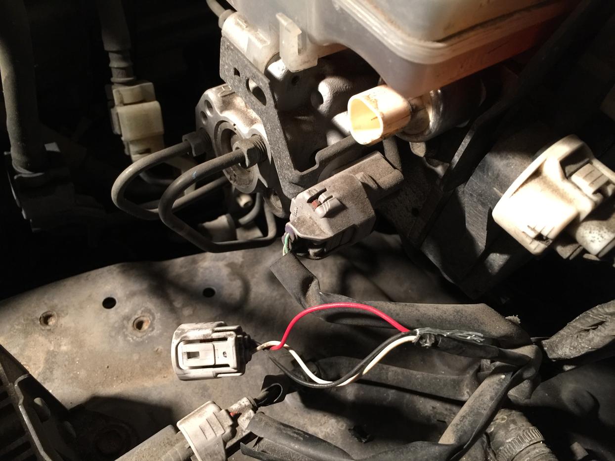

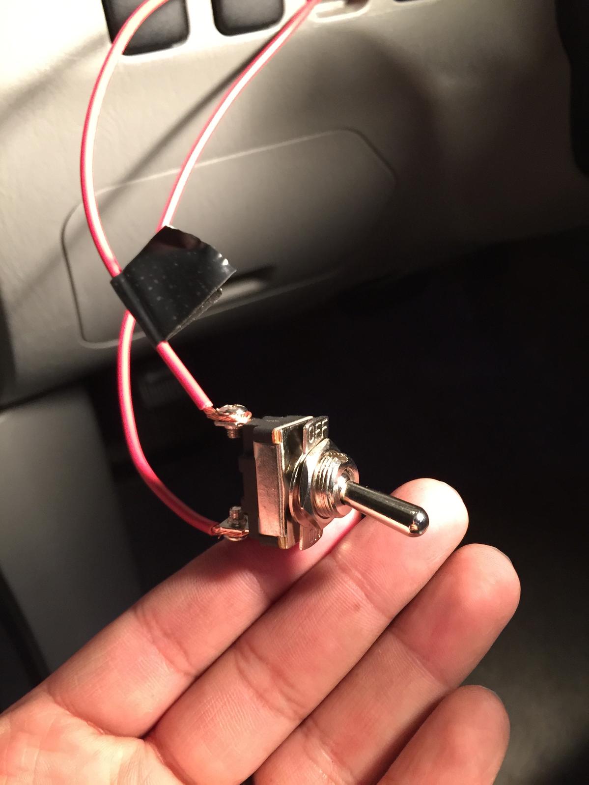

I successfully installed a disconnect switch for VSC, it was surprisingly really easy and took about 20 mins. I was able to try it out in some snow filled parking lot by my house, it worked just as advertised !! :party:

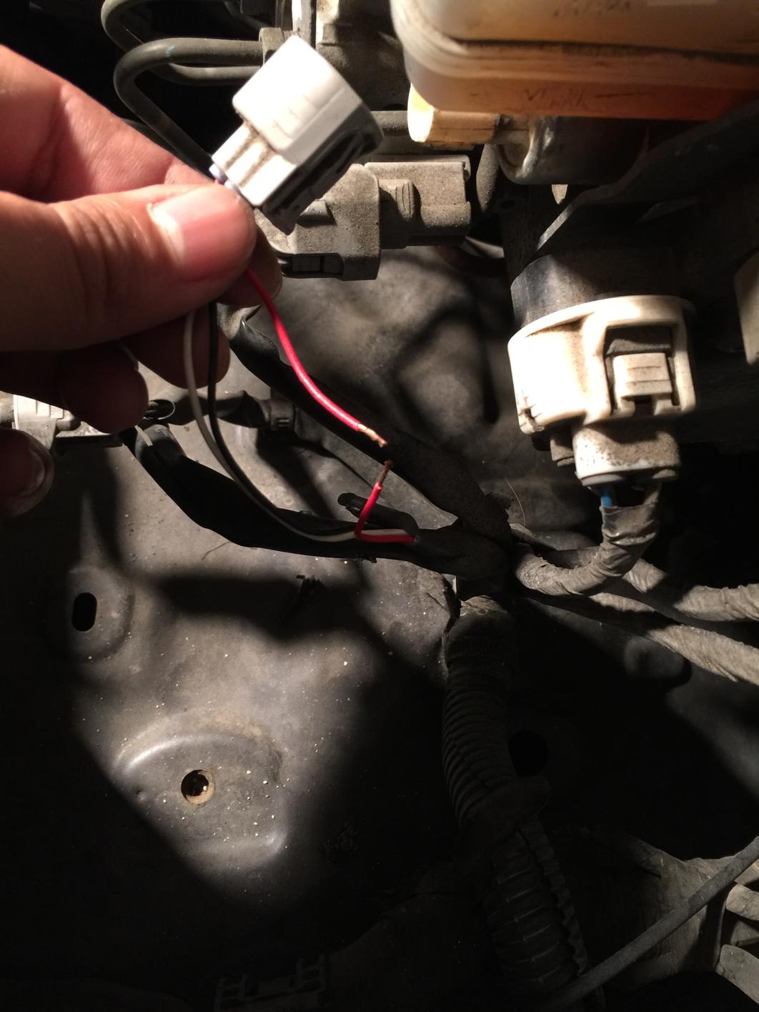

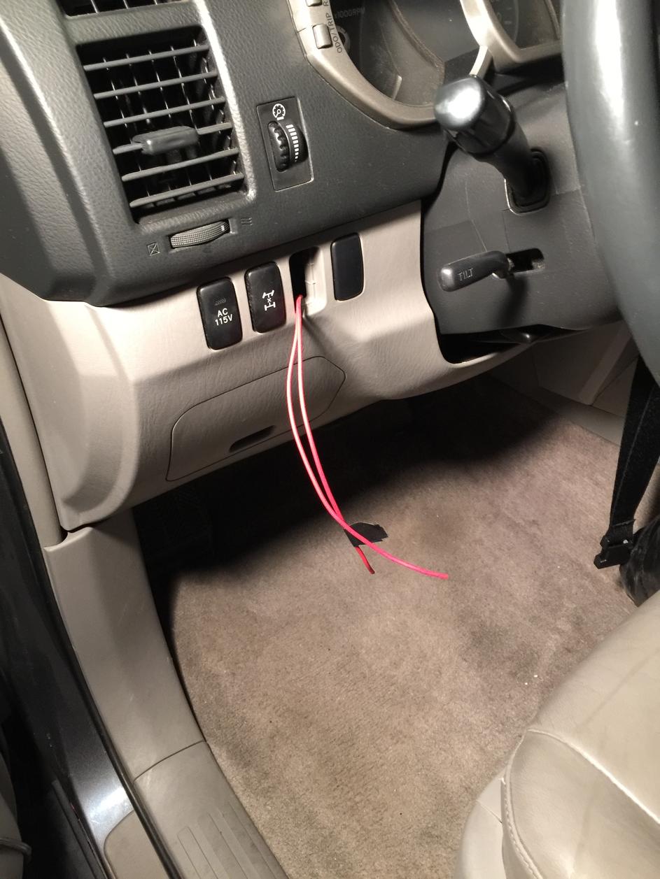

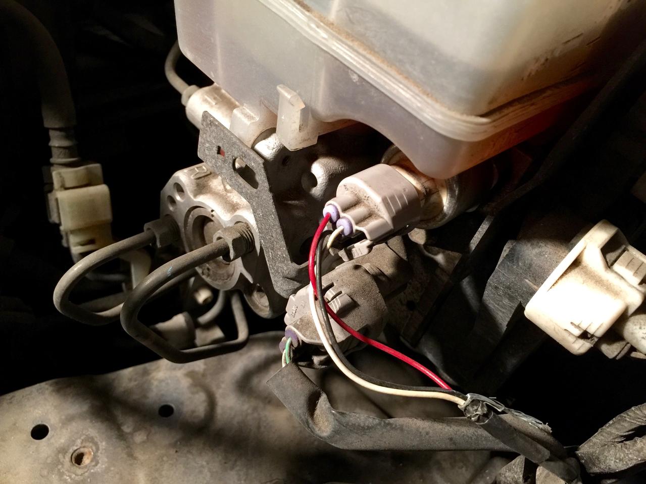

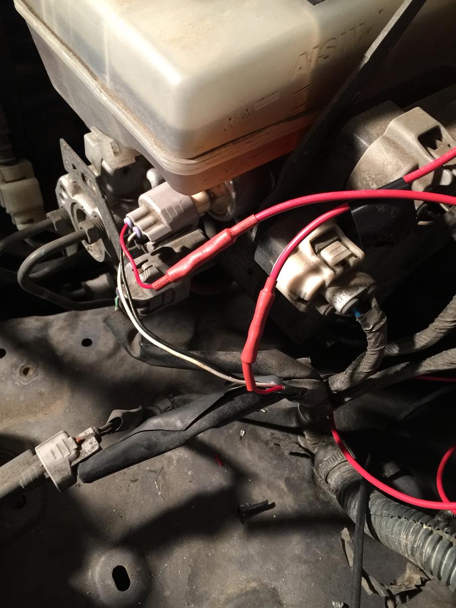

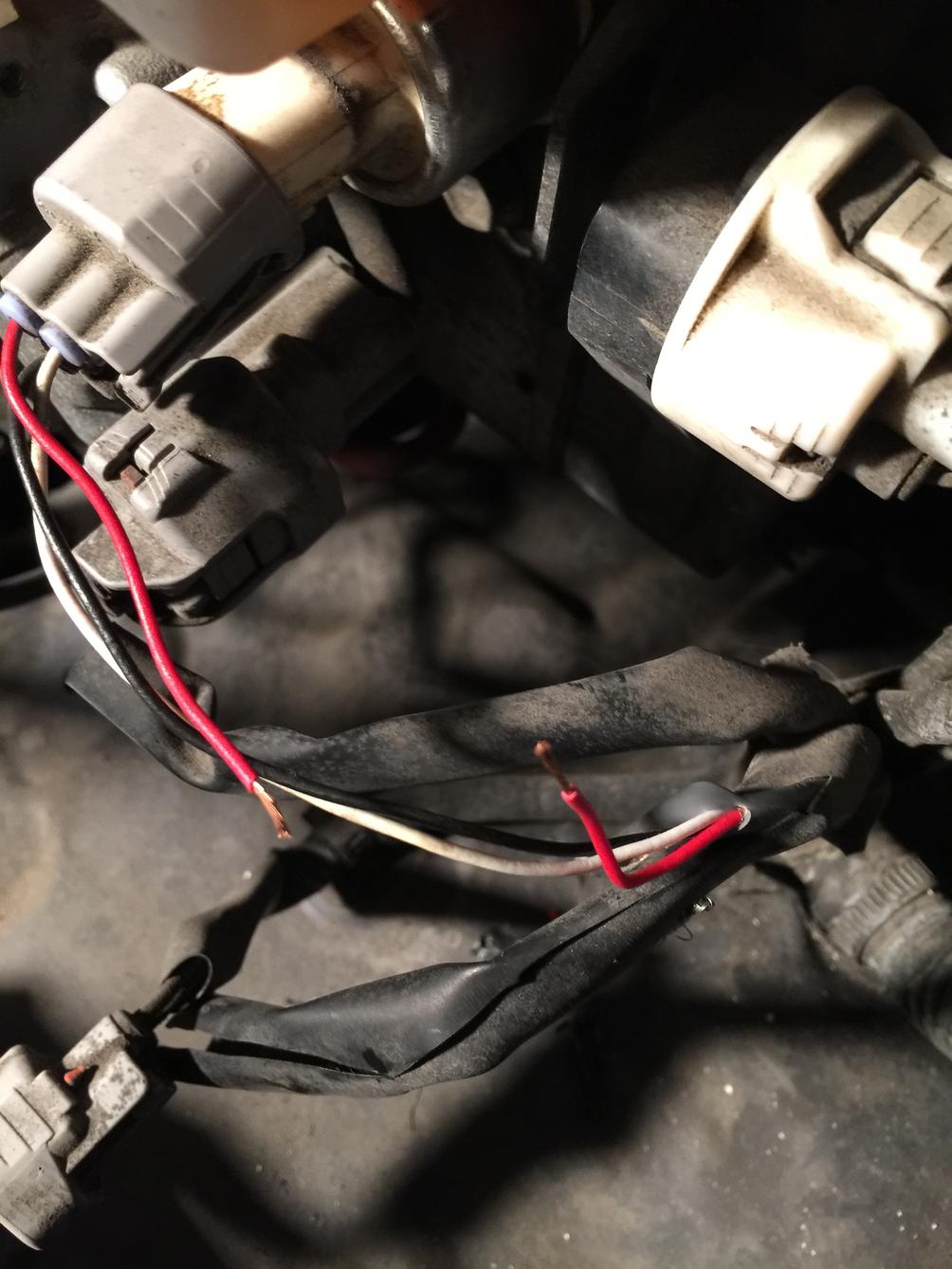

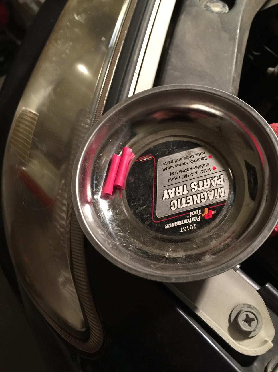

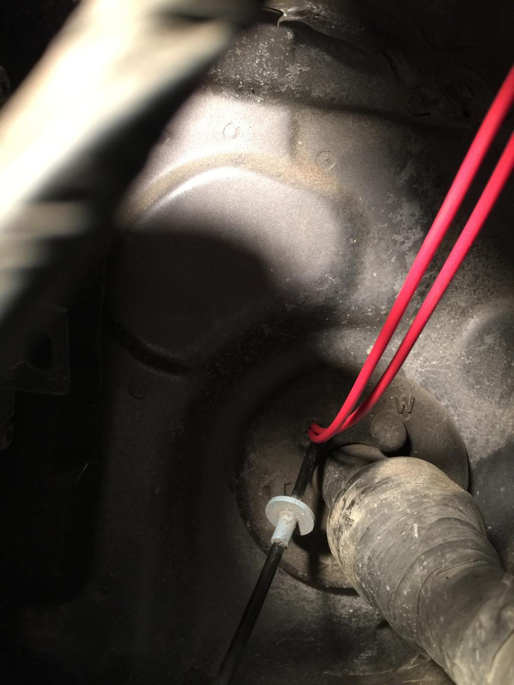

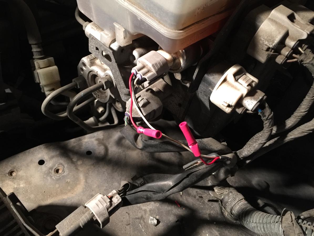

It was a write up by Morphious, it basically said take the plug under the master cylinder with the 3 wires coming out of it and splice a switch into the red wire. I have pics I'll post them today.
Here are the pics, I haven't figured out how to put captions on each pic.....

VSC Disconnect pics continued.... The end product isn't as pretty as I'd like it to be but for my first successful mod im not complaining :bravo: Ill trade out the switch with a more stock looking one later :reddance:

Much Easier !
I don't know how I missed this post when I was researching yesterday..... This way saves you time fishing the wires through the firewall and keeps the engine bay stock, with all the wires out of sight. Im deciding which switch to replace my chepo one with and then ill probably go with this method and clean up under the hood to make it look stock again. Thanks again [MENTION=93193]morphious[/MENTION] :clap2:
http://www.toyota-4runner.org/1440679-post6.html

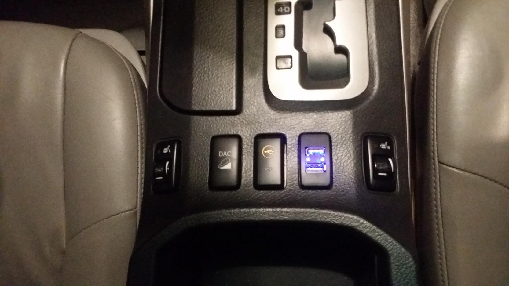

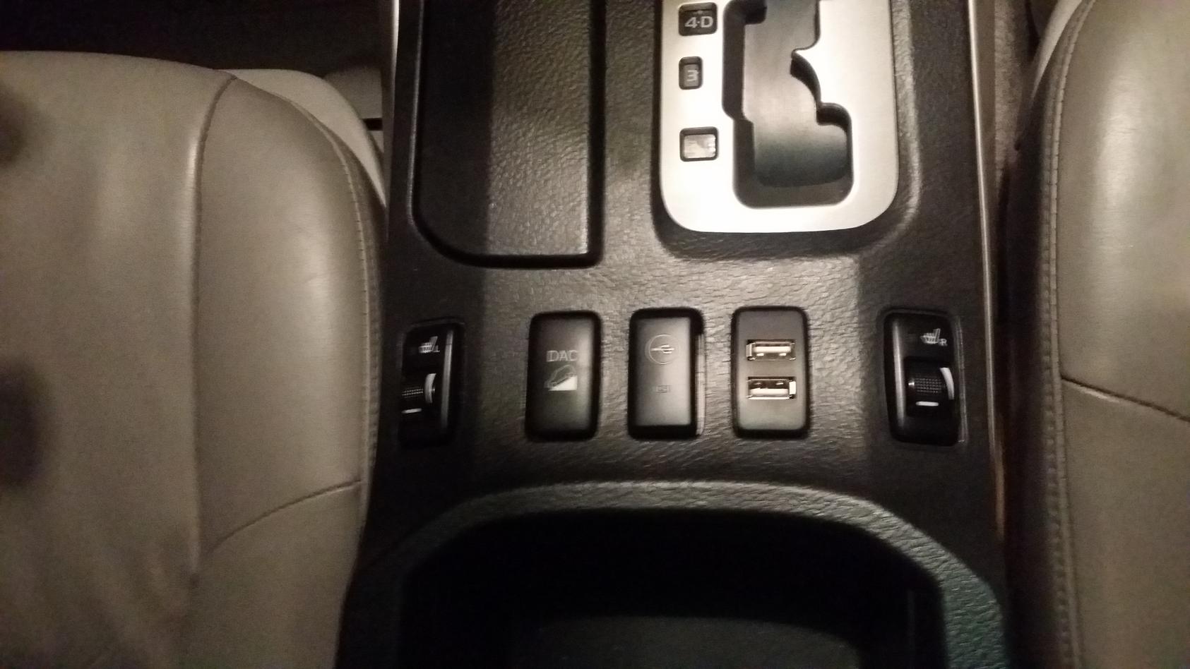

Installed USB ports and Switch
