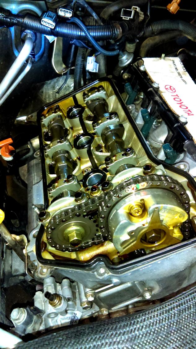

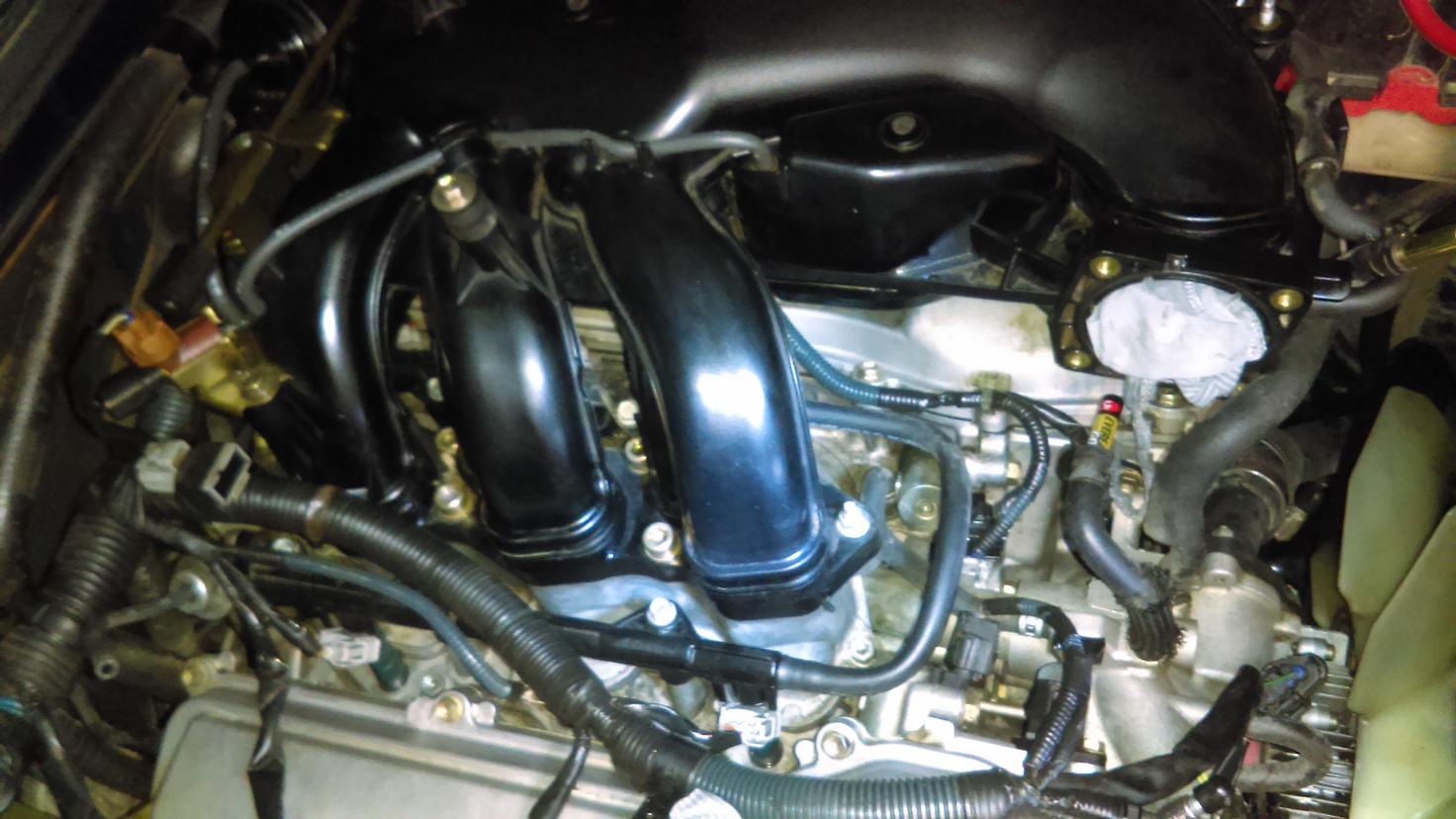

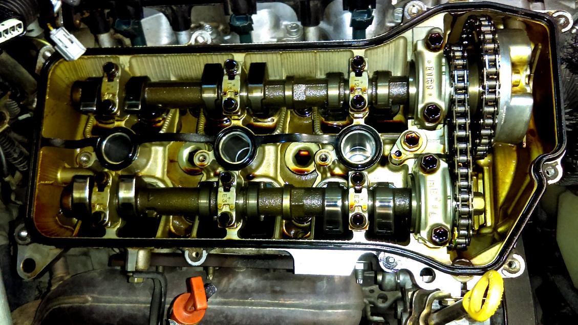

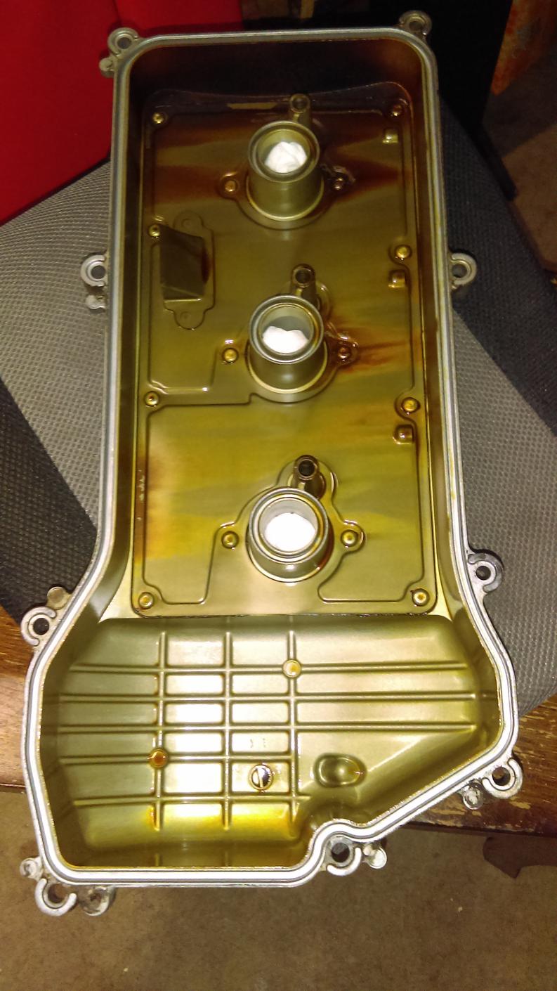

Valve Cover Gaskets

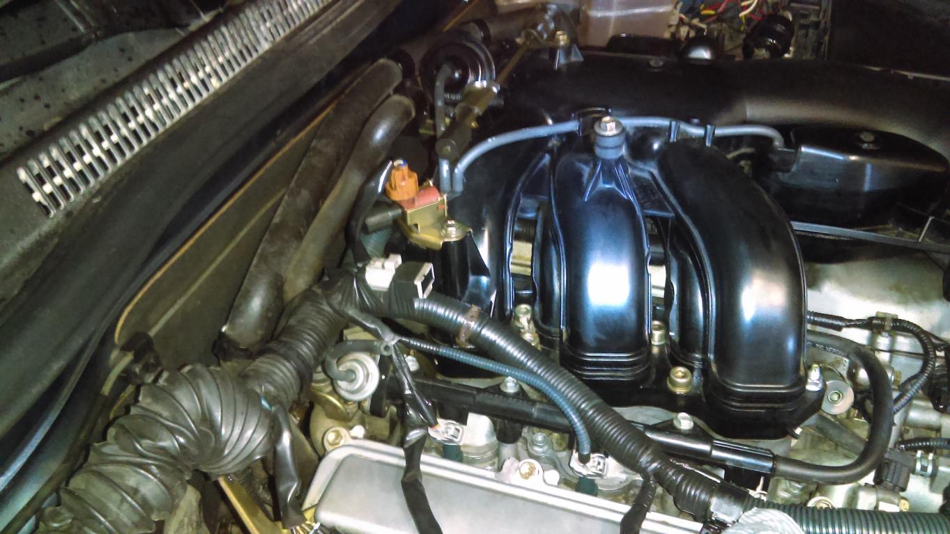

Here is the unvailing of my passenger side valve cover:
These right when I pulled the cover off untouched not cleaned yet...
Rig is 2003 V6 2WD SR5 4Runner
Mileage 265,000
Oil: Mobil 1 Syn changed every 3-4K
Filter: Mobil 1 M209 or M102
Driver Side and job completion tomorrow

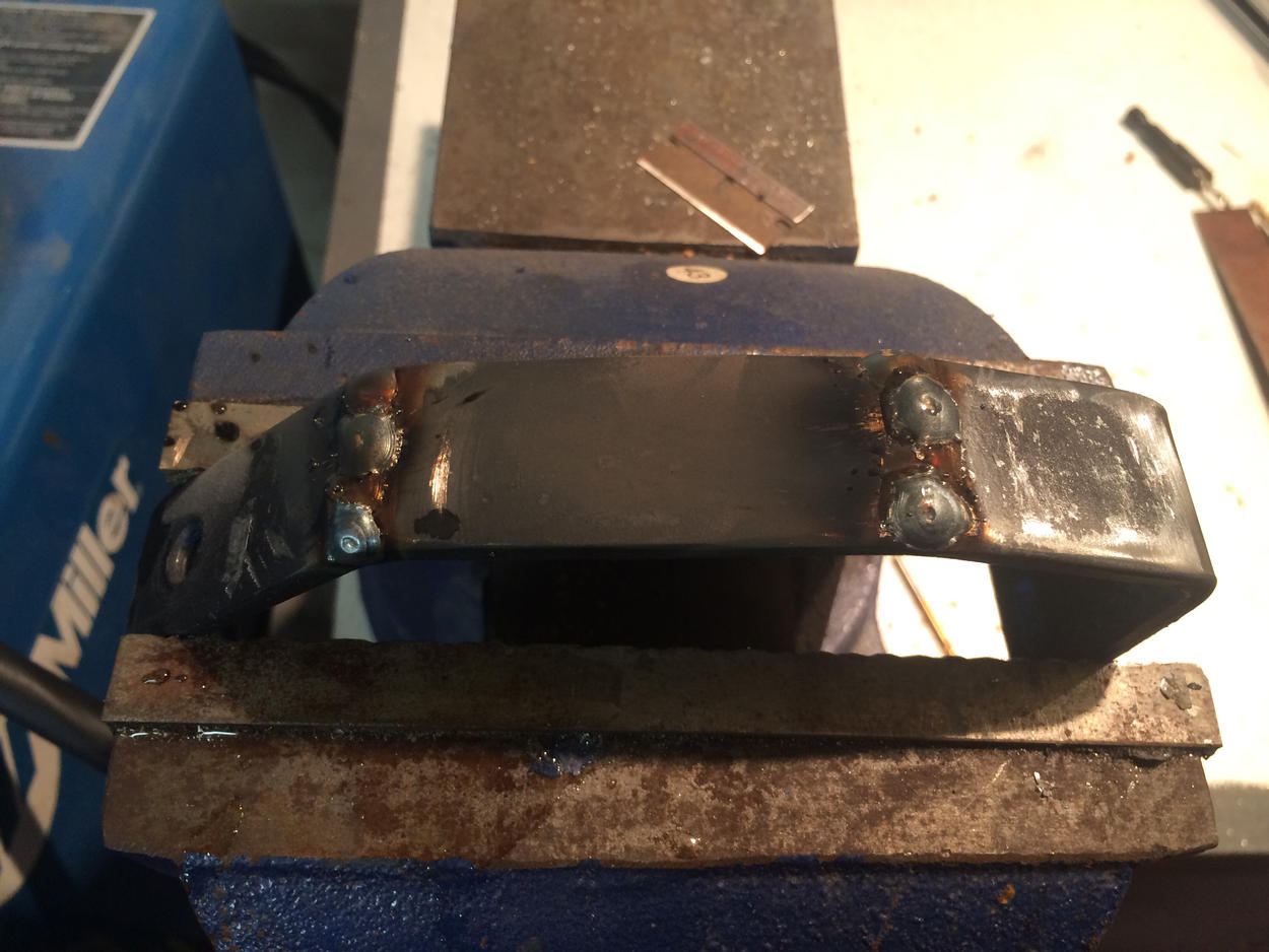

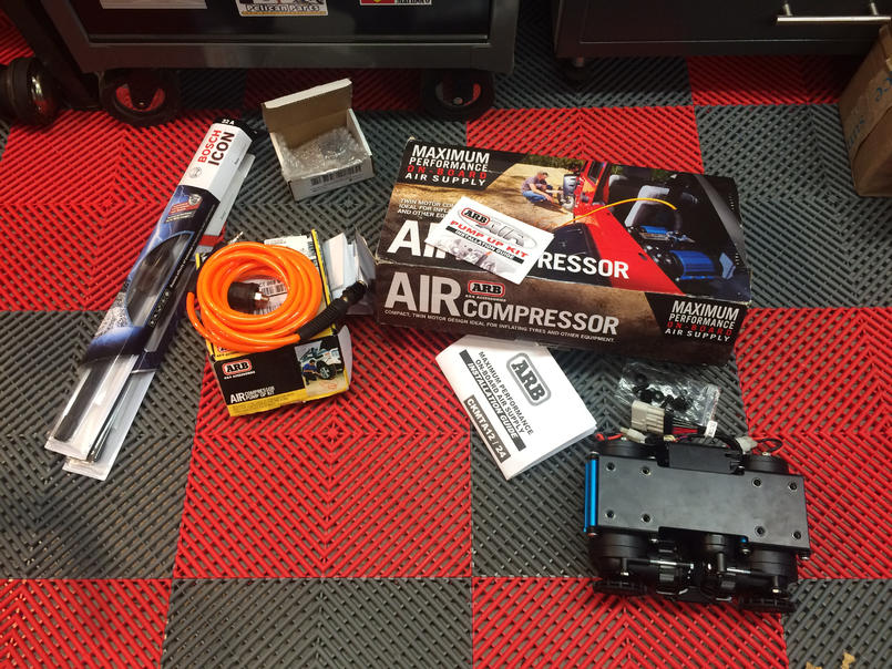

Finally getting my compressor mount completely fabricated and ready to go. Got a pile of goodies I need to get in there. Also did my first EVER welding today. Lots of fun and good experience, but be warned, they are not pretty haha. I made sure to grind 'em down though and put some paint on it :D

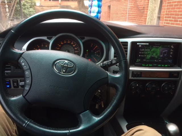

Installed my christmas present!!! (new pioneer headunit). I have no experience with car audio at all and everything went really smoothly, so I'm excited.
Also in the lower left of the pic is my recent lightbar switch which got wired into the dash light circuit, more exciting things.

If you watch any videos off of the USB make sure you update it to the newest firm ware.

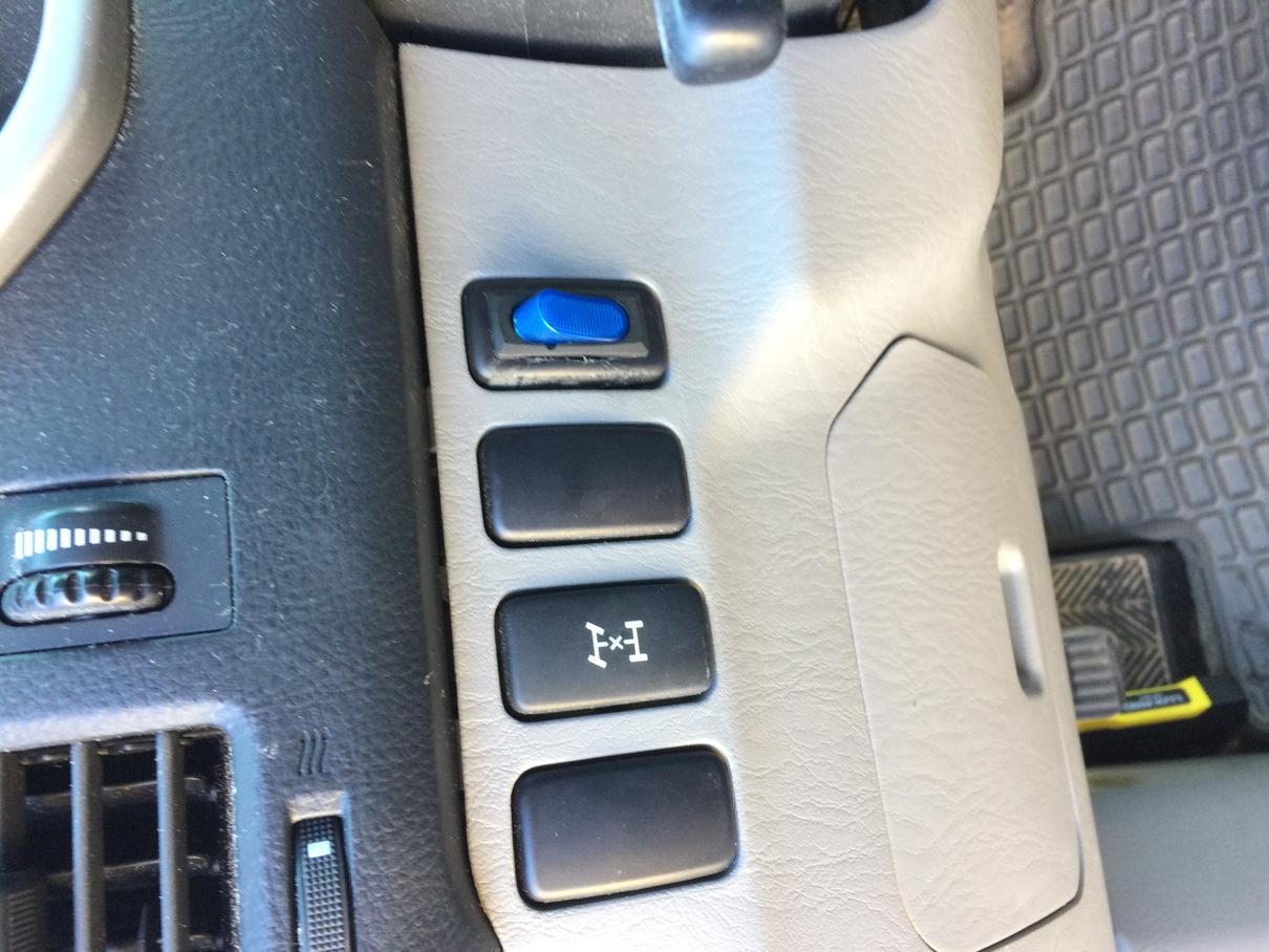

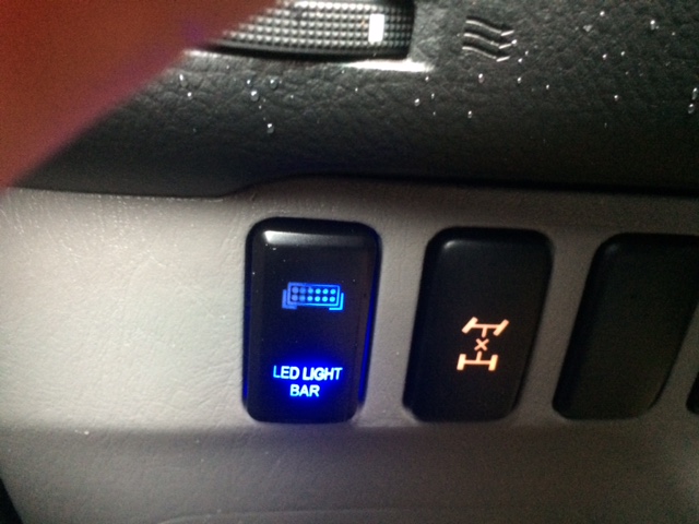

Got a pic or two of how you wired the switch in to the dash circuit? What wires did you tap? I have two switches over there and that is the one thing I have yet to figure out!
I need to buy a switch, what one did you use and do you like it?
Trust me, that was the hardest part to figure out haha I blew a fuse in the process. Basically I tapped into a wire going to the center diff lock switch (since that has illumination). My switch doesn't dim but it still looks and works great. I'll get a picture for you when I can!

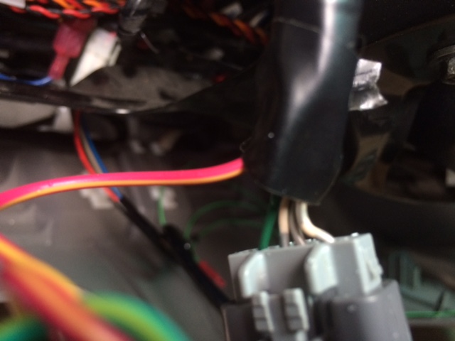

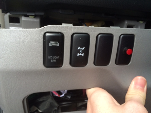

Here are my two switches side by side as im removing the lower plastic cover

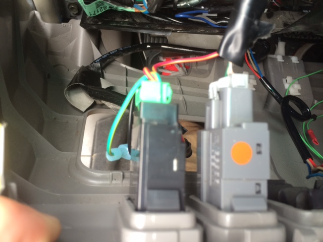

And this is looking down at them with the cover off. My lightbar switch is on the left, center diff switch on the right. The red wire going from my switch to the center diff switch was the one that controlled the dash light illumination on my switch. I then connected that red wire to the green wire on the center diff lock switch (you should have 3 grey wires and 1 green wire). This will make your switch light come on when you turn your lights on.
