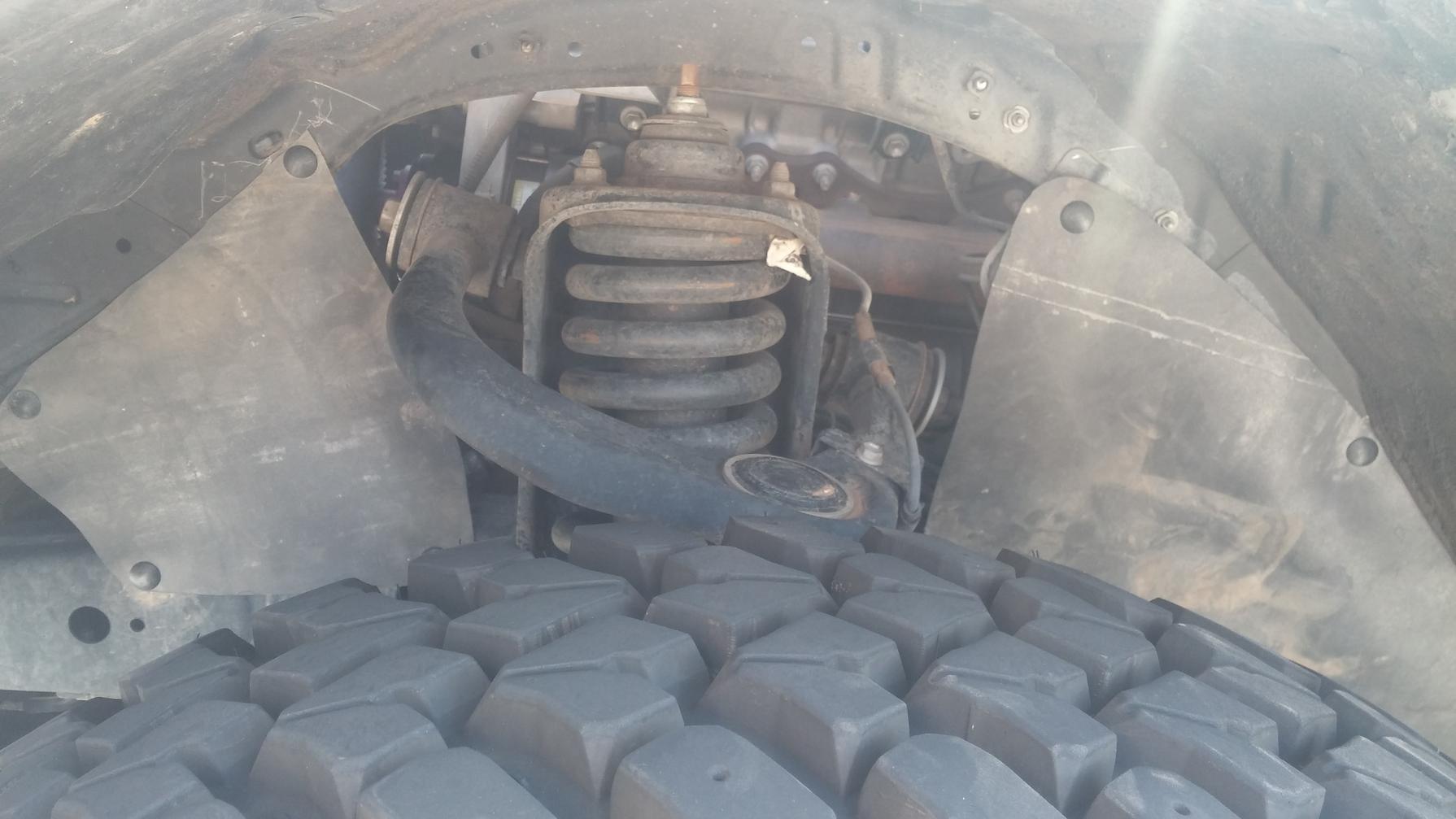

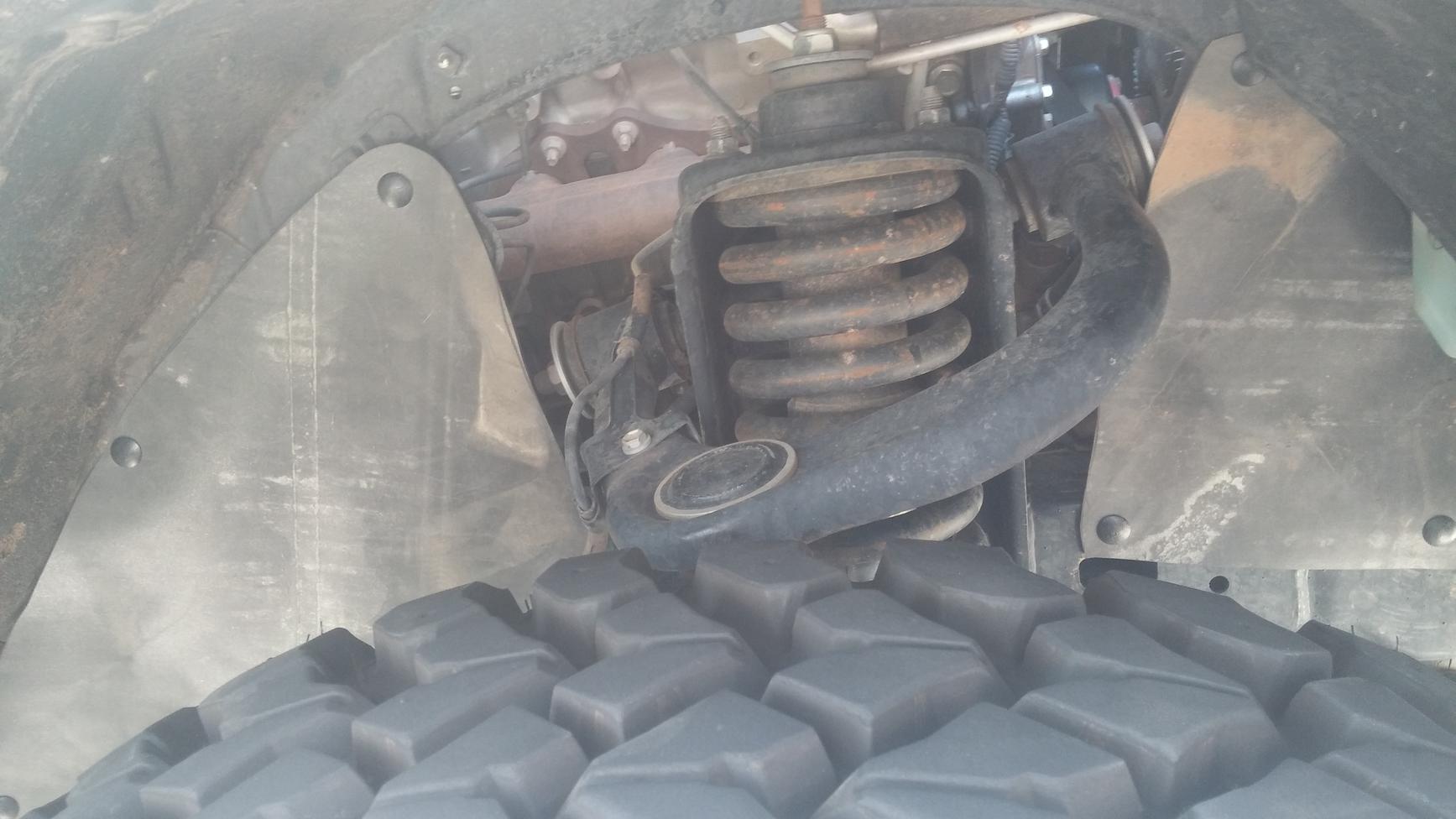

My splash guards had been crumbled and non-existent for quite a while, so I finally got around to replacing them today. I used EPDM pond liner.

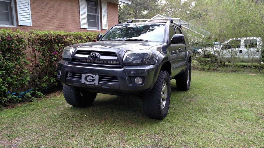

Finally got my big light bar mounted! (heavily modified SLAG mounts, lol)
Received and installed RCI front skid plate (so much better than the rusted ugly looking stock pieces)
Also got my tint done a couple days ago (20% up front, 35% over factory rear, 70% crystalline windshield)
Light bar whistles a good bit but with moderate music volume you can't notice it.

I like that exhaust tip. Clean rig buddy. Wheels keep it looking classy.

good lucking truck man, those are the exact same size tires i wanna go with next time. any rubbing issues? i currently have 265/60/18 ko2s.
i see in ur sig it says 2885 front spring..not familiar, could u explain? how much lift did that give u in the front?
have u had to do a diff drop or UCA's?
question bombardment i know lol
No rubbing issues - only thing I did was push the plastic fender well forward in the front (and remove the front mud flaps, but I was going to do that anyway).
Old Man Emu 2885 coil springs up front - That and a 3/8" top plate spacer I believe gives me just about 3" of lift in the front - No UCA's although I may swap out in the near future - Annnnd yes to the diff drop.
Also - Thanks!
