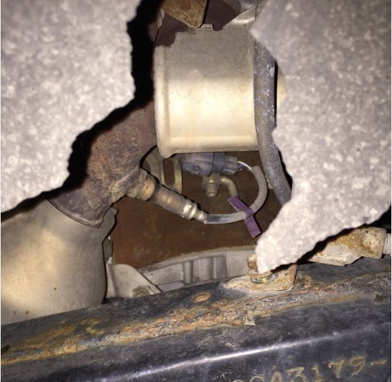

Yea after doing some research that seems like a possibility. I'm gonna get a code reader thing later at an auto parts store and check it out. If it is the O2 sensor, is it tough to fix?
I didn't use the senor socket that was mentioned, I just used a 14mm (think) wrench. Point is, you don't "need" to buy a special socket to do it. When you get the codes, remember... ,at least on my 04, bank one is drivers side. I had bank one sensor one. That's the one right behind the drivers side wheel, and if your plastic is blown out like mine is... super easy to get to!! This is a pic of the passenger side, but its the same on the driver's side... same sensor too.
Just to clarify, bank 1 is passenger side, bank 2 drivers side.
Sensor 1 is before cat, sensor 2 is after.

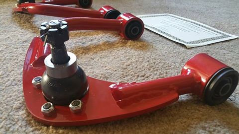

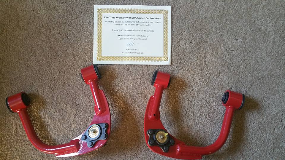

Got these in the mail today.. bigger and better stuff coming in tomorrow!
JBA ball joint upper control arms. These things seem like high quality parts.

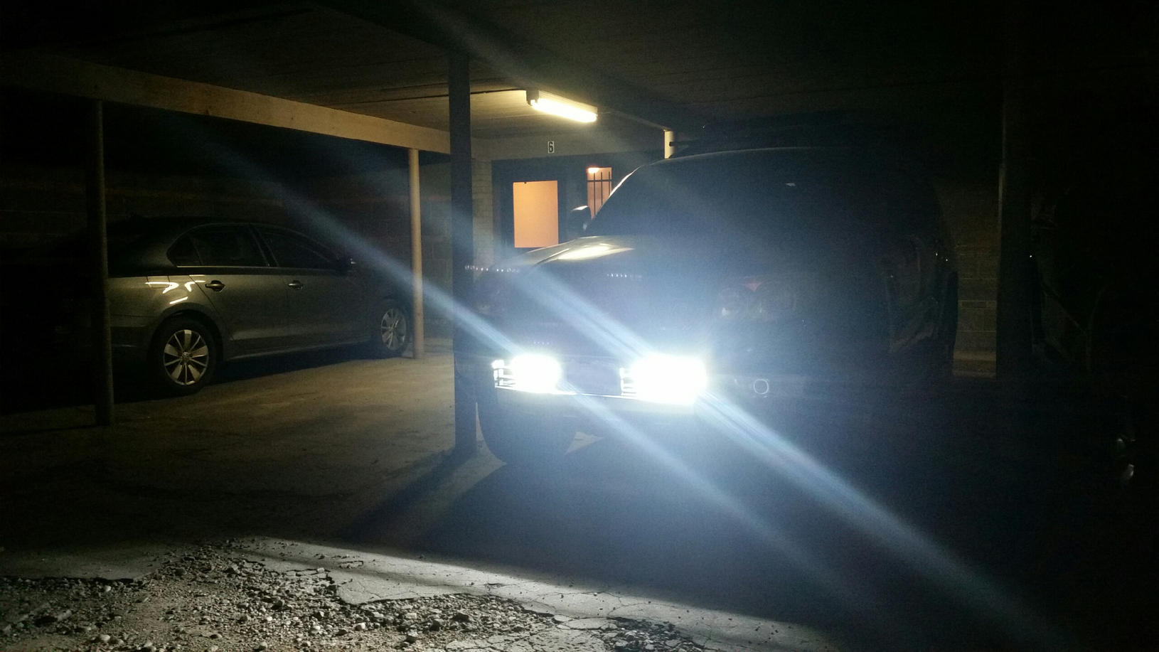

New light bars!
This was over the past couple of days, but I got em all done. 2x12" Auxbeam light bars, everything installed under $100. They are much brighter than my headlights. I like em a lot!
