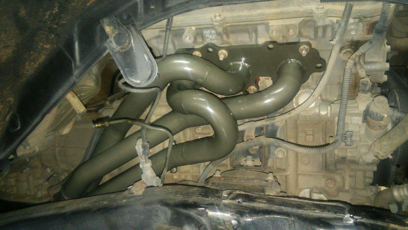

Need to replace oxygen sensor. I am about to order one and just want to make sure that I have the right part number and location. It is a P0051 code. Meaning Bank 2, Sensor 1. From what I have read, this is the passenger side closest to the front on the V8.
Is this the correct piece/location? (This is on the passenger side)
If so, is this the correct part?
Link: https://parts.camelbacktoyota.com/p...iteid=214329&vehicleid=84056&diagram=8416200#
Part Number: Toyota 8946560150
Thanks so much!

Yes. Bank two on the V8 is passenger. You are also correct, that is sensor one. Very easy to change with the blown up plastic mod like I had on mine too. :boink:
Edit... yours is just folded down.
Haha yea its folded down. But thanks for the response! I can't wait to order that part tonight and hopefully get those dash lights off over the weekend!
