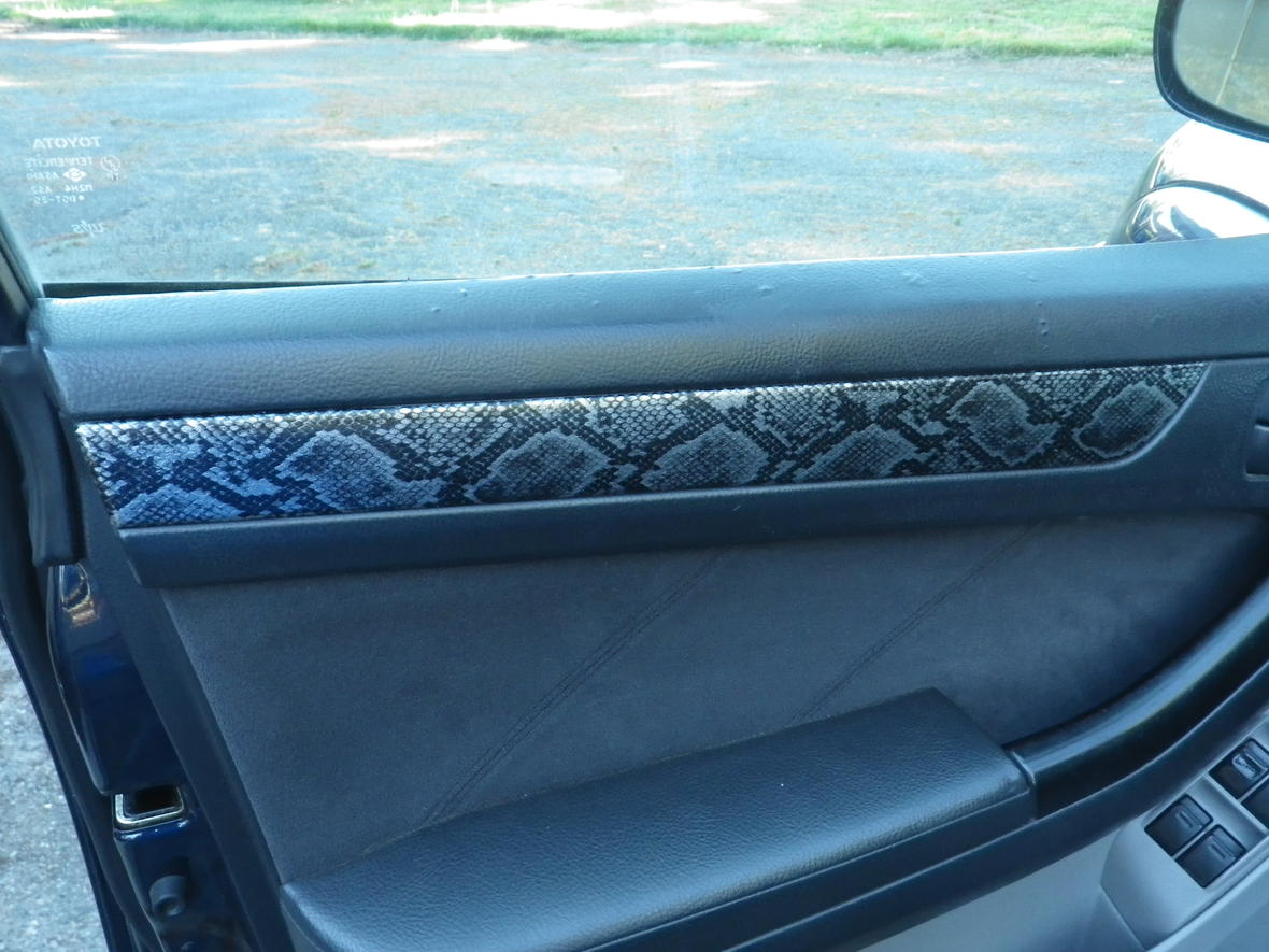

finished my vinyl project, on the silver door panel trim inside all four doors.

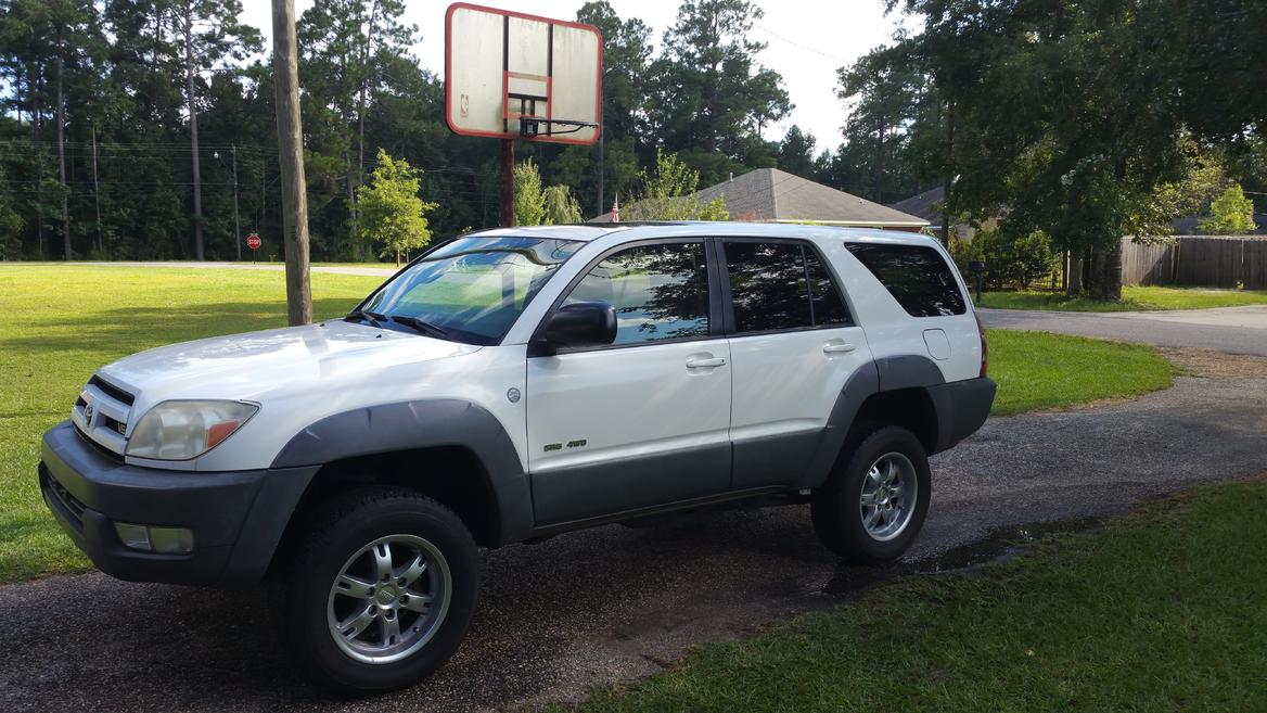

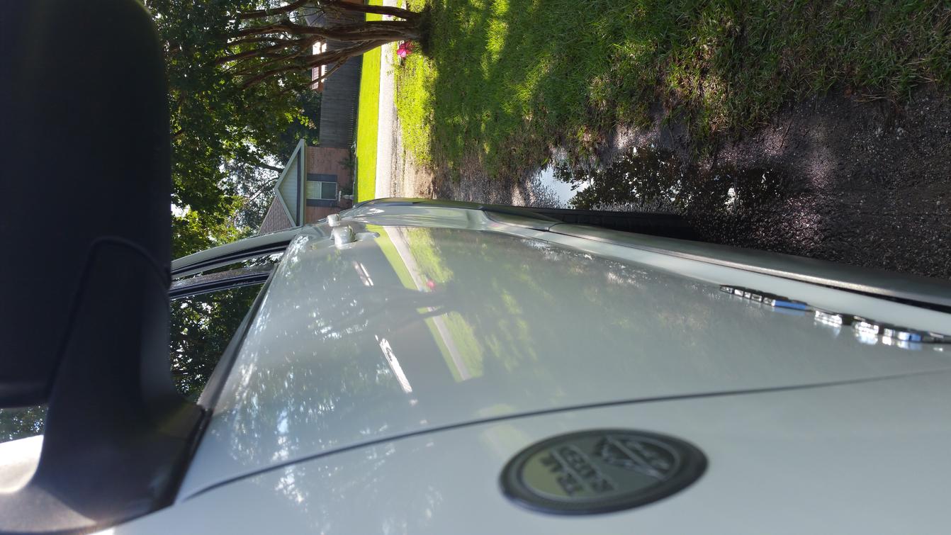

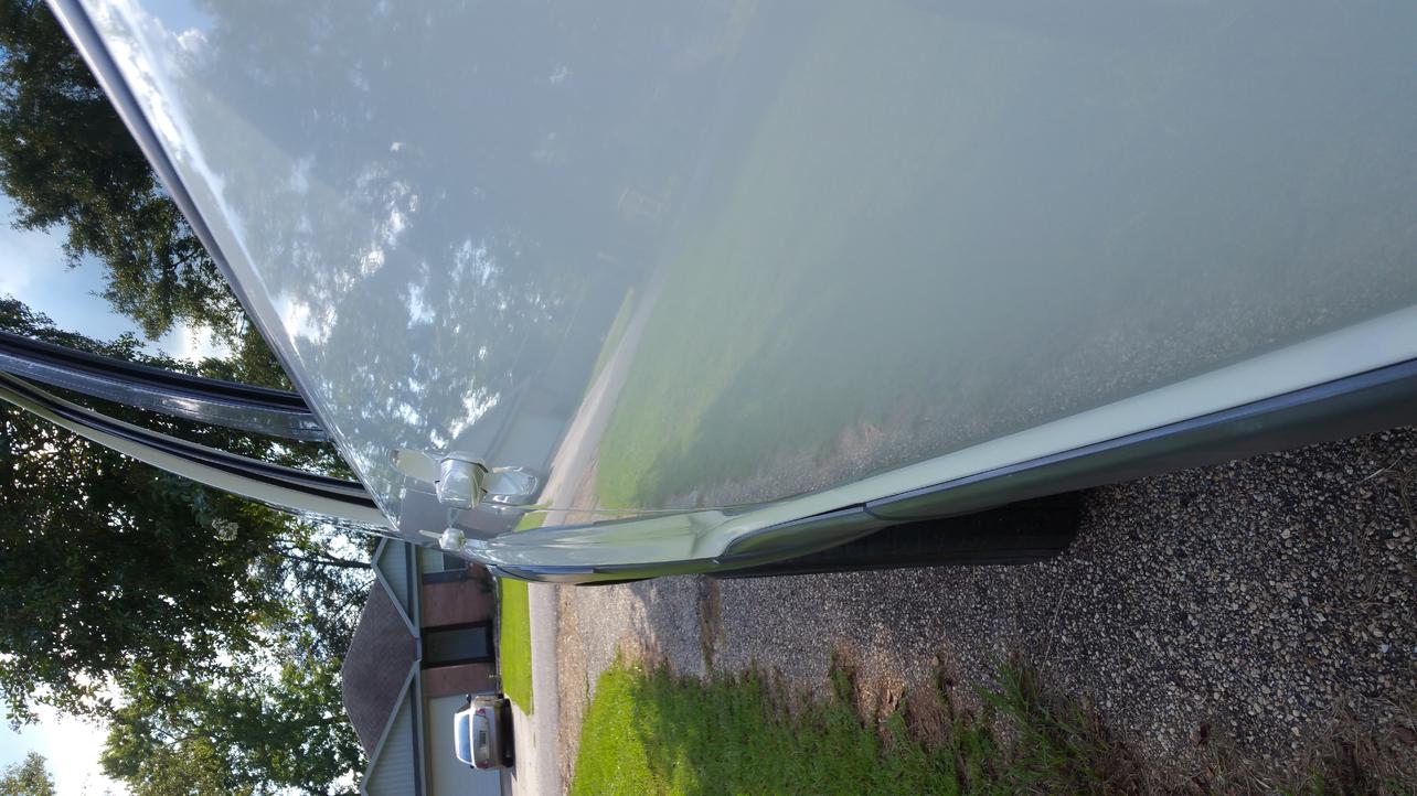

Monday:
I spent a few hours working on my paint. When I bought the truck, the finish was less than glamorous. I'm pretty sure that the PO didn't even own a water hose. I bathed the truck a few times, but was never satisfied with the outcome. Anywho, I spent about 4 hours washing, clay baring, washing, compounding, washing, polishing, washing and waxing. I'm very happy with the outcome on the paint. It is actually glossy instead of matte. I will be buying a headlight restoration kit soon.
Incoming obligatory paint finish photos:
Please forgive the cell phone photos. I am no photographer.
Final thoughts: Buy a damn buffing machine. Hand scrubbing is a *****.

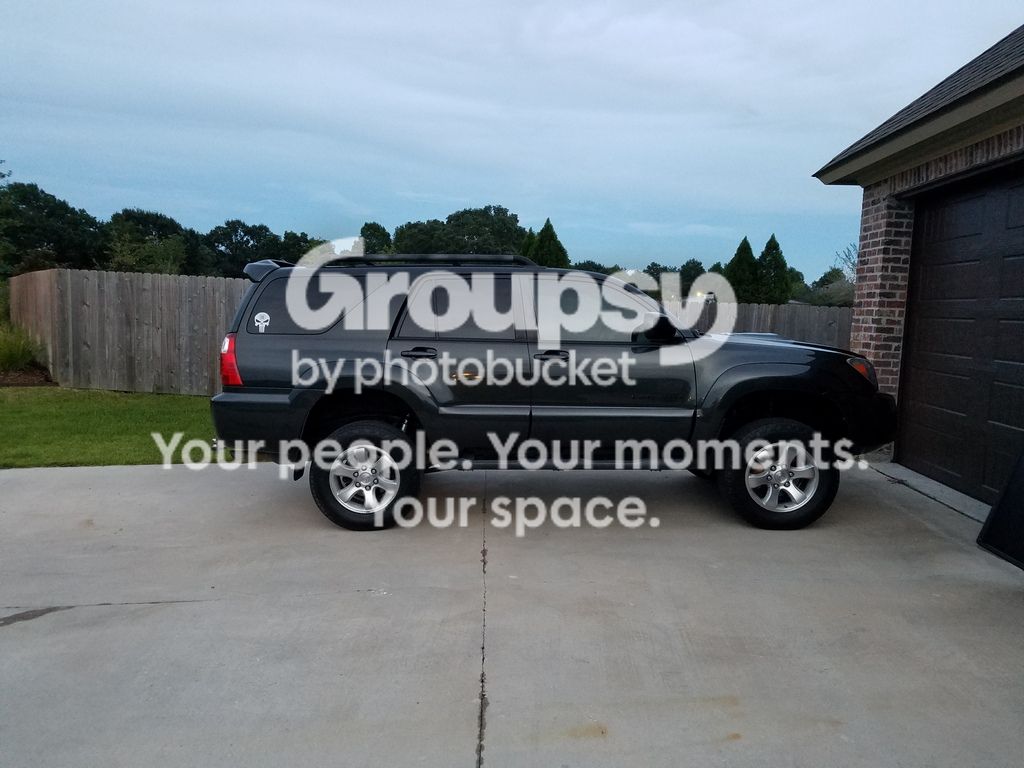

Got my tires and body lift installed. Already had the suspension lift done.
Front: OME 884 on Bilstein 5100s (set at .85)
Rear: OME 895 and Bilstein 5100s
Spidertrax 1.25" spacers front and back
1" Toytec body lift
Nitto Trail Grappler 285/70R17 (C load rating)
Suspension Lift only on old nitto crossteks (245/70R17)
20160815_200007.jpg~original
+Body Lift and Tires:

Thoughts on the mcguiers da drill attachment? My paint is shit but im cheap.
You'll get uneven pressure control with the drill. The most I'd use that for is buffing out headlights.
Get the Harbor Freight DA if you're being cheap with the 20% off. It's a nice deal. Upgrade to some nicer Hexlogic or Microfiber cutting pads on a better backing plate if you want to be semi-not cheap.

I spend 8+ hours with a DA buffer when I do an OCD detailing job.
Used to do it all by hand in my younger days, never again.
Compound was the worst. That took me an hour plus by itself. The paint was SERIOUSLY neglected by the PO. Which is actually crazy since I bought it from the original owner who meticulously maintained the mechanics of the truck.
Anyway, YES. I will be buying a buffer within the month. I plan to try and keep the paint up from this point.
