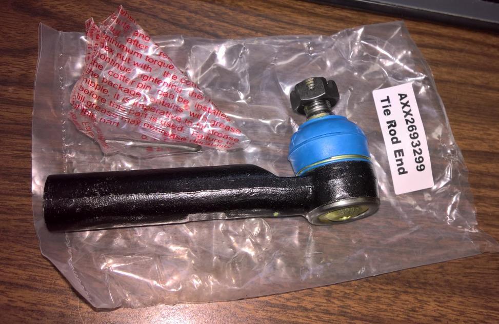

Received ACDelco Professional tie-rod ends. Will install tonight. Tomorrow is finally alignment day.

Is it normal for steering to feel lighter after replacing the outer tie rod ends? Not looser, lighter. Almost 0 resistance when turning the wheel.
Sounds like you adjusted the toe. Did you measure before/after to make sure it was an identical match? Sounds like an alignment is in order.
Maybe that's it. I thought I did it the right way but who knows.
Alignment IS in order, that's why I changed them tonight, since I'm getting alignment tomorrow because of my new 6112s and UCAs. When I was doing the install I found them leaking so I thought I should change them before I get aligned.
That will be corrected when your caster is brought back into spec [emoji106]

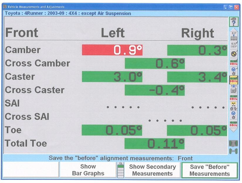

Not very happy.
6112s set at 4/2 for ~2.2 lift
Camburg UCAs with bjs
Guy said perhaps bad driver side control arm. At 177K miles the LCA is definitely more suspect rather than defective UCA. However I will likely postpone looking into that for spring since I need to focus on my bad rear wheel bearings now.

Not very happy.
Don’t even worry about it. That amount of camber will not cause any significant abnormal tire wear that’s worth worrying over. I typically run -3 degrees of camber on my toys (cars) and super sticky tires (wear quickly) and still never saw abnormal tire wear
I'm not worried about tire wear with these specs. I'm worried that this is an indication of a problem somewhere in the suspension. Not to mention I paid $$$ for UCAs so I can get better specs than this.
