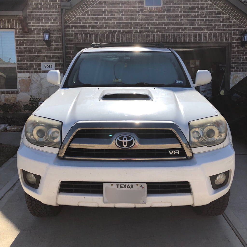

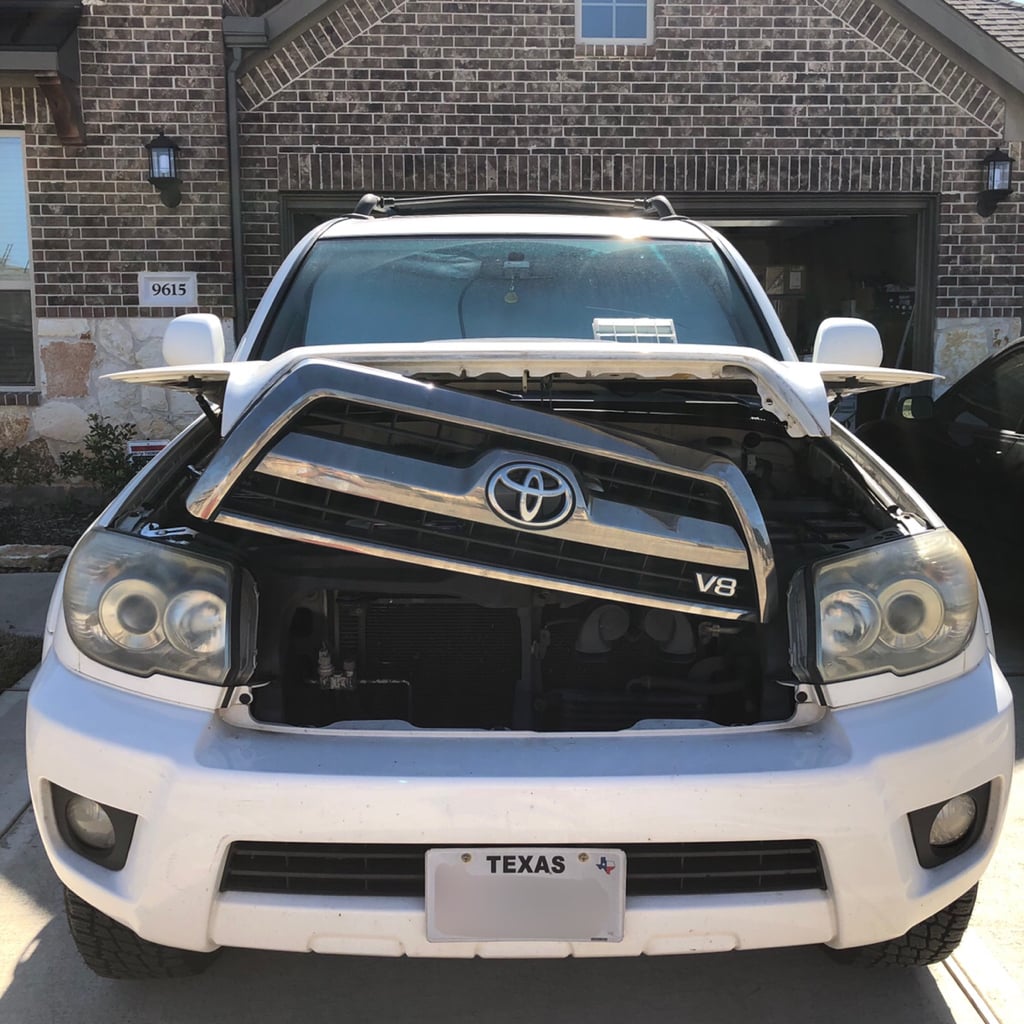

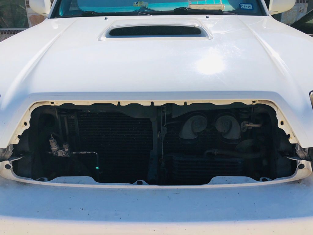

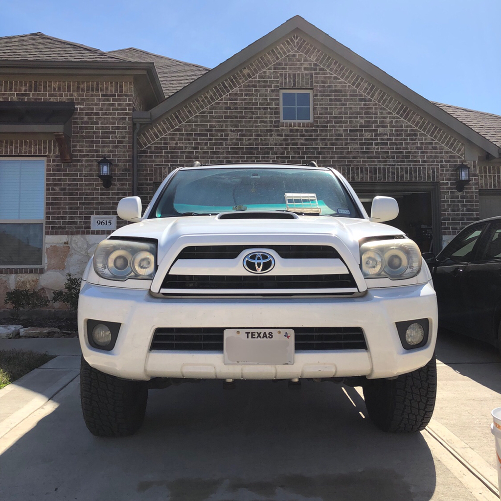

I did a V6 conversion today.

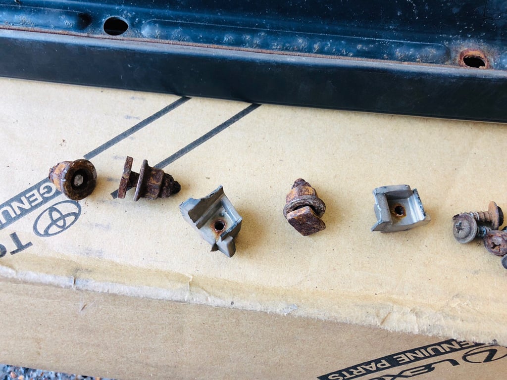

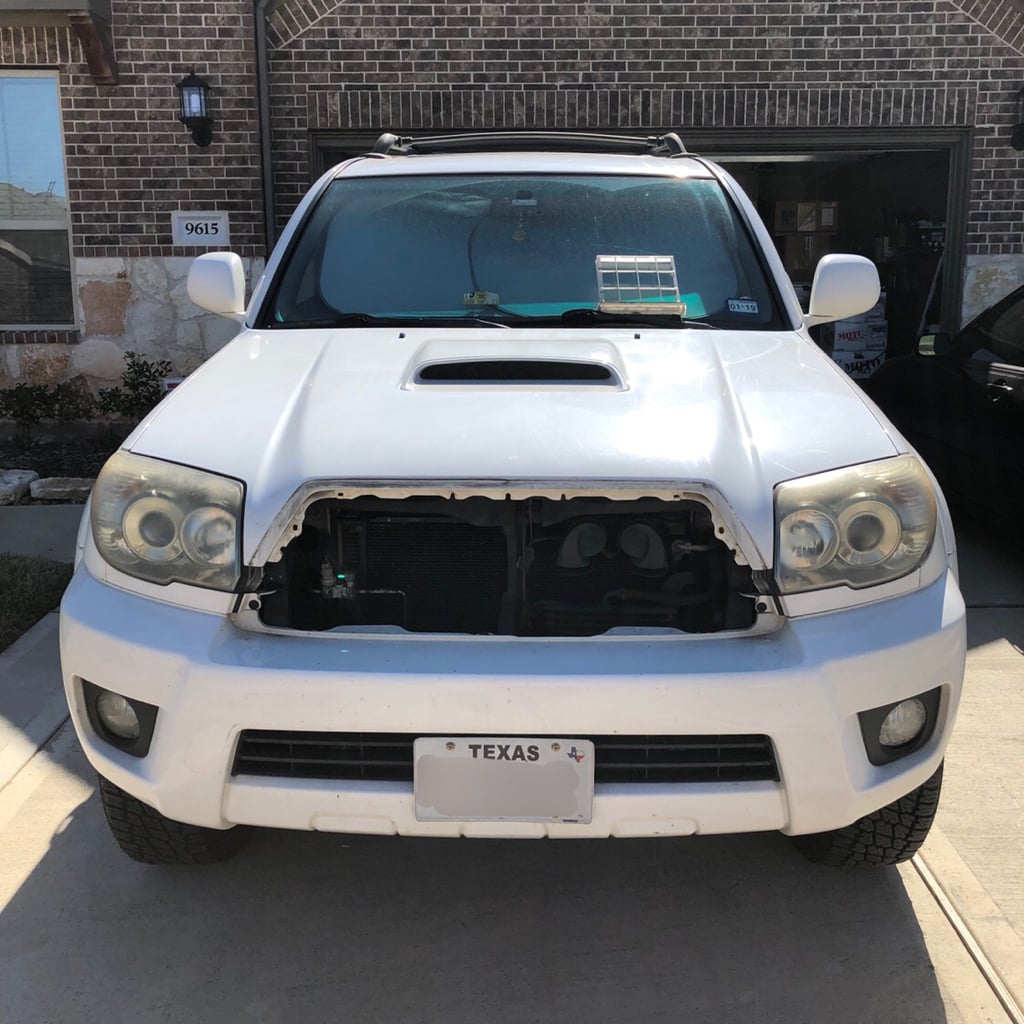

Had issues with about half the bolts, rusted from NE winters. Had to dismantle the grill to get the last bolt off.
Cleaned off about 11 years worth of crud afterwards. It did leave a slight black mark from the old gasket. I'll probably polish it off later this week.

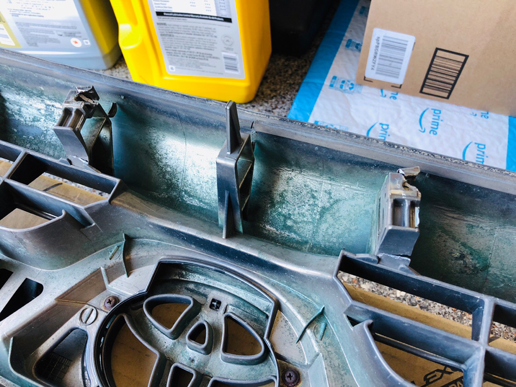

You can see the upper two brackets basically broke when I tried to remove the bolts. Two of the brackets holding in the metal frame also broke off. One of the nuts was rust welded on and ended up breaking the stud off.

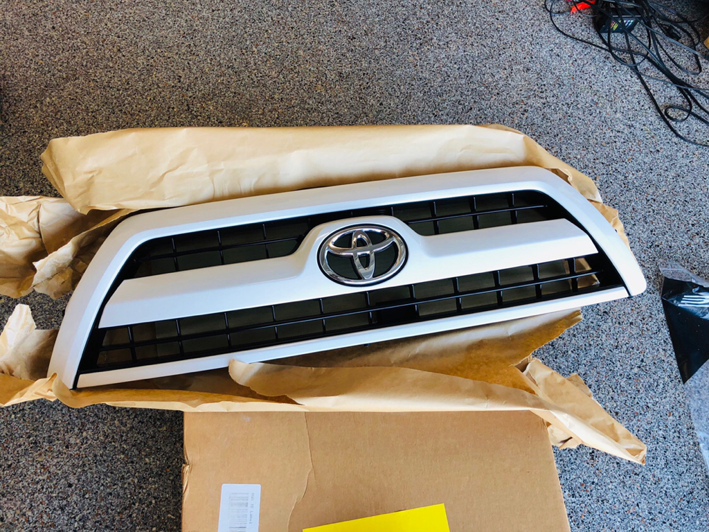

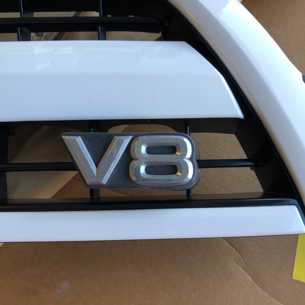

I had this factory new Limited grill sitting in a box in my garage for a whole year. Ordered it before I picked up my car last year but never opened the box. Luckily no damage, I doubt CamelBack Toyota would have allowed me to exchange it out if there were any issues.
The old V8 badge looks sort of faded against the brand new black grill.
I still need to hit up Lowes for new nuts.

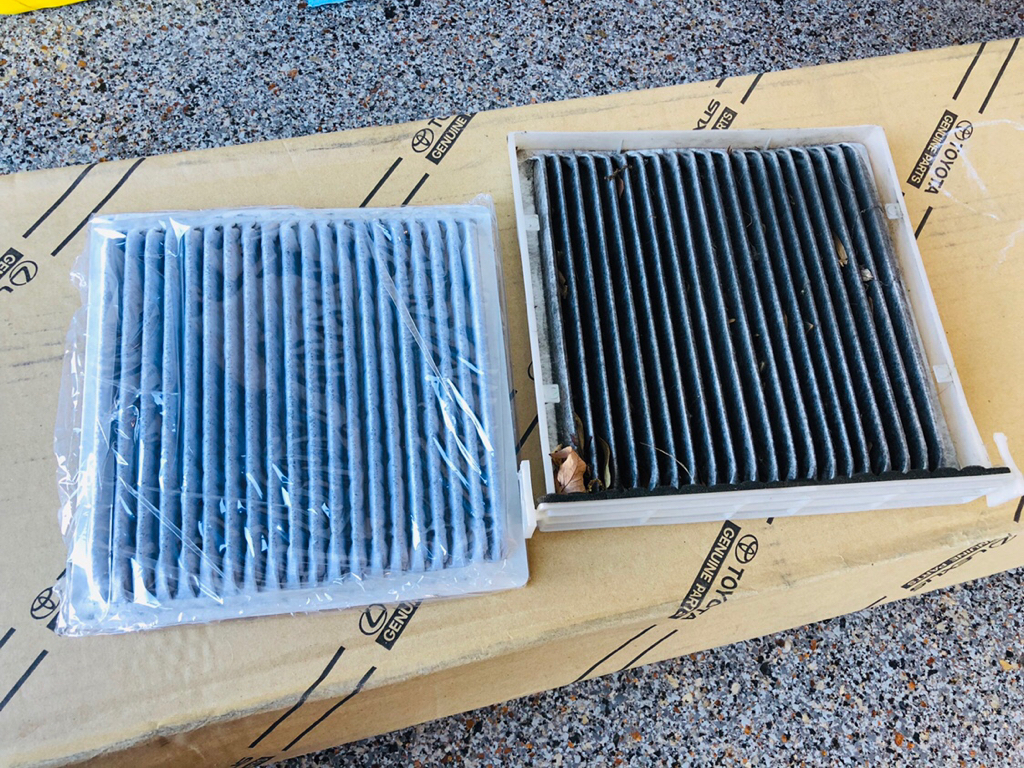

I also went ahead and replaced the cabin air filter. I probably shouldn't have been lazy about this...the filter has also been sitting in my garage for the past year.

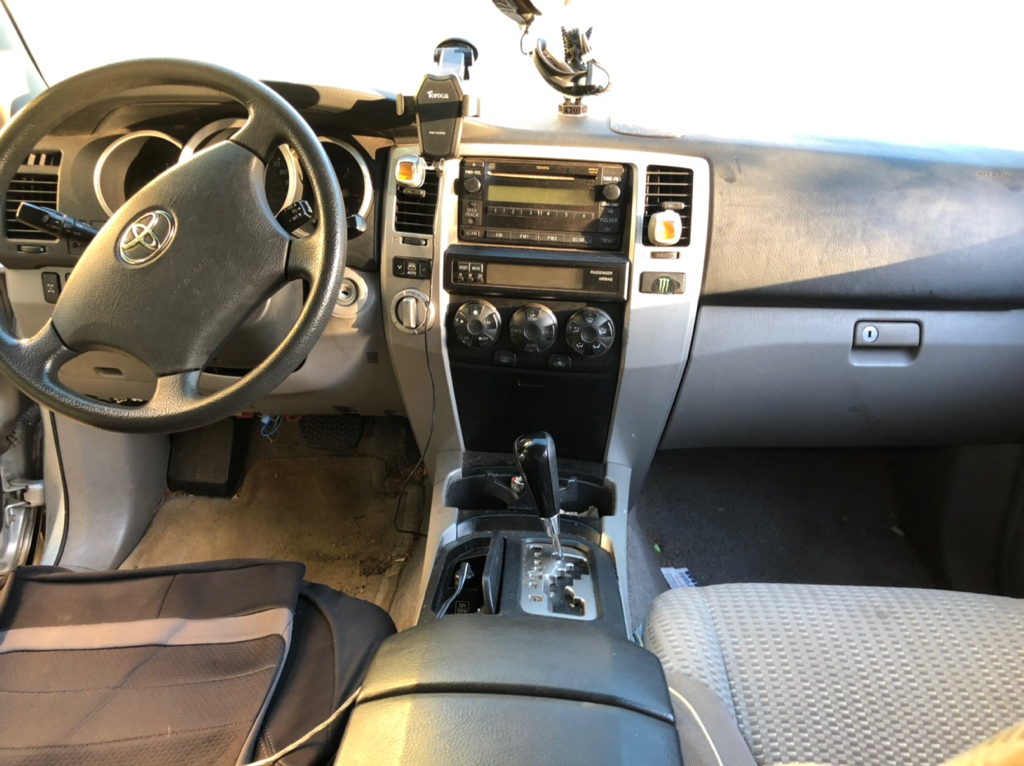

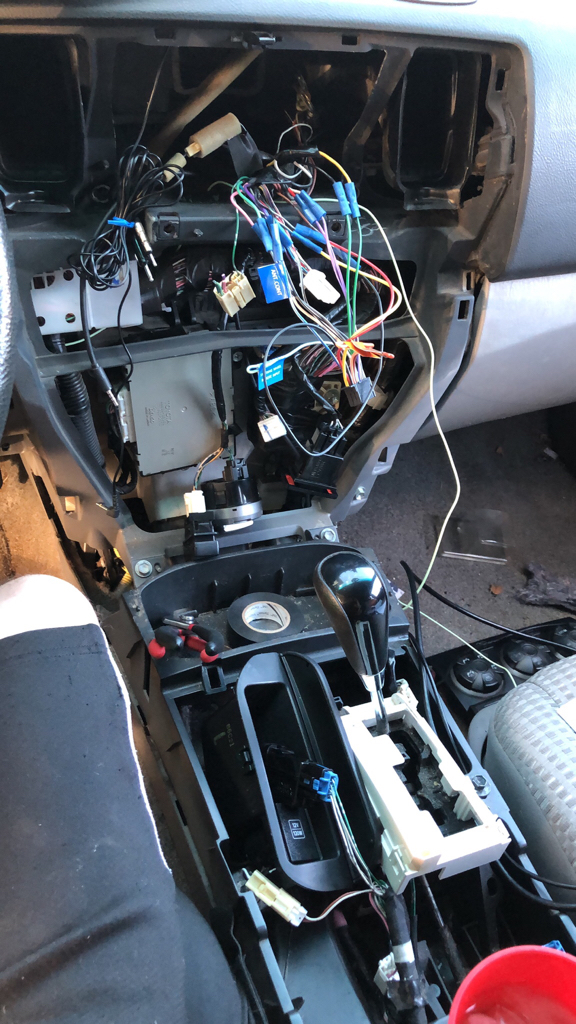

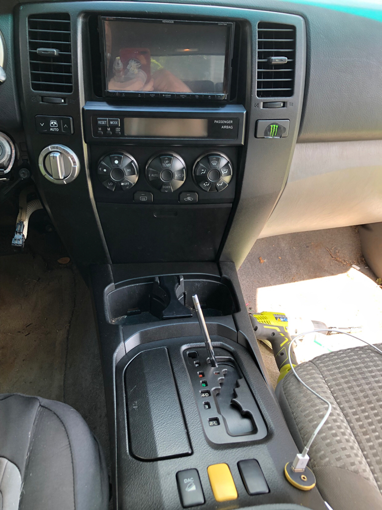

It took longer than a day, thanks to work and I’m kind of a procrastinator, but it came out pretty good. New head unit and some plastidip work. Now to see how long until I accidentally peel up the plastidip, lol.

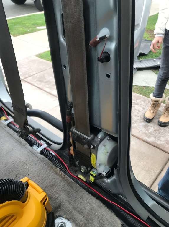

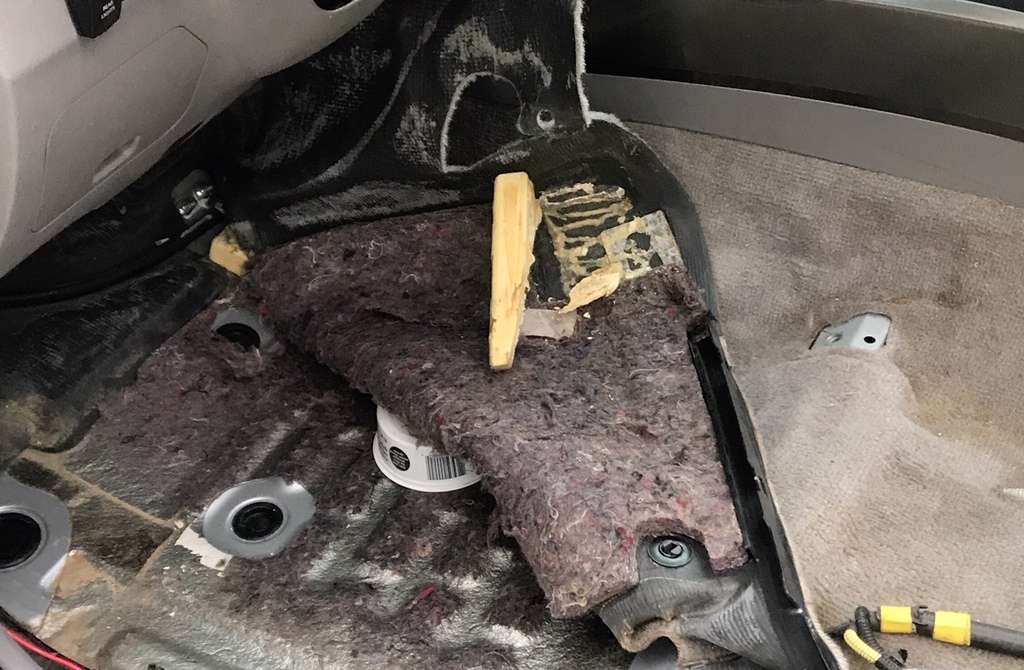

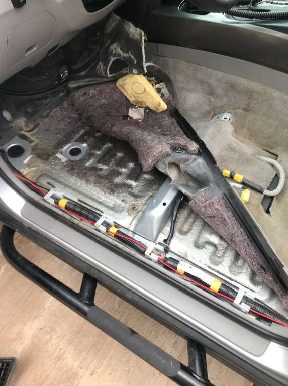

So last Thursday's torrential downpours revealed a leak in my 4Runner. My driver's side footwell was practically a puddle. (On a side note, I'm glad I put my ham radio in my center console and not under the seat.) I could not figure out where the leak was coming from. I checked the sun roof drains, but those were draining great.
So I got in the passenger seat and had my daughter hose things down, and when she hosed down the driver's side front mount for my Baja Rack water started coming down the B-pillar and was running along the side curtain air bag and down the A-pillar. Source found. While checking the mount, I found that the to bolts were loose as $3 TJ hookers. Apparently I must have forgotten to tighten them when I installed the rack. :frusty::doh:
I used a wet vac and rags to get as much water out as I could last night and today, the first sunny day we've had in weeks, I have all windows down and a heater and a fan blowing on the wet carpet and padding. Yay. So much for that desert trip I had planned.

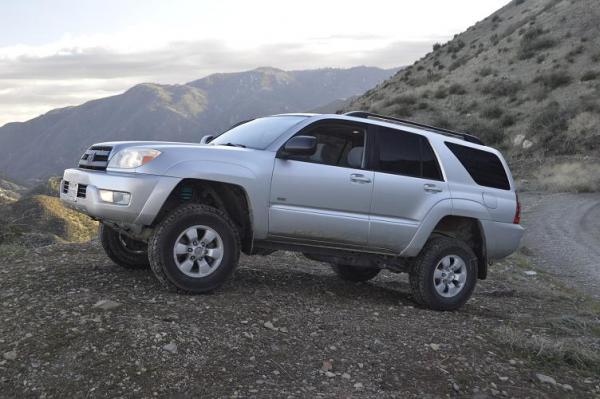

Not today but within the last couple of months. Dobinsons lift and UCA installed, deleted XREAS, 285/70/17 KO2's put on, 5th gen Trail wheels, limited grill installed, poly sway bar bushings and FJ sway bar links, HID and halos installed... been busy lol but my sport is finally how I like it.

3" Dobinsons coils up front and 2" coils in the rear, with 5100's all around. Dobinsons tubular UCA ... Nice stuff!
