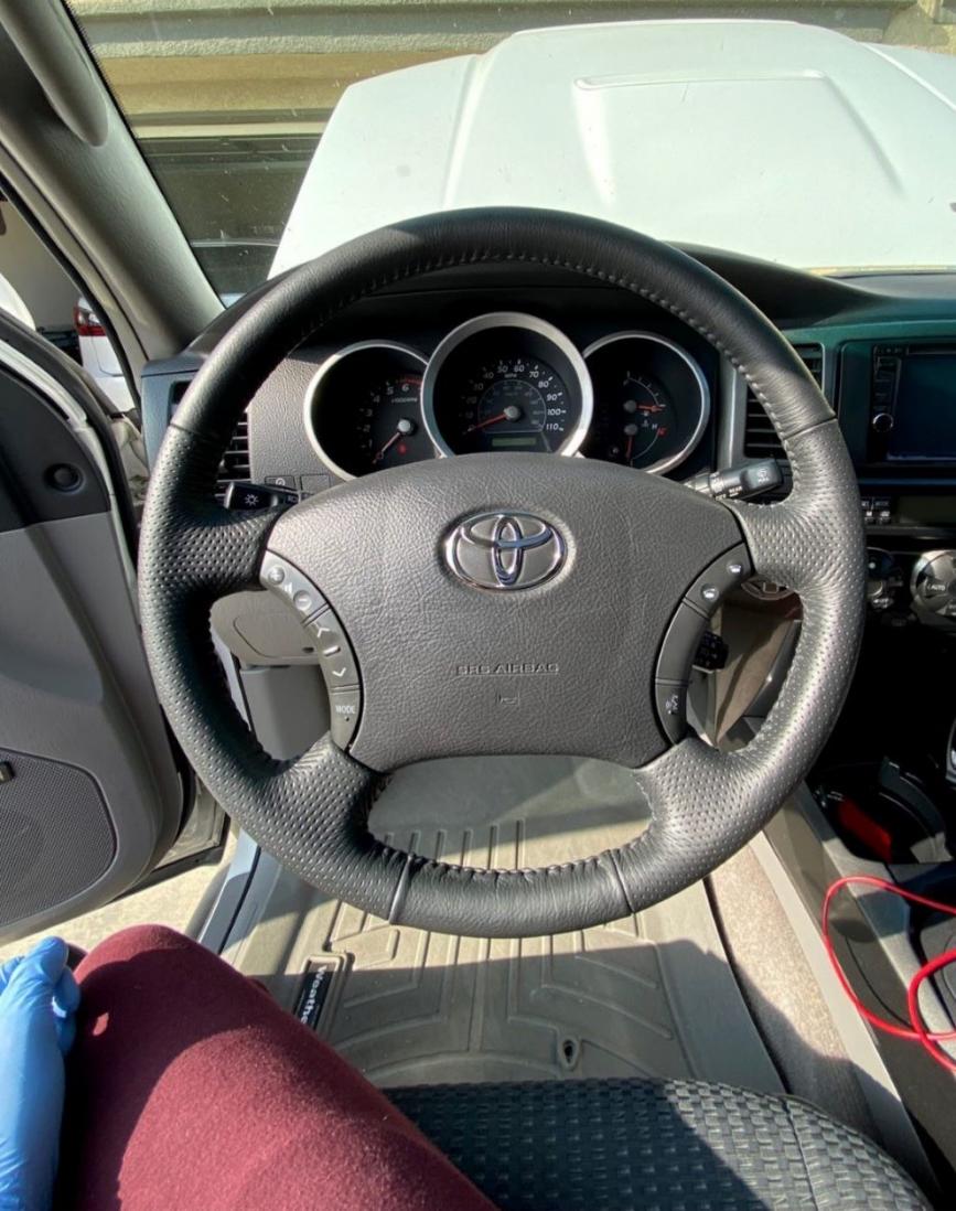

New Dimpled Leather Steering Wheel + added Phone Controls
-I had been wanting to upgrade my steering wheel for a while now and finally got around to it.
-I wanted to maintain an OEM feel. Since I was going to upgrade the steering wheel, I decided to also add phone controls.
Steering wheel purchase:
2006-2009 Toyota 4Runner Steering Wheel Black Dimpled Leather New 451000W210B0 | eBay
Phone control button + cable:
OEM Part Source | Genuine Toyota, Honda, Ford, BMW, MINI, GM, Mopar and VW Parts and Accessories | OEM Parts
Notes:
- I am not mechanically inclined at all, but been wanting to learn to do more of the work myself. If I can do this on my own, then anyone that can use a screw driver and wrench can as well. Only a total of about 5 screws & bolt combined to remove.
- I already had a Kenwood DDX73BT aftermarket stereo & the phone controls are working without any issues. The head unit is getting replaced this coming weekend with one that is robot and fruit compatible.
Install help:
Steering Wheel Swap on 4th Gen 4Runner
DIY Bluetooth/Voice Command steering wheel button install (pics)........for REAL - Toyota 4Runner Forum - Largest 4Runner Forum
2018 Tacomas steering wheel on 4th gen 4runner. - YouTube
Conclusion:
- Very happy with the new steering wheel. Feels great in the hand and feels much more premium.
- Glad I added the phone controls. Much easier to answer / end phone calls.

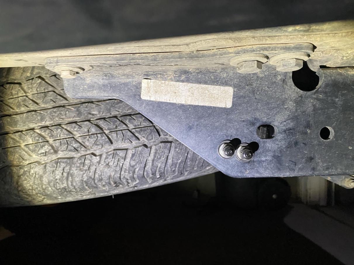

- Battery removal is not necessary to install the driver's side UCA. The clearance issue when sliding the long bolt forward comes down to fractions of an inch and involves 1) the bracket holding the cabling that goes to the positive side of the battery and 2) the tray itself. Just remove the 10mm bolt holding the bracket and swing it out of the way as shown in the pic below. Then undo the battery hold-downs and lift the battery & tray just a smidge and it will clear.

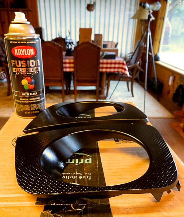

While waitin' on the arrival of bolt extraction tools, spiffied up fog light bezels that looked faded compared to the recently installed, similarly-painted grille.

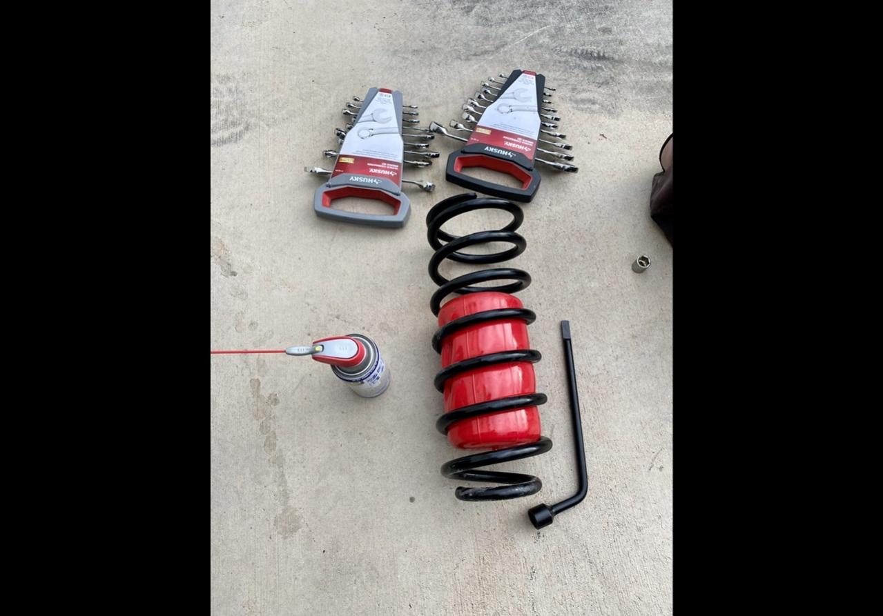

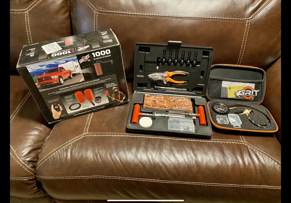

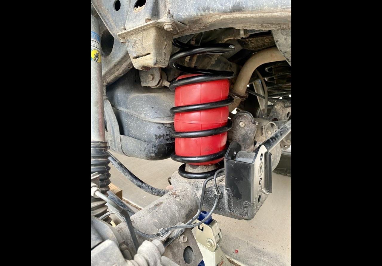

Airlift 1000 install
Received my Airlift 1000 air bag kit. Finally bought a tire deflator and a big tire plug kit for my soft side case.
Installed the Airlift tonight and put the Scrhader valves underneath on the outside of my aftermarket HD tow bar. Need to to order the Pneumadyne air valve to run them together or separate with the flip of a switch. Went with 8-1/2” bags, 2” longer than recommended for stock since it’s lifted.
I've had good luck with Airlift airbags. The last car I had them on I put the schrader valves behind the fuel door for easy access and less grime on them.
