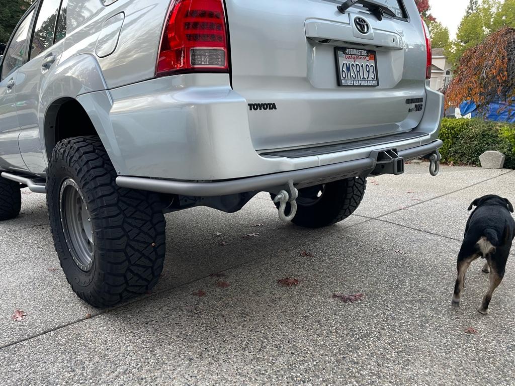

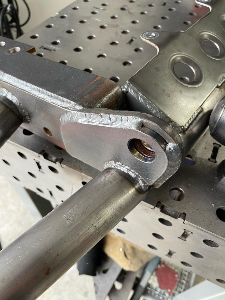

Getting real close on the rear bumper. Those unwelded spots are now welded.
Also added flutter stacks to all the shocks, definitely took the edge off all the small bumps. Found out the passenger front coilover was cavitated pretty bad so I’m glad I tore into it. Such a pain pulling those front shocks haha

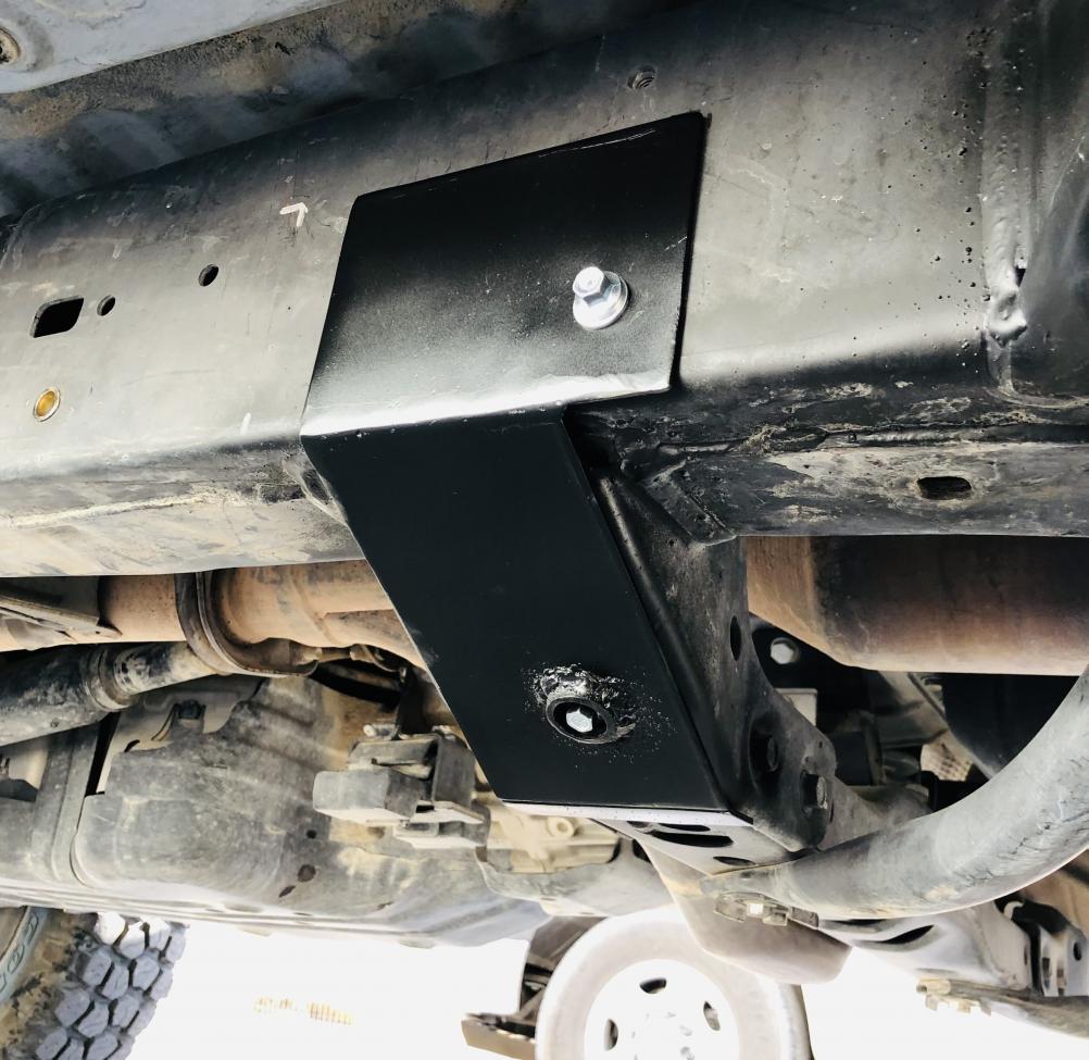

Started the preliminary stages of my sliders. I had some 1/8” x 4” flat steel and made a few of the bolt on frame plates. The front mounting points are done and include somewhat of a skid for the crossmember. I seem to hit this the most when wheeling. I still need to buy the tube but it’ll be some time before I can make it into Las Vegas to purchase it.
