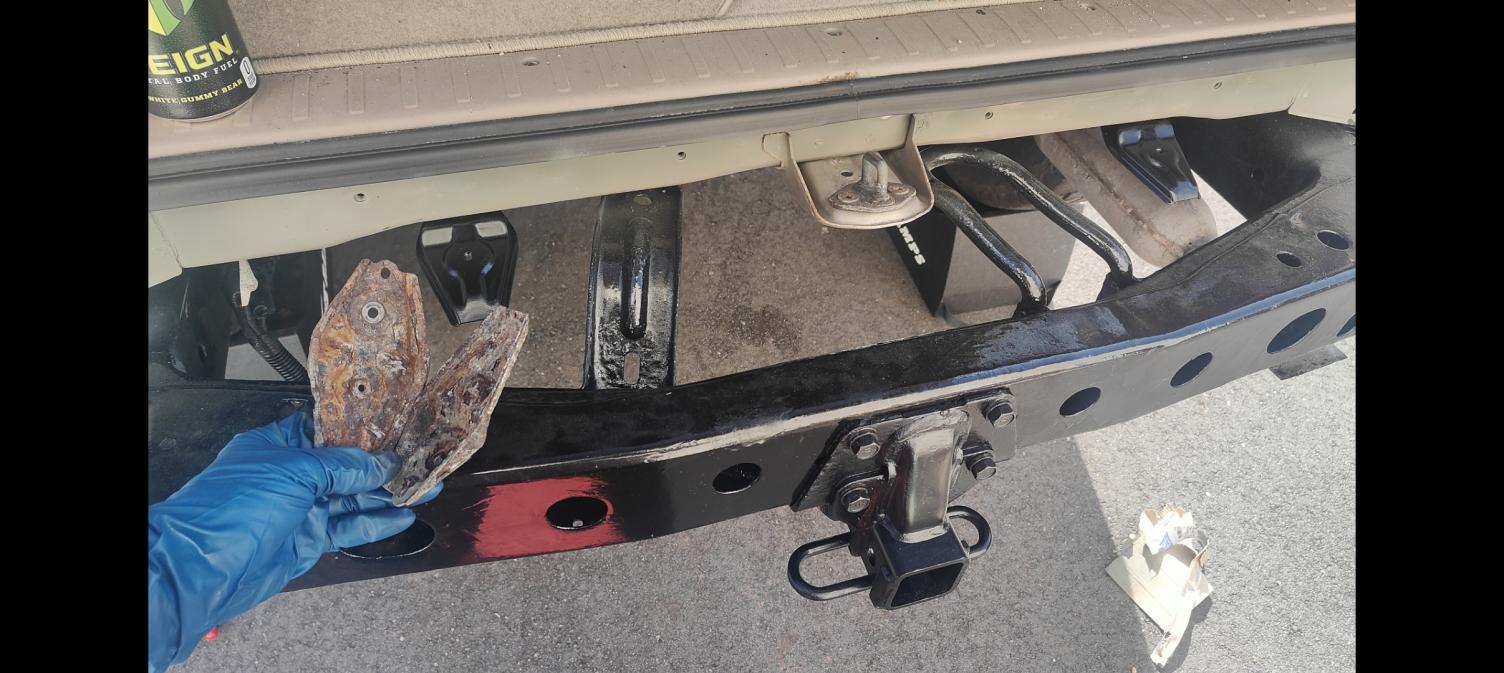

This is a little of what it was like.it doesnt look that bad but those little diamond piece were completely rotted, luckily it was blackfriday at mrT, and i got 2 for $30.

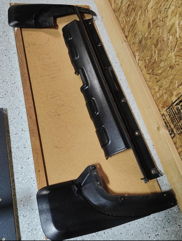

And actually today lol... Bed liner sprayed the center section of bumper skin and flaps , its going to clash bad with my toyota paint code - "sun bleached and laquer peeled dorado gold" .

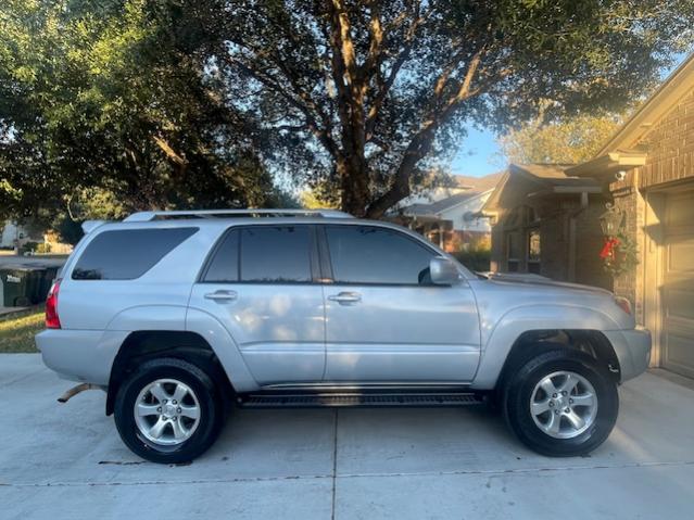

So, after 20 years and 8months, I finally had a head gasket failure. I bought this 4Runner new in late Feb 2005, and it's been my daily ever since...so many good memories, getting the front/top end rebuild was a no brainer. Here she is after I got it back from my mechanic all wash up and with a set of new Michelin Defender tires. Planning to keep this 4R running forever and not planning to buy a new 6th gen 4runner until my 50th birthday(I'm 47). I might treat it this spring with some new wheels:)

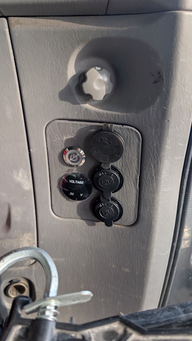

- Currently planning on disconnecting the rear 12v socket and creating a rear power panel. I purchased the wrong amperage power button and am currently waiting for a new higher rated button.

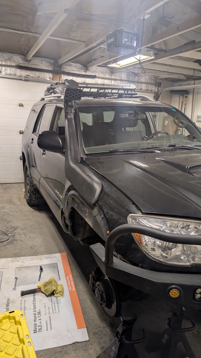

- Installed a LC100 snorkel, only to find out that I could have gotten a 4th gen specific one for an extra $20 had I searched a little harder.
