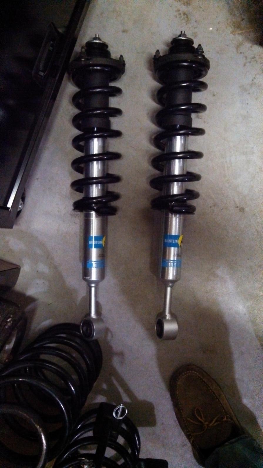

Purchased a pair of OME 2" heavier rate rear coils for the rear. 100% awesome. Took the daystar 1.5" spacers out of the rear and couldnt throw them suckers far enough away from me.
Then I raised the front Bilsteins to their max height adjustment. Again another awesome process. Set the toe and took her out for one of my faster technical WRC type of test track up in the base of the Las Vegas foothills. I found a perfect little test track. I used up the wheel travel nicely without slamming the bump stops. Front and rear this thing of beauty came to life. The extra spring rate in the rear really helped the overall handling and the weight transfer under hard acceleration and tight corners. And lets not forget some of the little rollers in the track I was able to roll across the tops, whereas before I couldnt even think about it, even with the Bilsteins front and rear.
Adjusting the fronts to the highest position was a no brainer. The little extra lift in addition to the slightly added preload on the front coils really woke this thing up.

Got any side shoots with the rear coils? Im trying to wait to lift the rear until I can get proper coils. I know Daystar would be the easy route but that is never the correct route. Does the rear still compress all the way when articulated? Right now I have my 5100s at 2.5 in front and stock in rear.
Hello Jackson. I did see witness marks on the rear housing indicating the rear coils used all compression travel. Also like I mentioned, when I did use all wheel travel front and rear, each time it was landing softly on the stops. I'm sure there will be those times when one has that "oh shit" moment when that big one sneaks up on ya. My goal obviously was to not treat this like a trophy truck or Robby Gordon ' s DAKAR Hummer. I did take a few pics. Will get those up soon. I will say, the rear sits a bit higher than the front. But remember, it was only me and no gear. With passengers and gear I believe I have found a perfect combination. With the body lines and the bit higher rear, it does look sporty and not boring.

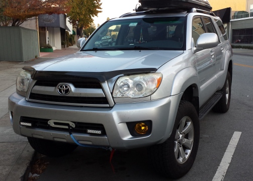

Finished install of Yellow Winjet fog lights, 6" LED work lights, and the biggie, hidden Engo E10000S.
