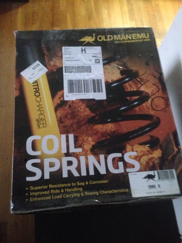

Got these beauties delivered today. Shocks should be delivered soon and then I'll be impatiently waiting time off from work to do the install
