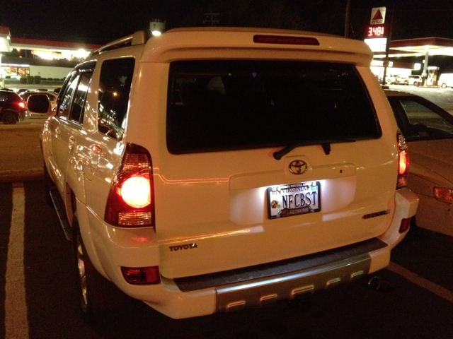

Today, I finished the Interior LED bulb swap, and I also replaced the rear license plate illumination bulbs, and I must admit they do look cool.

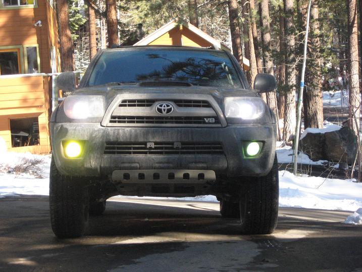

Installed my valentines day present from the GF. DDMtuning 3000k 35w HID fog lights.
