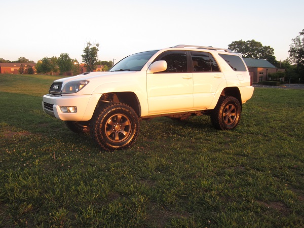

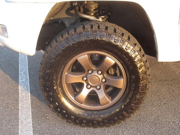

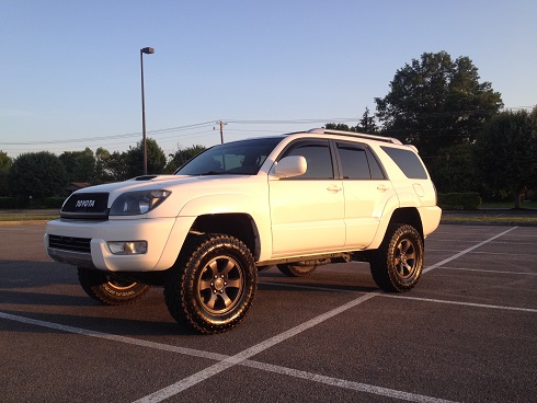

Here they are, with a point and shoot, wish I had a nice camera
Color looks good!
thank you
Nice job, I think it looks great and then it will look better once you paint the rest of the stuff.
I know I need to get the rest of it bad, working on it. Fender wells need it bad, should have done that before the shots, oh well
Looks great! Where'd you pick up the color? Reminds me of the color my old wheels were before the PC faded. Also waiting on the full shot.
Thanks man! Home Depot or Lowes have it. I need a pro photographer to take shots, come on up!
Link to paint Rust-Oleum Universal 12 oz. All Surface Forged Hammered Burnished Amber Spray Paint and Primer in One-271480 at The Home Depot
BTW, my 10 year old Step son picked the color, I was going to go with the Grey I had before.
I do like the color, it really changes depending on light.

Did you do a light sanding before application or will this go on like Plastidip with a little cleaning?
thank you
Looks good!!
Good question, I took wheels and tires off, degreaser cleaning and brushing all really well. I did 4 coats of black plasti dip on each wheel, almost a full can on each. Let dry 20 mins between coats! Then did roughly 3-4 coats of the paint on each wheels, 10-20 min dry time there as well, removed the index cards that were stuffed between wheel and tire (so no dip or paint on tire), let sit over night and installed today! Ran exact same thing with different color for 2 years!
No sanding or anything clean/dry/spray/dry/spray/dry/spray and so on/done/install ENJOY
