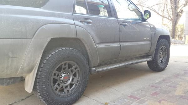

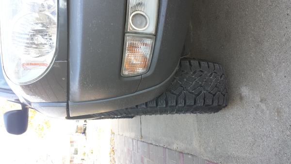

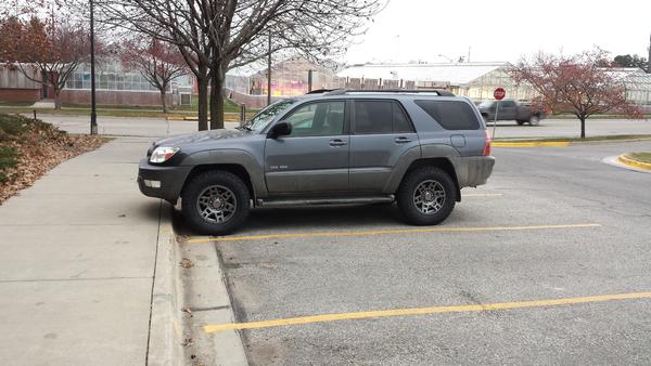

Got my wheels and tires mounted and installed.
I now have a slight rub at the back of the fender well on the right side.. not sure if I'll go up a notch on the 5100's or hope the alignment fixes it.
Nice looking ride!
What size wheels / tires did you put on?
Everything else is stock?

The wheels are 17" TRD Pro's. The tires are 265/70 Duratrac's. The rear suspension just has 5100's. The front is FJ springs with 5100's on 0 setting. Think I might go up to the .85 setting to eliminate the rubbing.
