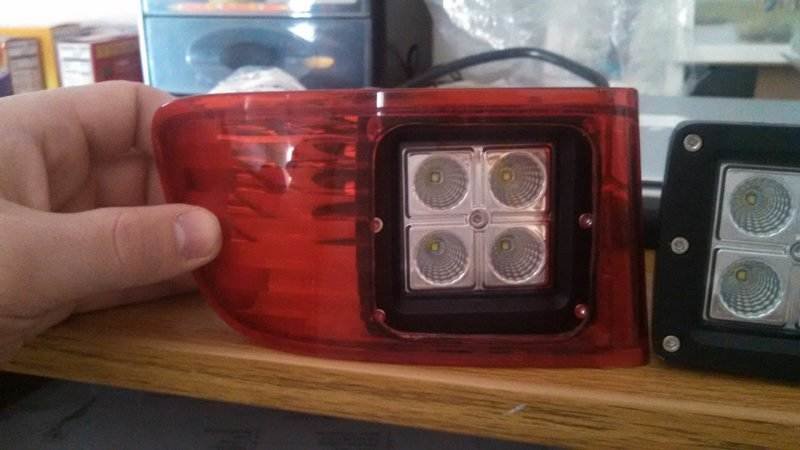

as i promised....
the lights and already trimmed reflectors courtesy of [MENTION=165]momo.75[/MENTION]
img_20150120_133224_359-jpg.1313
nice!! i've been wanting to do a similar project. keep us updated, may have to use a few of your ideas.

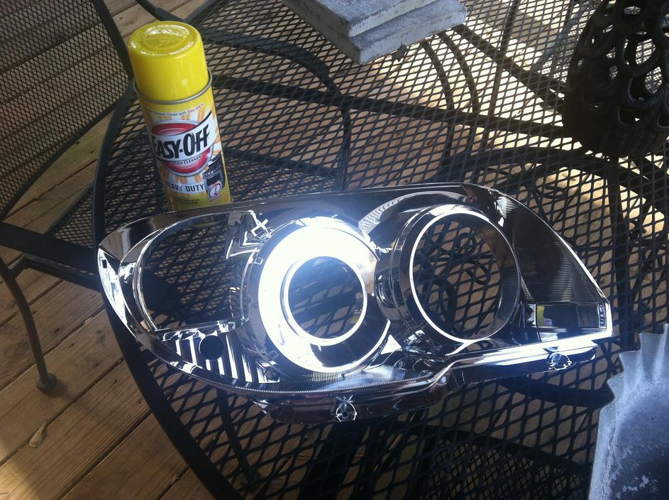

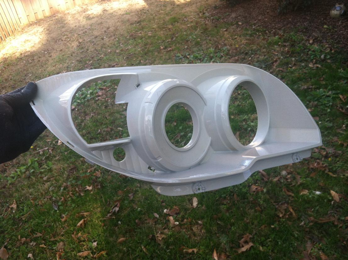

so you just use easy off and it strips all the OEM chrome? then wash with dawn and ready to go?
Yep, the Easy Off starts eating the chrome as soon as you spray it on there. I usually let it sit on there for about 10 minutes and then rinse it off with a hose to get the majority of the crud off. Then i take them in and wash with dish washing liquid. If you do this you have to do it outside. It is very caustic but works great!
