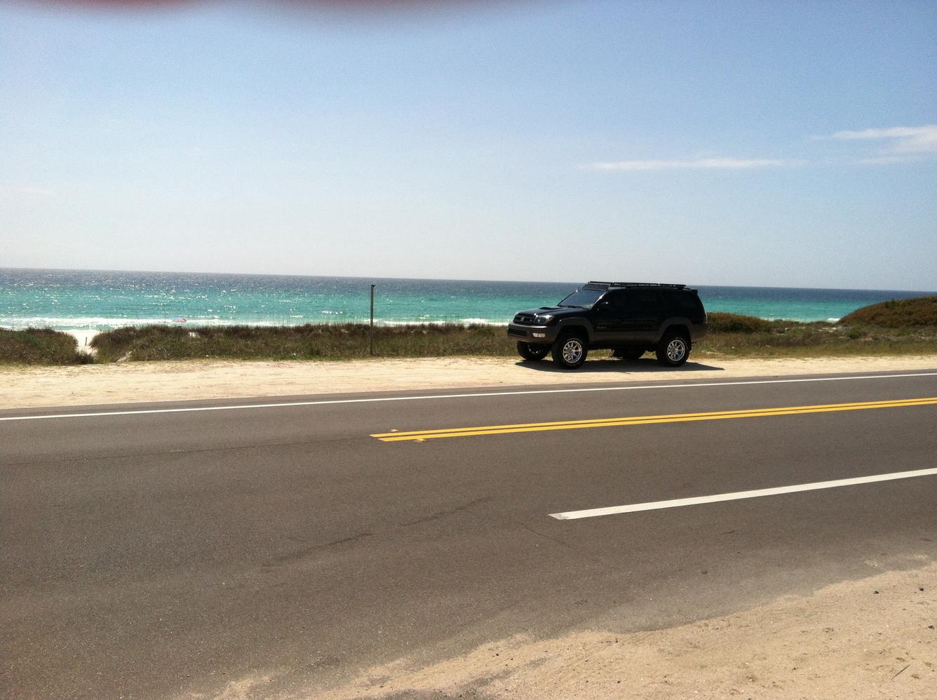

Brought the family to Florida for a much needed vacation
