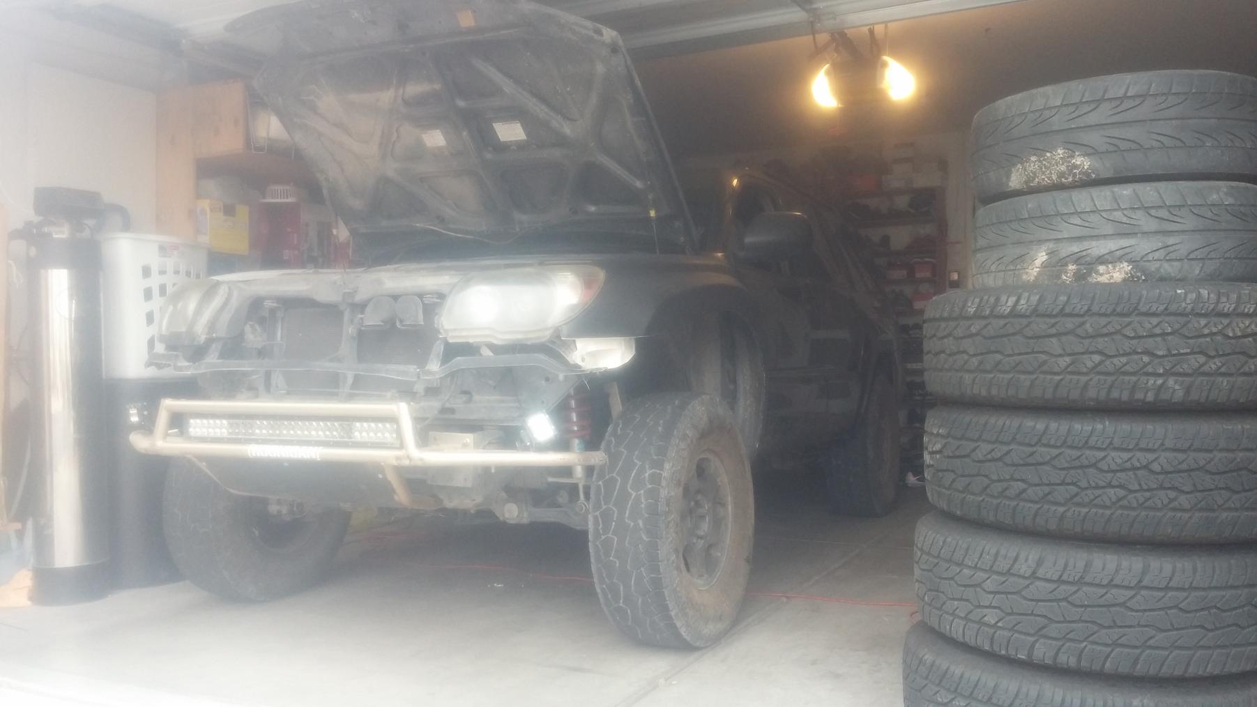

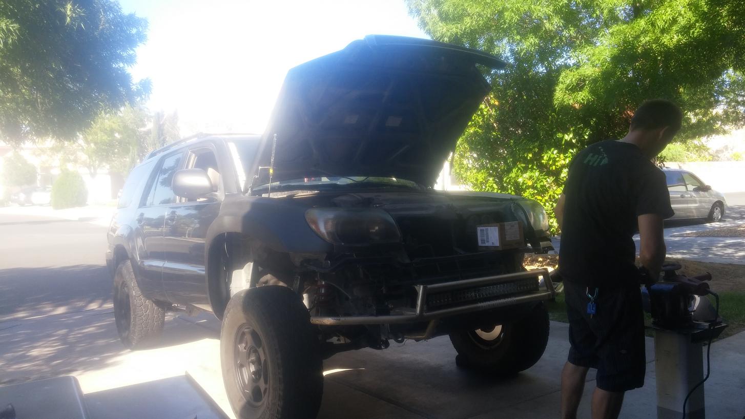

Fixed the mounts on my pods for my bumper. Went trailing last week and hit a jump too fast and the mount broke off.

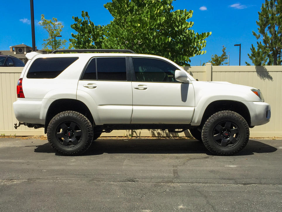

Never got around to posting but last weekend I put in 5100s all around front raised set on 2.5". Threw in some Moog FJ coils, brand new no miles. And the rear 1.5" daystar spacers. Also put on some new raybestos rear rotors and pads did the custom rear sway bars everyone seems to love, and changed the oil and discovered I have a leaking CV boot. I'm so sick of mechanical work after this past weekend I'm trying to just not even think about changing them.
Surely it wouldn't be a big deal to wait until next month or so fix that stuff, correct?
Oh, in case anyone was curious. 200 miles later I gained lift of 3" front and 3.5" rear.
My tires look really small now too (265/70/17). Maybe spidertraxx will make them look a little better

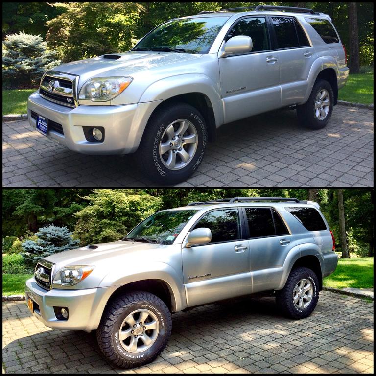

Swapped my 1/4" spacer for a 1/2" one up front. Leveled it out quite a bit. With the no compression method I can now get strut assemblies out and back in in about 35 minutes a side. Tried stacking them at first but it was a little much - I could hear it maxing out my UCA's over bumps.

Dusted off my trusty Nikon D7000 and took some quality shots of my 4R. Got new black housing headlights and a set of 285/70/17 BFG KO2s. Loving them so far!
Changed engine oil to signature series amsoil, changed air filter, cabin filter and removed hcf.
