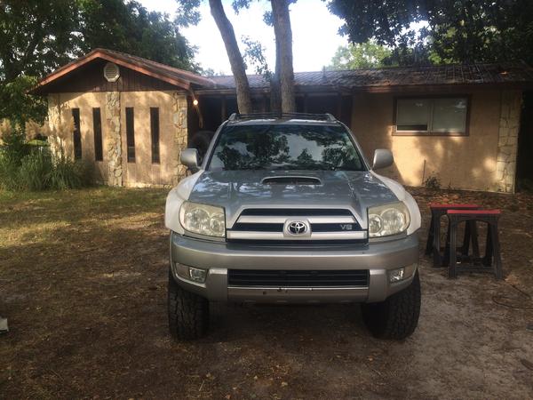

I started cleaning out all the junk that has accumulated in it over the summer. I'm anticipating I will start doing a more thorough cleaning this weekend to get it ready to list for sale. I'm happy to be staying in the Toyota family even though I will miss some of the features of the T4R compared to the Tacoma. 4WD and an actual bed are some good positives though.

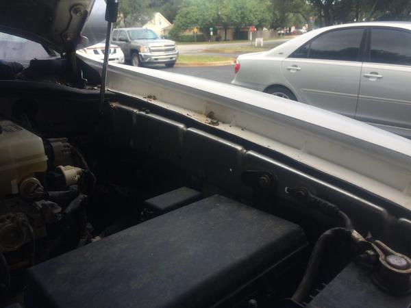

The driver's side: the mounting area that goes under the hood was bent upwards a bit (actually cracked a little torquing down bolts to get it to lay flat),

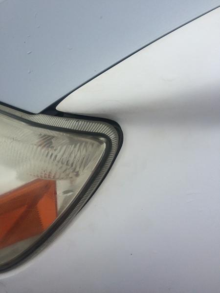

I have a pretty good gap at the headlight,

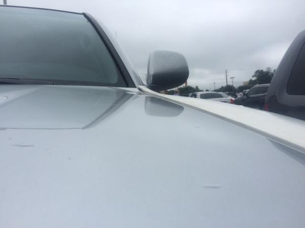

and the fender sits higher than the hood.

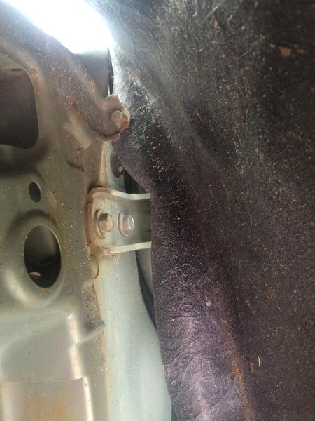

it sounds like if I can move it around a little and line up the light first and work backward to make the rest of the tabs fit better, it should fix some of the issues... may mean bending the tab on the inside near the door jamb (This guy: ),

Yours are exactly the same as mine. I just had to deal with it. Got the lines tight and I had to bend the inside mount out a bit on mine to fit properly.
Other than that. Same shit as me I've just learned to deal with it. Barely noticeable to the outside world and i barely notice it now.
