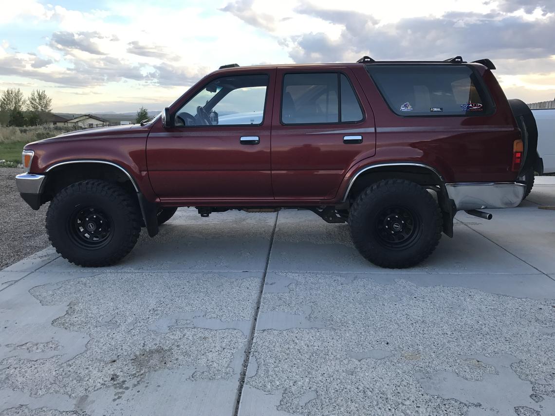

Installed all new shocks and Moog coils. As well as new black
Steelies and some 31" bfg's
