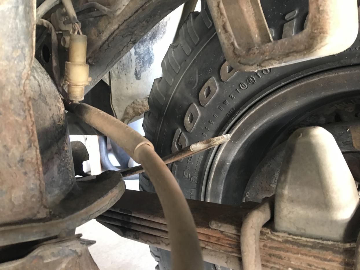

Was poking around under truck removing the spare tire carrier and noticed this...on both sides! Don't know how I didn't notice sooner but the only time I drive it is to go wheelin
That's why leafs have so many layers duhhhh redundancy for just such an instance.
Kidding... Should probably fix that at some point.

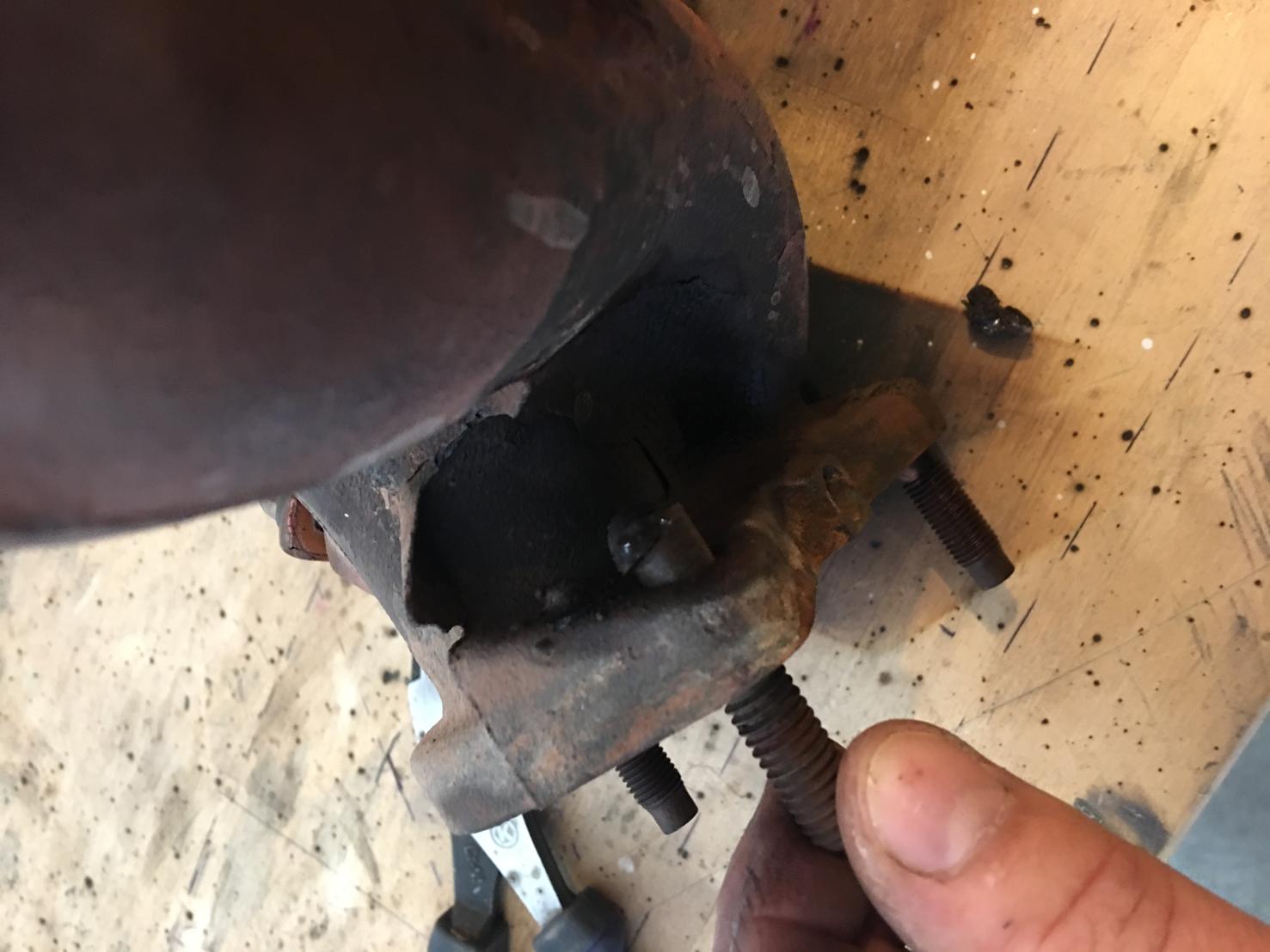

So I've been chasing a exhaust leak for quite some time. I replaced the gasket and it helped, but still had a leak. So my first thought the manifold is warped, great. I pull it off to inspect and look what I found...what in the f@@$?!
Some one had attempted to weld a cut-off bolt to the bottom of the manifold and failed miserably. So now about to finish buttoning up the new one.
