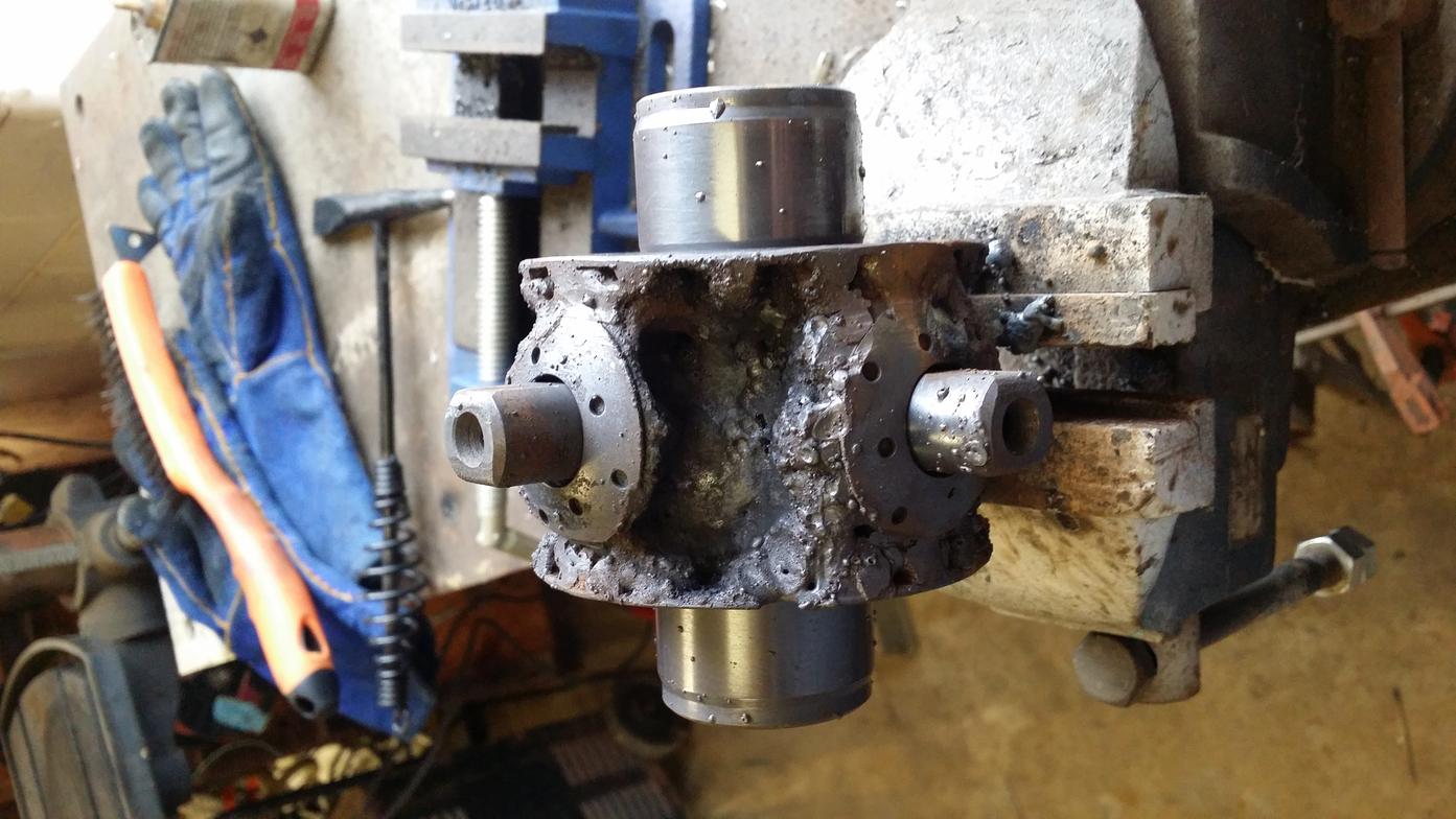

Got my 4 pinion diff welded up. The 4 pinion is a hit more of a job to weld than the 2, but that's what I've got. I split the carrier and tacked the exposed side together, then pulled the spider and side gear out, flipped it so the tacked side was down and tacked the 2nd side. Did what I could with my off brand mig welder, and took it to my work and really worked it over with the big Lincoln stick beast they have. Used about 12 6011 rods on it. Ugly as sin, but I think (hope) it'll do.
Got 3rd member back together today. Pretty sure the R and P are set up decent. I don't have a dial indicator, but there's just a tiny bit of free travel and the carrier bearings are snugged down pretty good. This is a dedicated trail runner, so no highway speeds in its future. Should be ok, dontcha think?

Well I'm sure you'll fill us in... Just please don't use the same level of precision if you get a job with NASA. Hahaha totally messing. Looks like it'll hold up. Even if the welds snap, there's no more teeth to turn anyway
