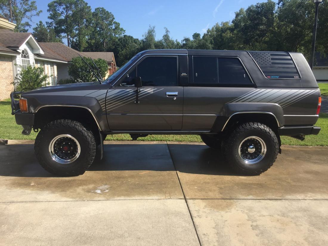

Had Cat replaced and some exhaust repairs.
Cleaned her up, rides like a dream now.
