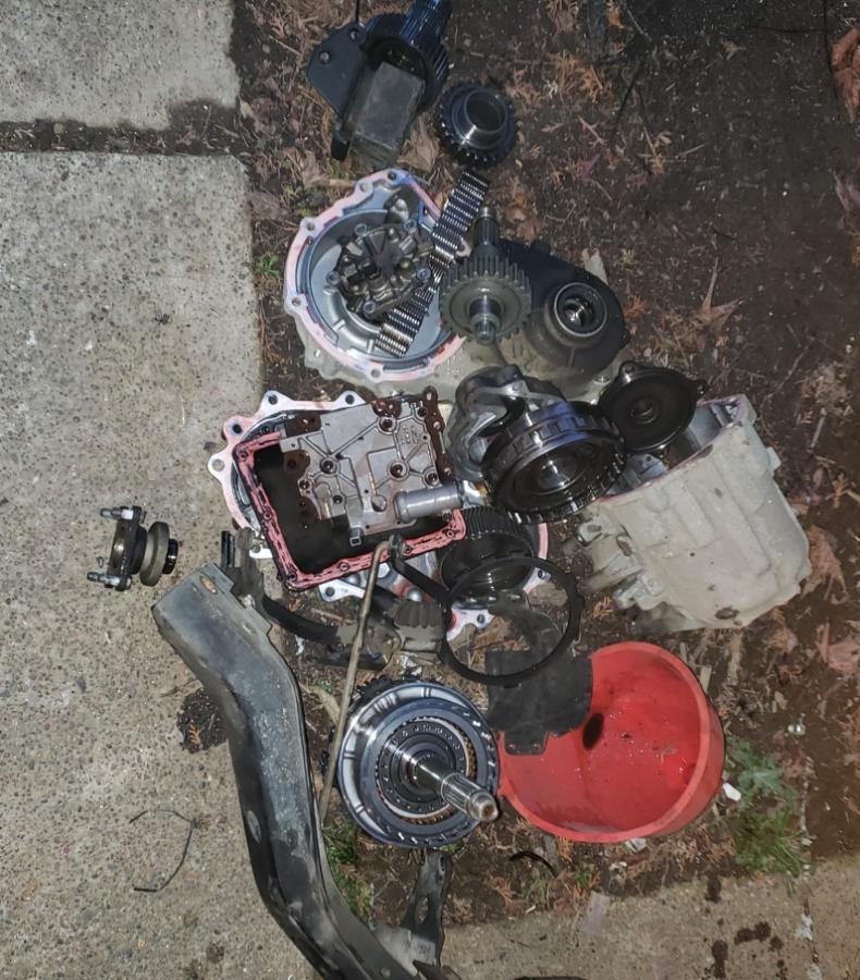

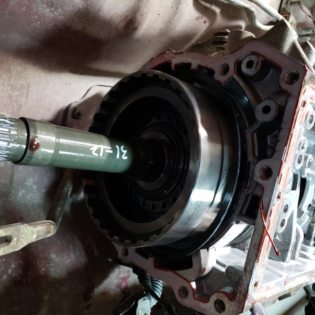

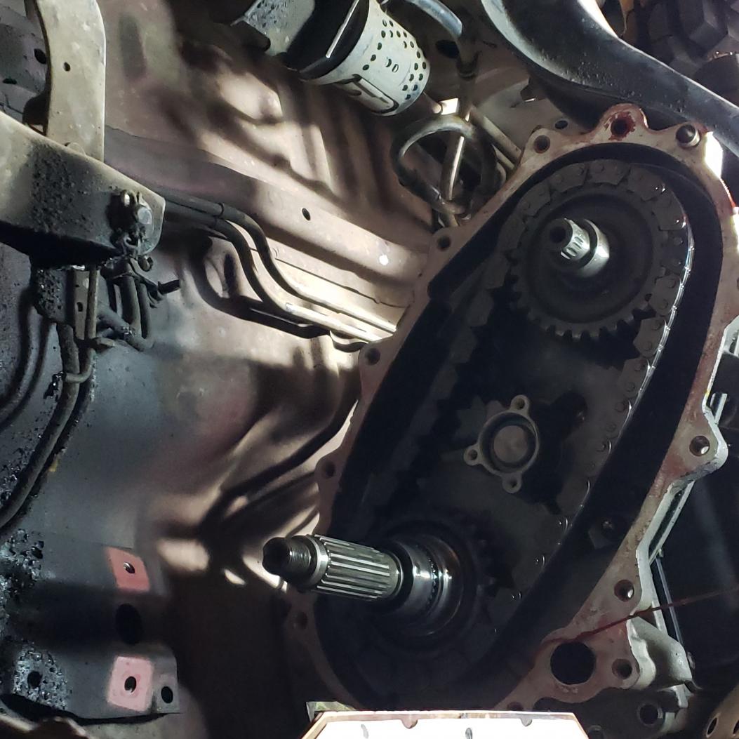

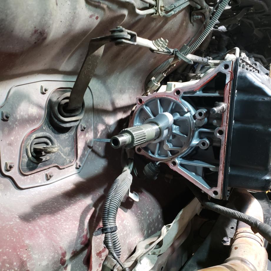

A340 auto to geared transfer case conversion
Finished up the tear down for converting my A340 auto to geared dual transfer cases
I think the duals will actually be lighter

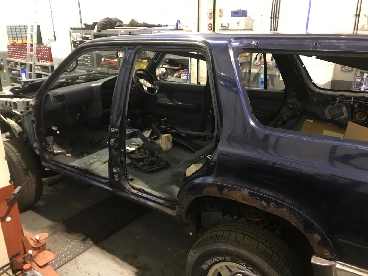

Made a bit more progress on stripping mine down before I start attacking the rust.

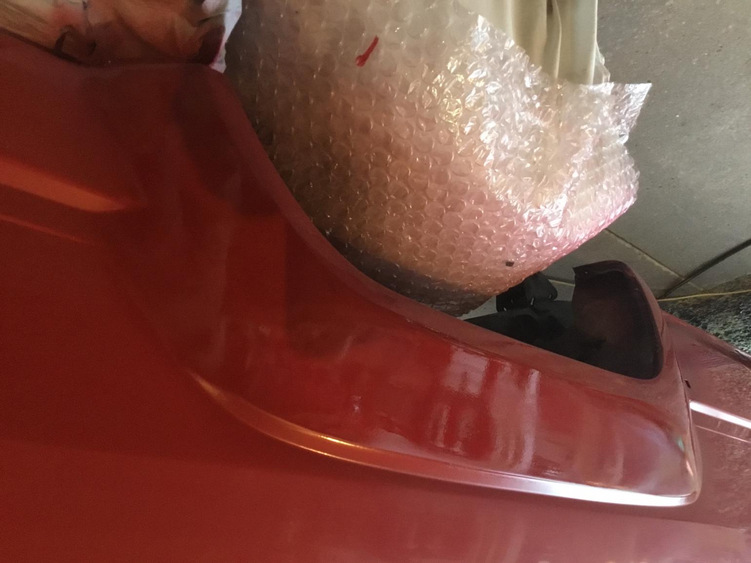

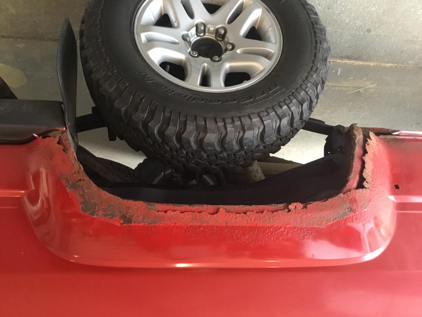

I also went from rusty to not rusty:
