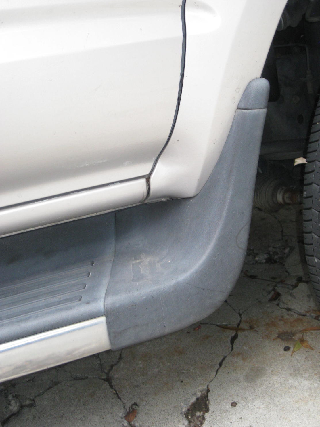

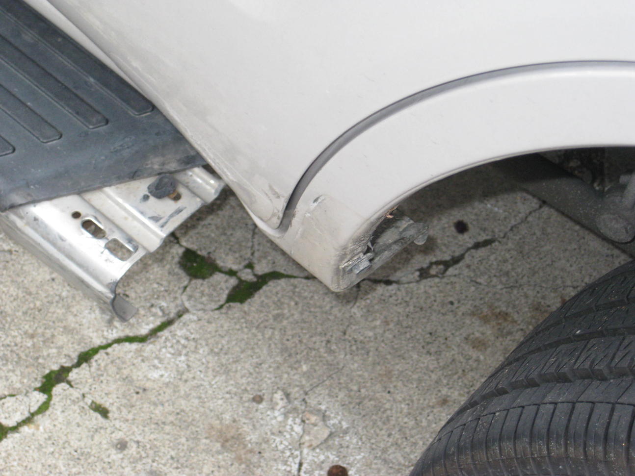

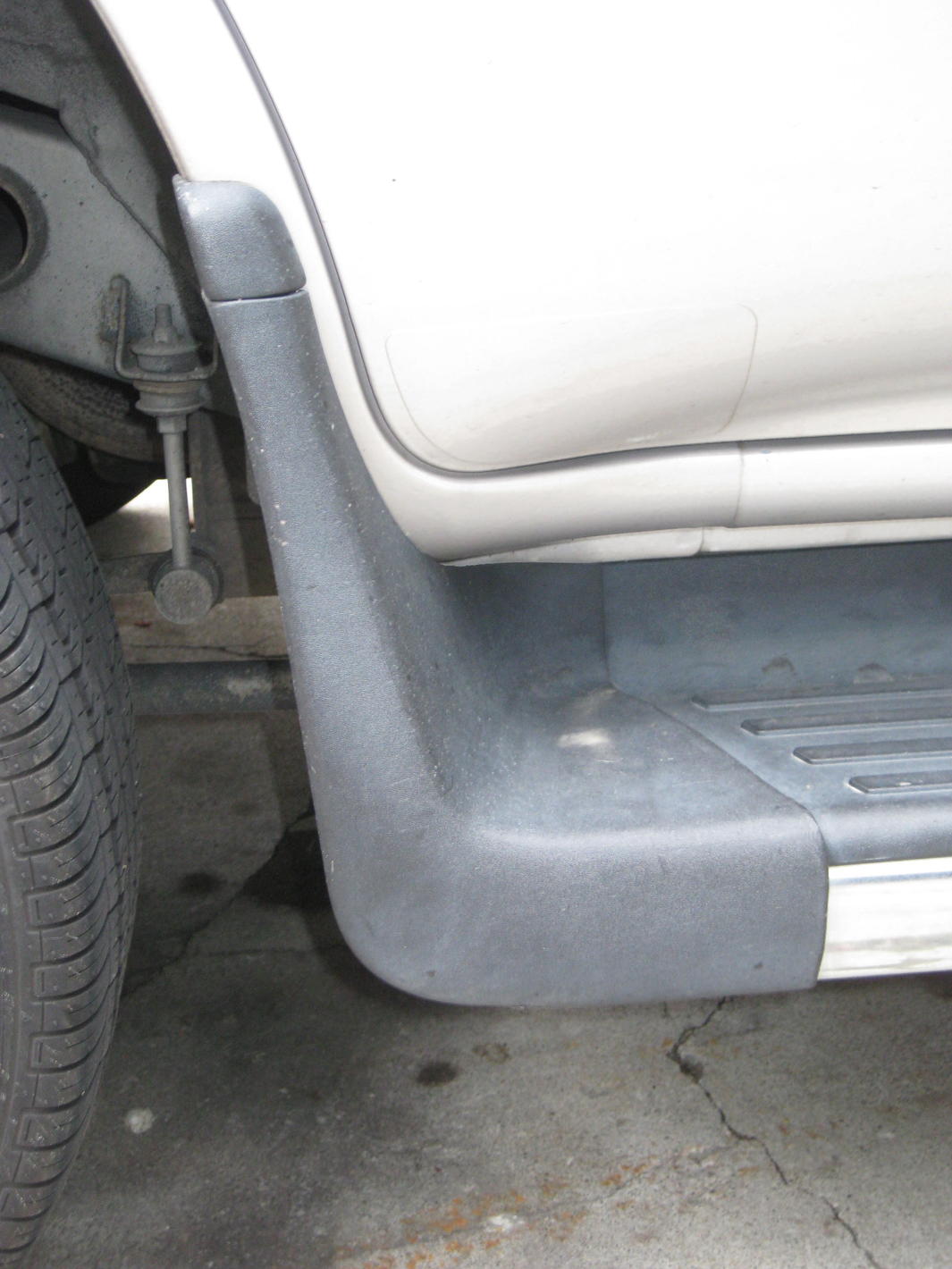

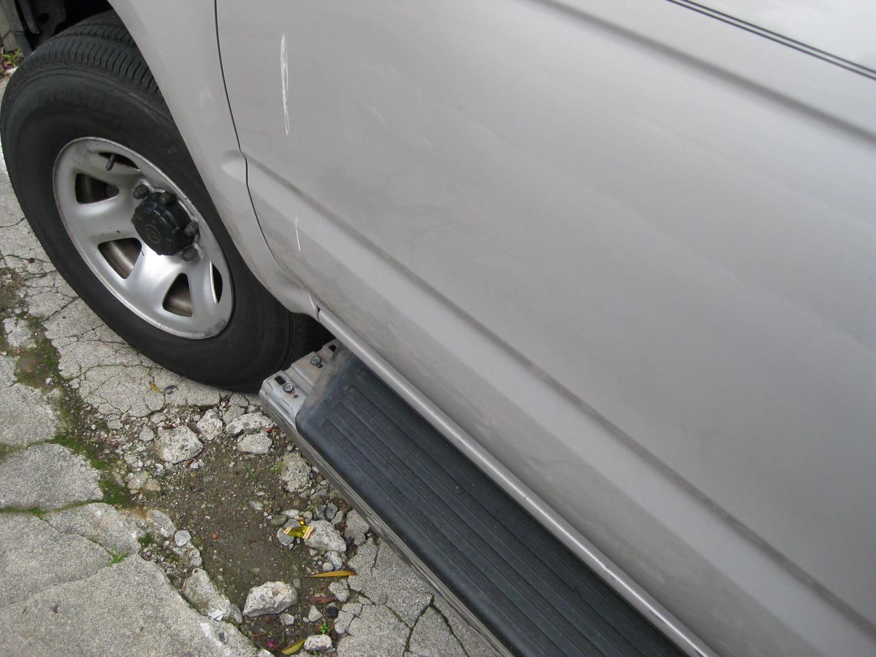

What do you call this and where do I get it cheaper than at the dealer?
honigsusi7
Hi all,
Pictures attached!
some *******s had fun demolishing my mudflaps - or are they splashguards? So much for parking at public trans after dark in Oakland, CA! Anyhow, the guy at Kragen ordered the wrong splashguards and before I go to the dealer I want to know if I can just order these parts cheaper online. So what exactly are they called and where can I order them?
Thanks,
Susi

thats part of the running board...
when someone took or tried to take the running boards off, they probably thought that they could remove that portion and you cant...
I dont think the dealer would sell that and it would be really tricky to get one off another 4runner without ripping it as the black plastic is literally attatched (glued,Melted) onto the grommets that you see
I tore part of mine taking them off and stopped immediately to figure out what was up.
I think this might be what you need, but without a pic I would make a telephone call to confirm. Running board end cap.
Toyota Parts Cheap.com
Also, search through the classifieds on this forum and yotatech. People are often selling running boards cheaply, so you could easily pick up something you need there for a good price.
I live a few hours south in Templeton and have some friends coming from Hayward this weekend. If you get back to me in time, I'll send the end caps back with my friends. Then you won't have to pay for any parts. Send a pm with your phone # and we can work it out.
