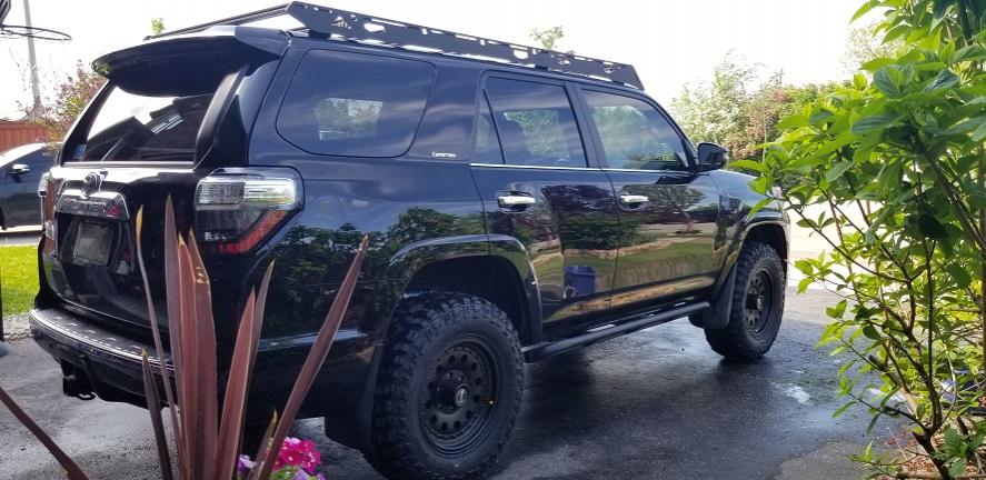

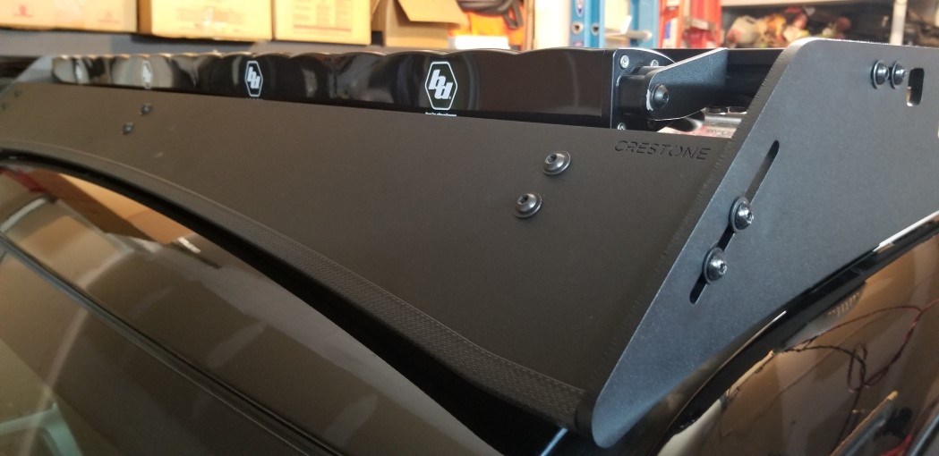

Have Sherpa Crestone. To date i like it alot. Very functional with add on areas with T bars. Side grip bars are nice and sturdy. Have light bar on it. Really nothing I dont like about it.
