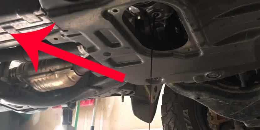

So with my mind elsewhere today, of course I do an oil change and drain the wrong damn pan! First i think, why is the oil coming out Purple? Then I think, thats no where near 6.5qt that came out of that pan. Ah, now i recall i have to take a damn plate off to get to the oil pan drain which i've done a 100 fuc@ing times before. $#@
ANYWAY, in the pic attached, what is the pan with the red arrow pointing to that I drained?

That's your transmission pan. If you were able to catch the ATF as it drained, you can measure and put back the same amount. Might be a good time to check the fluid too (check for color, burnt smell, etc). To be safe/thorough, make sure to do a fluid level check at the proper temp to make sure you're not under/over filled.

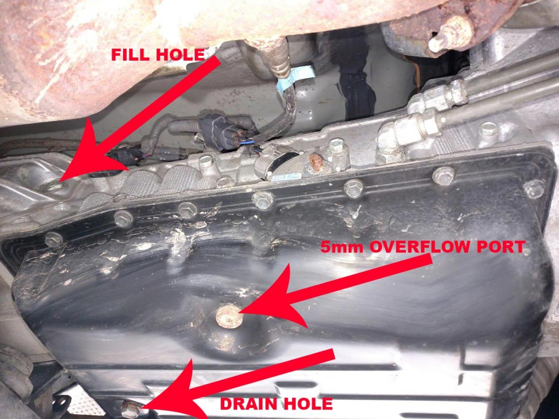

So a bit under 3.25qt came out of the Drain Hole (pic)... after reading through some articles I've gathered the following procedure:
-make sure the pan is perfectly level
-add 3.5qt (.25qt more then came out) in the Fill Hole (pic) of TOYOTA ATF WS fluid
-connect Techstream
-start the engine and move from P to D a few times to get the temp up to between 104-113F
-then while the engine is running, use a 5mm allen wrench and slightly unscrew the Overflow Plug (pic) and let any oil drain out, once it starts to drop, close it back up.
Does this sound about right?
Note 1: I also read that another option because i'm at 125k is to remove the pan completely, and clean the screen... then replace pan with a new gasket, and fill with the same above procedure.
Note 2: Then in another thread, they say to just drain the pan and refill like the procedure above, 3-4 times at 100 mile intervals to thin out the oil tranny fluid because their a full 12qt. in there. WTF?
Also, in the pic, is the arrow with the Fill Hole, correct? I can't find any pics of the damn bolt for the fill hole anywhere so I assume this is it.

you have them marked correctly in the pics. Keep in mind that if you dont want to do it
