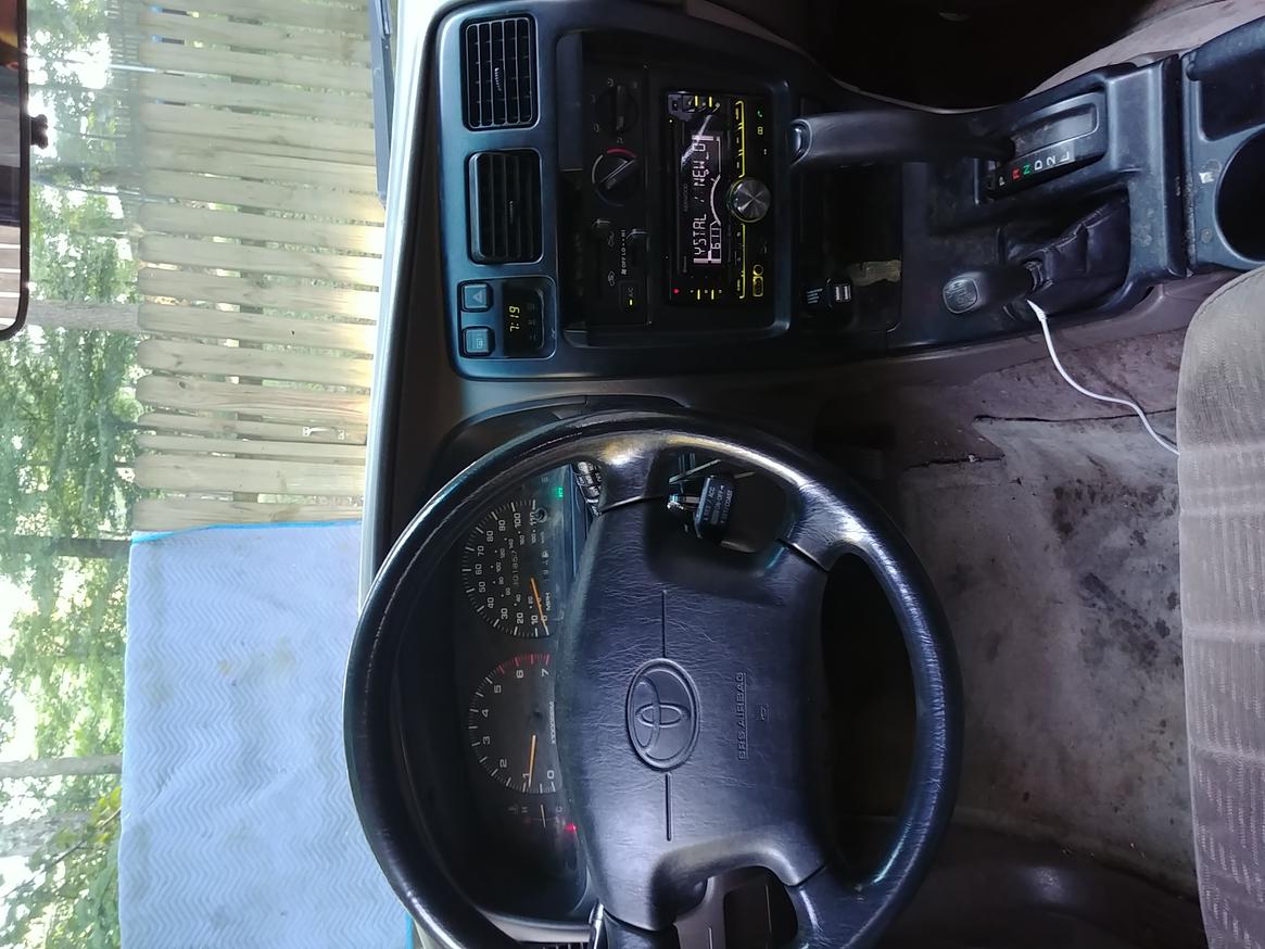

Got the 99-02 console box, dial type HVAC controls out of a 98, Steering wheel and spiral cable from a 99, window master switch from a 99. Looking for some 00-02 front seats, in my 97 SR5

Looks great. I also have a 97. Is there an easy way to just change out the hvac controls to the knobs instead of the sliders in my 97? I hate the sliding knobs, would like the circular controls but don't want to do it if the install is a nightmare. Thanks for any help
It's not terrible, one of the cable has a different end, which is not the end of the world, you will need a wire diagram for a 98, the fan switch and A/C wires/ connectors are the same, as with colors but in different pin locations. So I used a small 3/16 rivet and pulled the pin out, cut it down to fit exactly were i needed it. And then for the wiring I was able to look at diagrams so I could de pin and put wires where they needed to go, I think there was only one wire for the blower that was a different color.

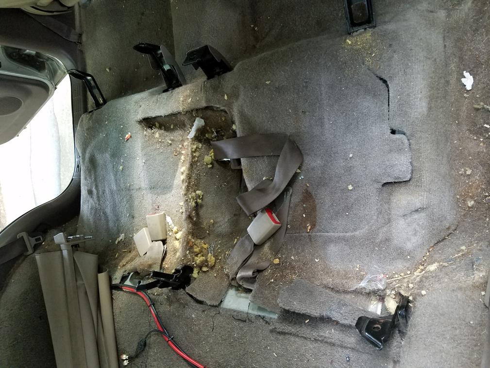

I also just picked up a 1997 as a winter beater and a challenge to keep it running for as long as possible. When I first got it... kids had been riding around in it. I pulled the seats out and found several piles of skittles, french fries, princess Ariel hair scrunchies, spilled milk, enough coffee spills for a latte.
you don't really realize how disgusting things can get until you clean it out.

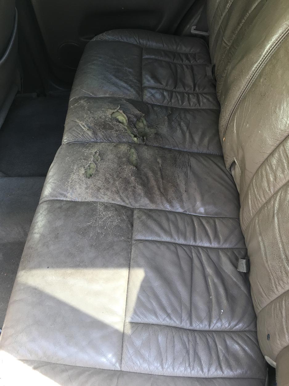

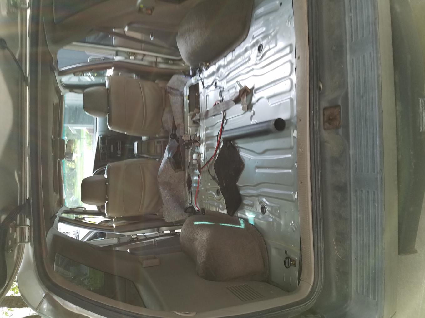

I am now only because the PO had dogs and they SHREDDED the back leather seat. Also the smell of wet dog was so embedded into the material and foam I made sure I had some second hand sr5 seats to swap them out with. Sucks cause I really wanted the heated aspect of it but the trade off was either wet dog smell or suede sr5 seats that just needed a good upholstery cleaning. So off to the curb the leather seats went! I took it all the way down to the floorboards. I still haven't taken any photos of the sr5 seats!
Cheers to keeping these rigs on the road!

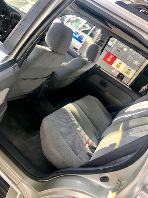

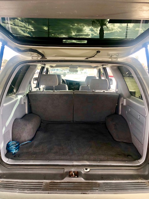

Just picked up my 2000 4WD SR5 sport 3 weeks ago, noticed it has a Rear Diff lock switch which is pretty awesome! Interior is pretty clean and everything suprisingly for its age is fully functional...only thing I added are some new OEM Toyota 4Runner floor mats.
