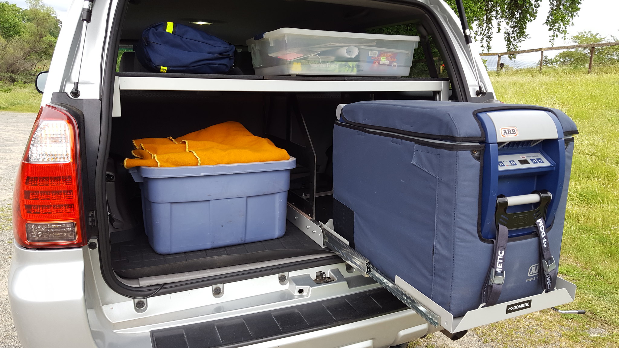

I'm running an ARB fridge on a Dometic slide. I built a rear cargo shelf so the fridge needs to come out in order to be opened. I've run power back to the cargo area from a Blue Sea fuse block but also run the fridge off a small solar battery (55ah AGM) that mounts in a plastic ammo can and is charged by a flexible 100w panel.
Performance wise I'm really happy with the fridge. I only use it to cool, not freeze. On packed weekend or longer trips my entire rear cargo area is jam packed with gear so air circulation isn't great. I've had the fridge run for 3-4 hours at a time and I believe it's as long as it is because the fan is pulling warm air. The internal fridge temp is fine and with solar or 12v plug it does fine.

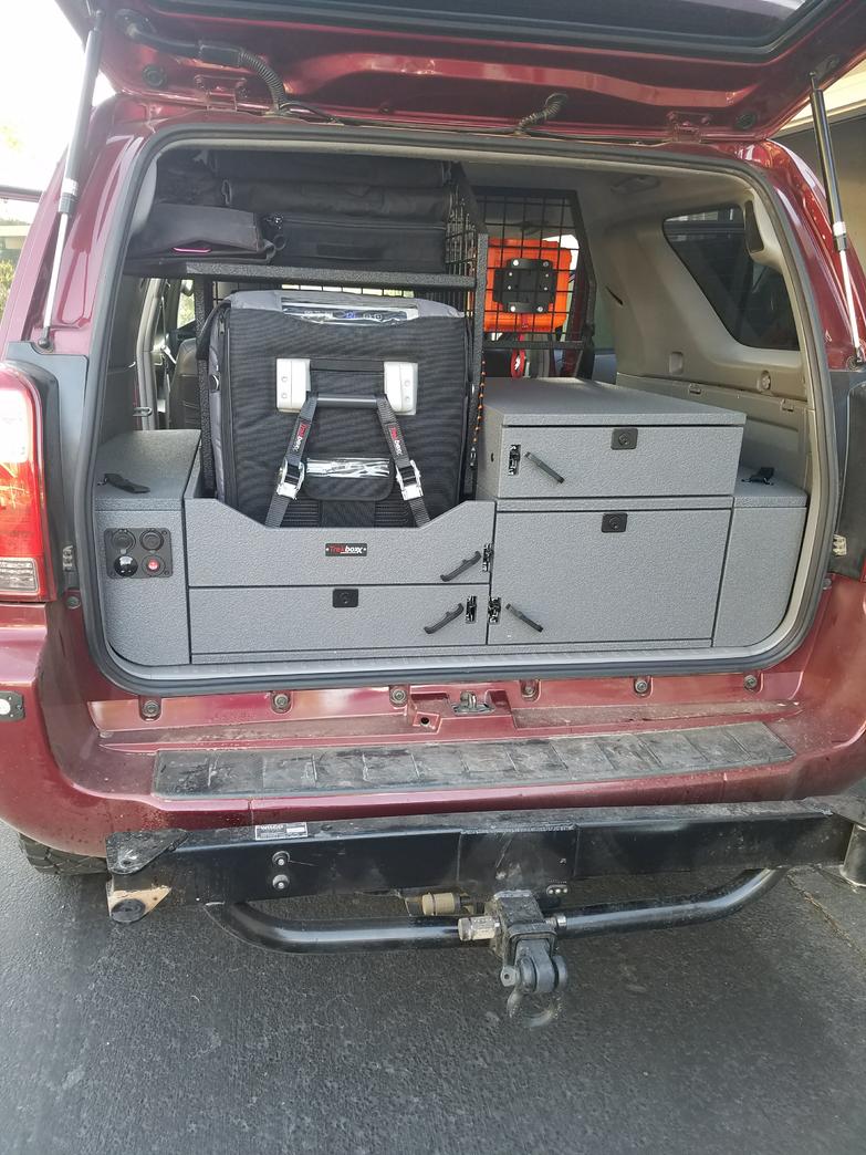

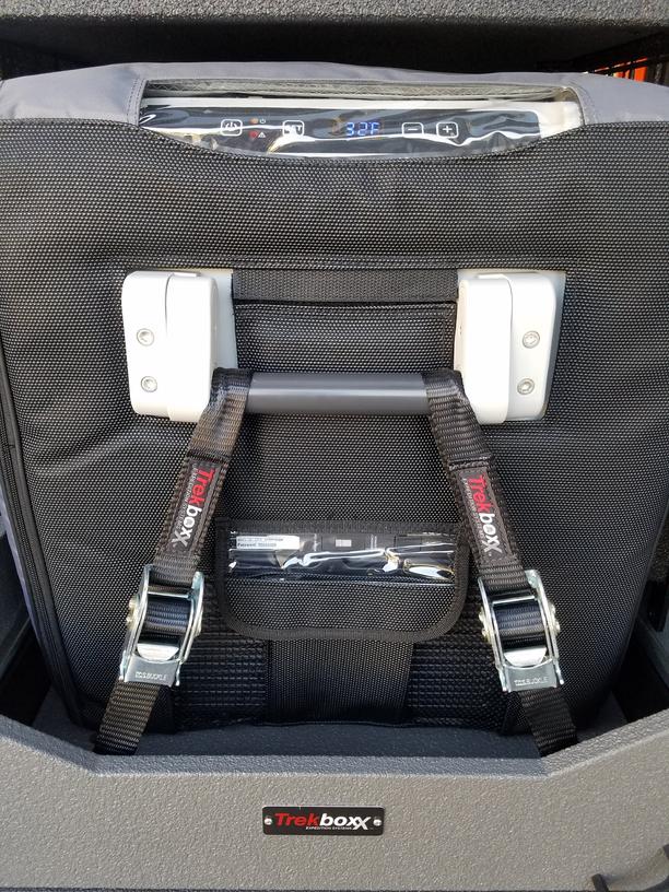

Using a Dometic CFX-50W with cover and love it. I had the Indel B TB51A before and while it was a good fridge it sucked power even with the cover I bought from Metaltech. It's also a lot narrower and taller, while the Dometic is wider and shorter which I prefer as things are easier to pack. Also the Dometic hinge is switchable either way, so it can open left or right. The Indel only opens from the front which is easier if you don't have a slide. I did the hinge mod to the Indel to add hinges on the side and liked it better. Really can't complain about either, but prefer my Dometic after using both. And I'm using a Trekboxx system (4th Gen 4Runner Serial #001) for my slide.

Does the Trekboxx require removal of the rear seats?
It does not. I chose to remove mine so I could have a flat surface to mount my gravel bike and have a lockable compartment for "items" and storage underneath. This system utilizes every inch of usable space and was worth every penny.
