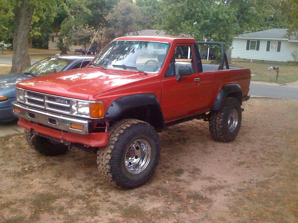

lets see the 85 runner /got any pics?
It was on there when i got it . i keep it for two reasons first if in some case something might be better than nothing ,second it's funny i tell people i recover shopping carts that are stuck in the mud:biggrin2:
i figure it matches the fog lights !! i live in tucson az we have two seasons summer and almost summer . the previous owner liked the way it looked i asked to

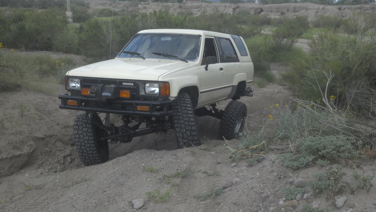

Here's a pic of my Toy
if your thrifty you can find a early - mid 90 runner with 4.88's stock i don't know if the front will be a straight swap but do some research on it
most new gears are all the same genuine gear g-2 are normal $150 each plus $200ish labor if they are bench built (you remove the 3rds yourself ) and other parts Bearings/seals,
nice runner i like the truxxus tires
